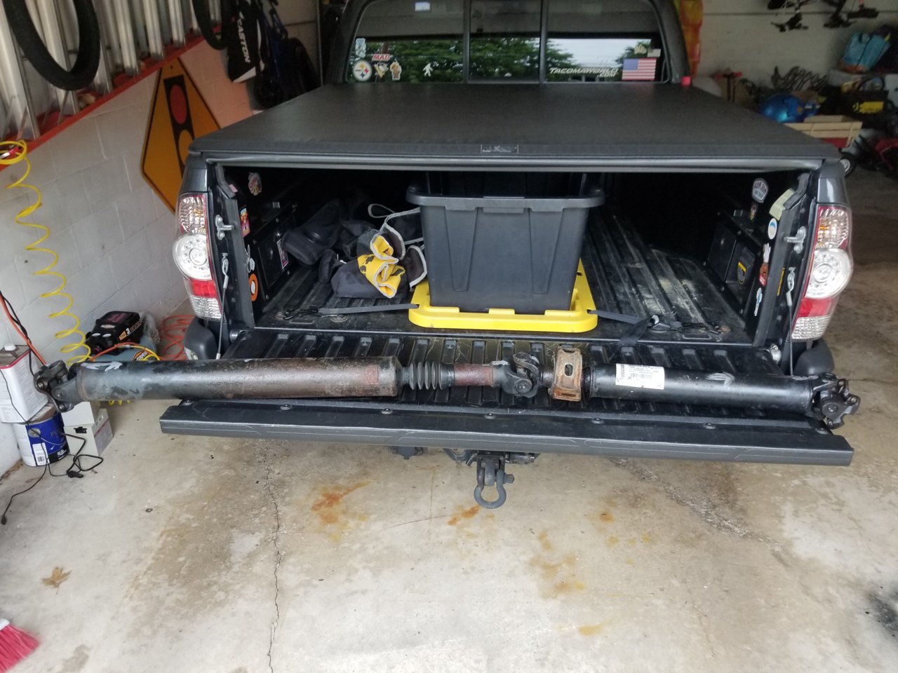

    Old thread revival!
    It was the U joints just to confirm. I finally got around to changing them last month. After I posted this I greased the shit out of them and squealing went away. I figured I gave myself a little time before I had to deal. Well last month the u joint shit hit the fan. I was getting pretty bad vibrations and knew it was time.
    I replaced all 3 u joints and the carrier bearing. The carrier bearing was the easiest part, which I thought would be the hardest. I did not enjoy this job. LOL. And don't want to do it again anytime soon. I had to buy a 4th u joint when one of those stupid needle bearings slipped out of place and after pressing the cap on and realizing it's not going tight to the joint, I knew exactly what happened. Then came the extremely difficult job of getting it back out because both caps installed and not enough room to come back out... :ballchain: :bananadead:
    Anyway, I'm glad it's done with and glad I did it myself. Sorry , but only pic I took was the drive shaft out... and my baby just turned over to 100,000 a few weeks ago! She's still so young!
