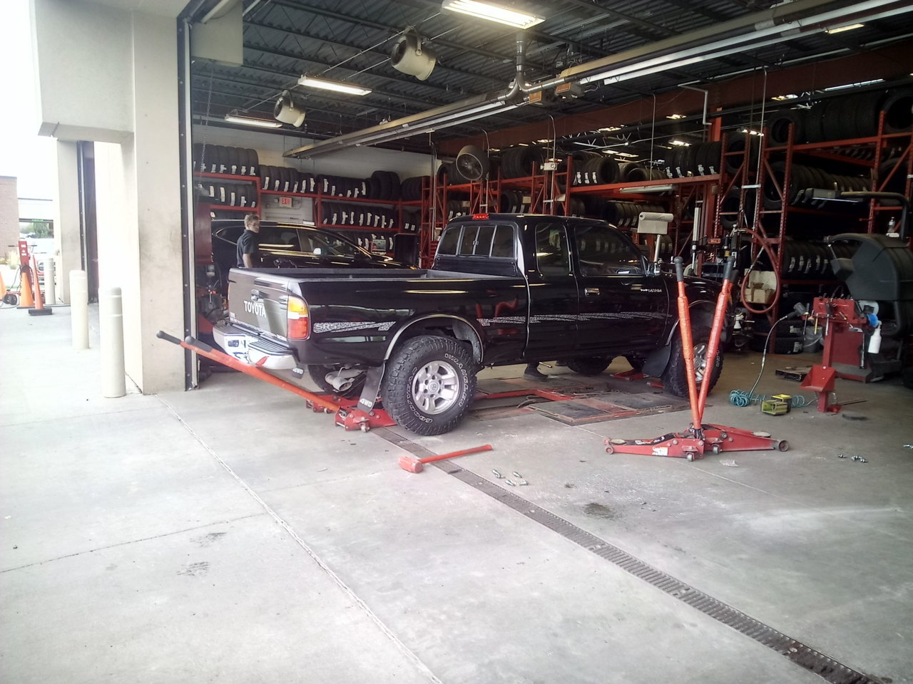

    97 reg cab, 2.7, 4x4, AT tires, 190k. Steering was fine until i got my tires rotated while I was having a tire patched. Then it was a handful to keep between the lines, I got stopped twice in two weeks by a state trooper thinkin I was drunk. Anyways i got an alignment and the shop had to do my tire rods in the process becuase they were too rusty. Now if I let go of the wheel on a perfect section of highway, it'll go straight. If I let go on anything less than perfect, and especially with little bumps, the steering wheel jerks left and right. Anybody help is appreciated.
