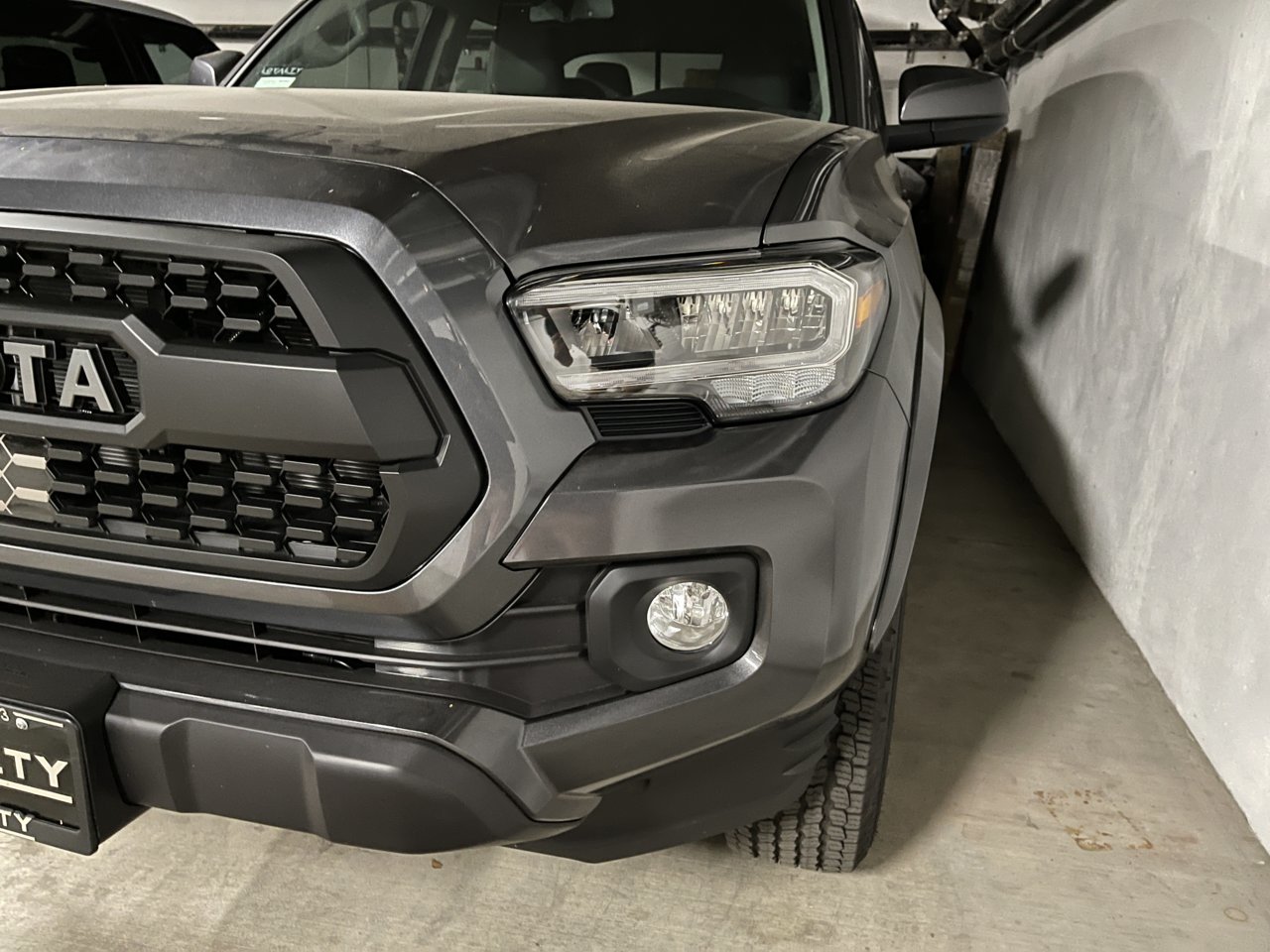

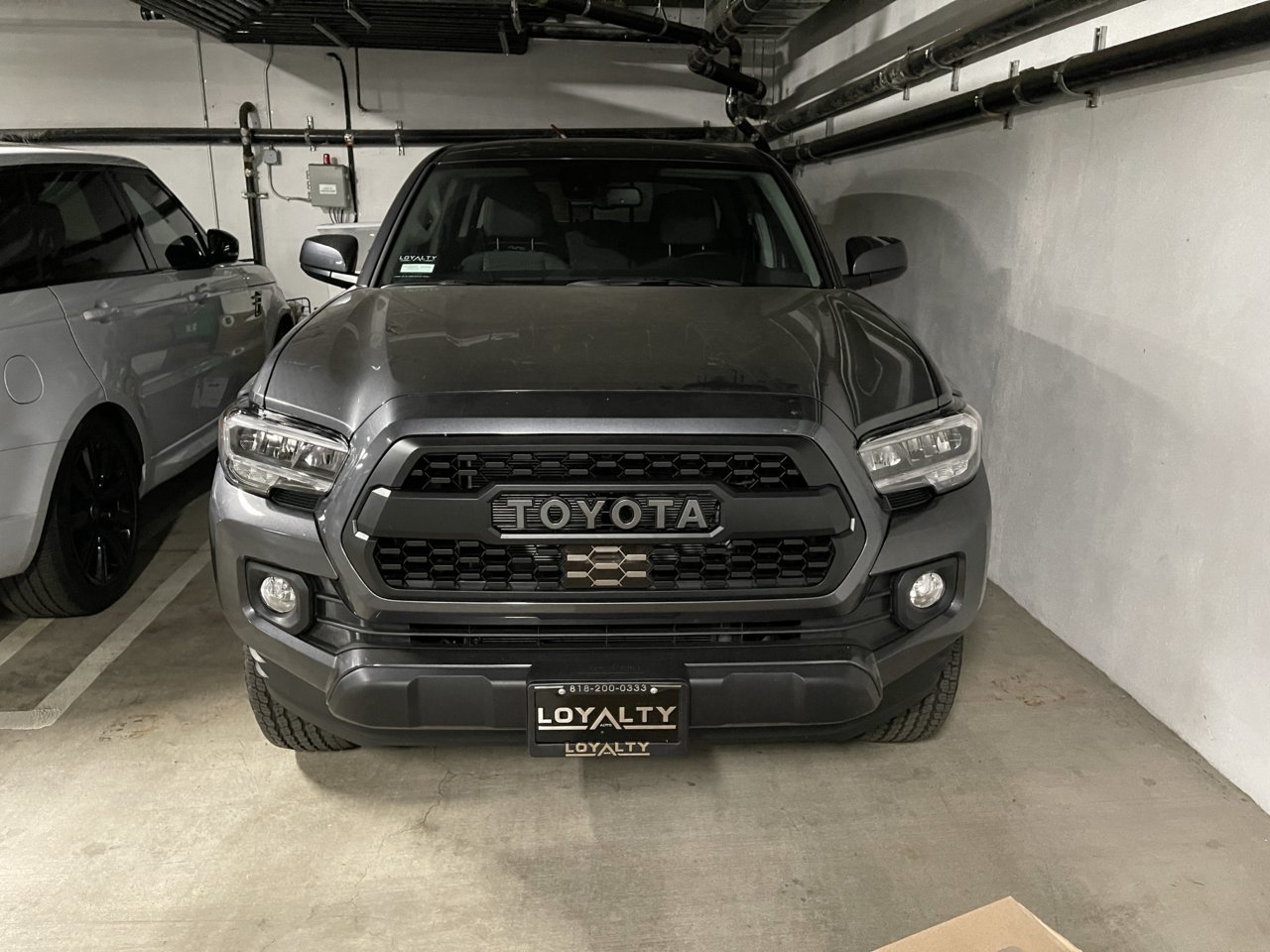

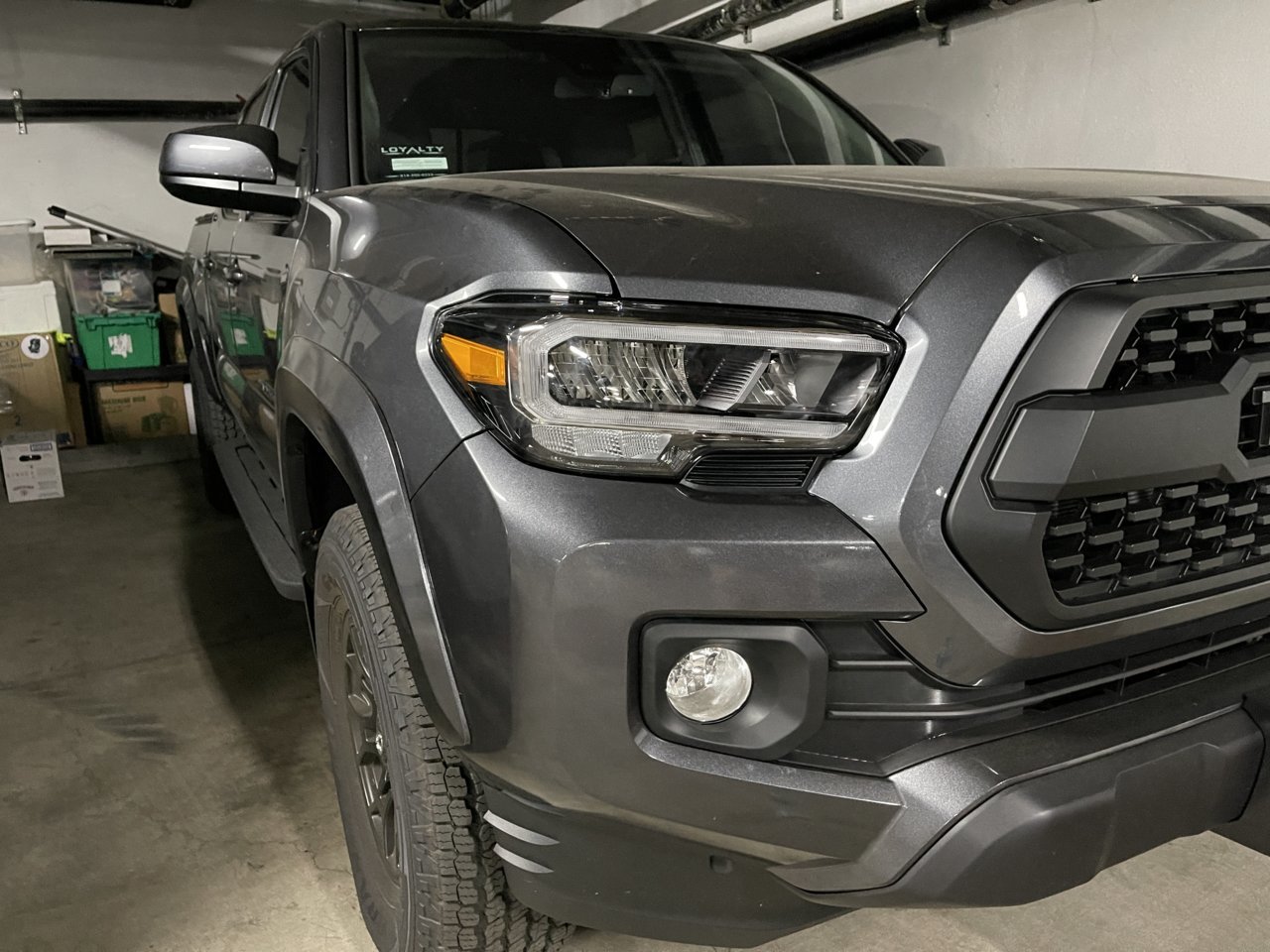

    So Finally had some time this weekend, light work with one exception, the high beam for some reason don't work, they only work if I pull the level manually, if i push the level nothing happen, that's the only problem i have, unless i have to set up anything, I don't know. Everything else works properly.

    Hi,
    I was looking into the swap as well. I don’t know much about the electrical stuff. I did see Morimoto has some sort of conversion harness. Is this similar or for a totally different style lamp?

    These are for factory toyota led headlights.

    That is very odd. The High beam connections are really straight forward, just a simple jumper really, no "conversion" happening on them. If you have your old headlights (or really, just the bulb), pull the high beam socket from the adapter and test it. Keep in mind, when the high beam is unplugged from my harness, nothing on the LED headlight will work as the whole thing grounds through that connection. But I don't know what would cause the issue besides an issue with the stalk itself? Keep me posted as to what you find though please.
    Yeah, as said above, these are for running the OEM LED headlights on the SR/SR5 models.

    I know, it is super odd, like i said everything works fine except for that. So, on the steering light switch if i pull it back to get the high beams manually they will turn on no problem so is not the bulb. When i turn the fully on the switch and push it to get the high beams nothing happen. Like i said pretty weird what is happening. I will keep checking everything.
