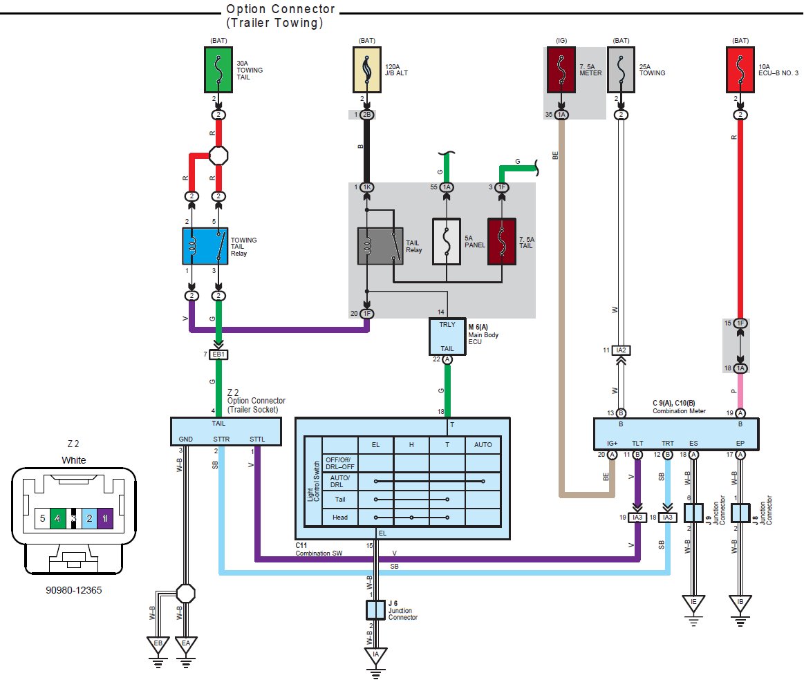

    Would like to confirm that connector Z2 (Optional connector Trailer Towing) is indeed wired. It should be behind connector IA3 (blue) at the driver's kick panel.
    Red circle is the suspect.
    Thanks!
    The picture I show is not mine, and the person who sent it didn't/couldn't/wouldn't dig the connector to show if indeed it was the correct one.
    Do you have a non-tow harness SR or SR5?
