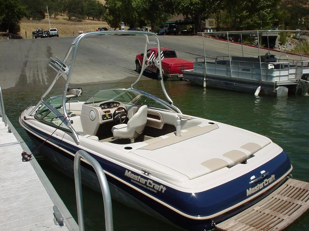

    #1 Just curious. If your stuck in the mud how does does one go forward or backward in an S motion?
    I would like to get the TRD OFFROAD but I might have to buy used, and may only find TRD SPORT. Question I have here is: I prolly won't be doin any off road. My Main points are Towing, (Not getting stuck at the bottom of the ramp)+( I won't ever to be able to load my boat from the shore or from the dirt because of the HEFT...weight) so although the locker is great would it help me at the ramp?
    I mean if the rear wheels start to slide I just use 4x4 Lo right?
    This ramp is an EASy ramp. the others are llike 150' down [\ <--like that...lol
