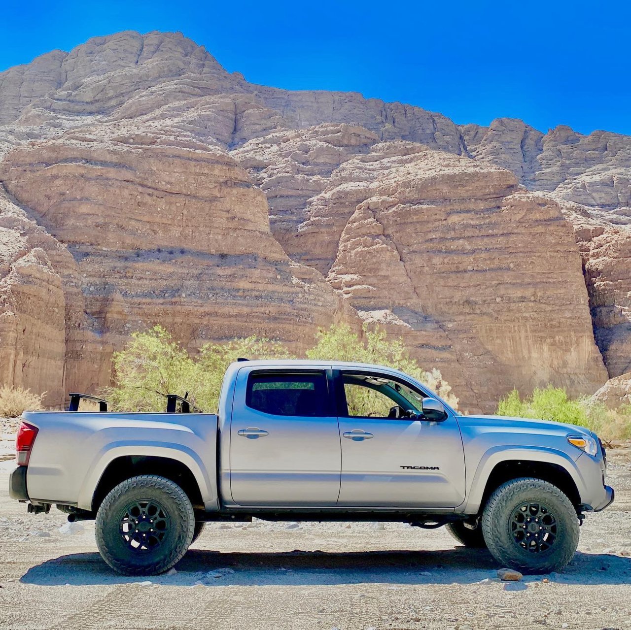

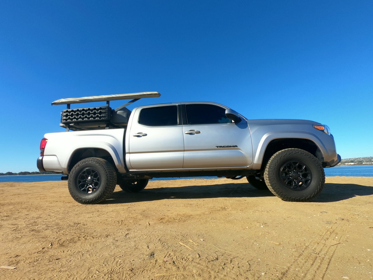

    Same truck but 2019 - Bilstein adjustable height 5100's all around - 1" front lift Rear- Icon Progressive AAL (Add a Leaf) 1.5" to 2" of lift in the rear. I think they can go up to 2.5" lift though. I have a roof top tent I take on and off... it sits level with the tent and gear on it. 265/75/16 Stock wheels with spacers for a more aggressive stance. Truck takes me basically anywhere I want to go. Wish I had a rear locker though just to be safe. Check out my Youtube channel for some inspiration. https://www.youtube.com/channel/UCrPftCkIH4JjcAAQwcn6Hsg
    Beach taco2.jpg take .
