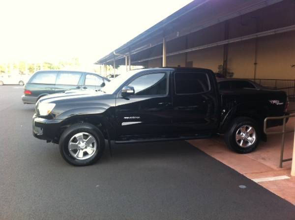

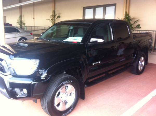

    The day I picked um up from Servco Toyota!!
    2012 Tacoma Trd Sport Pkg

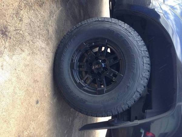

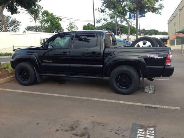

    Next came my Rim and Tired

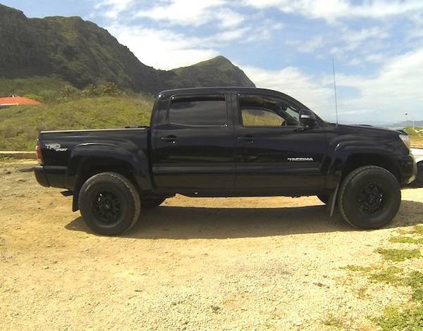

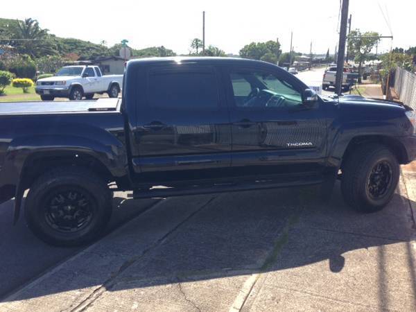

    -Mickey Thomspon Sidebiters 16"
    -265/75/16 Bridgestone Revo 2's
    A little bit of rubbing on front mudflap so took that off and it was all good!

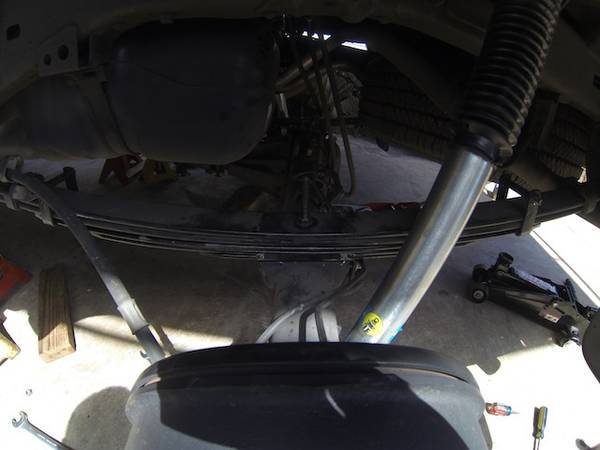

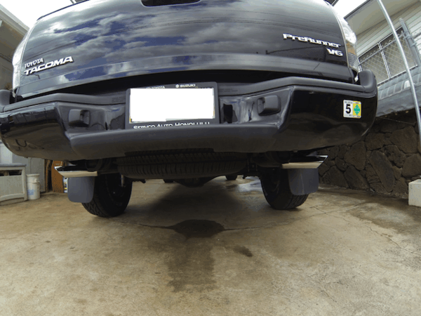

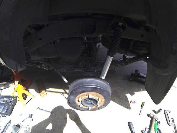

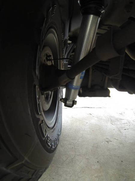

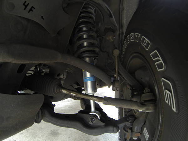

    Next came my 5100's all around set at 1.75 with stock coils
    After installed had bro lean (Uneven Road so pretty MAJOR)
    Fixed it with a Wheeler 3 pack and even better ride

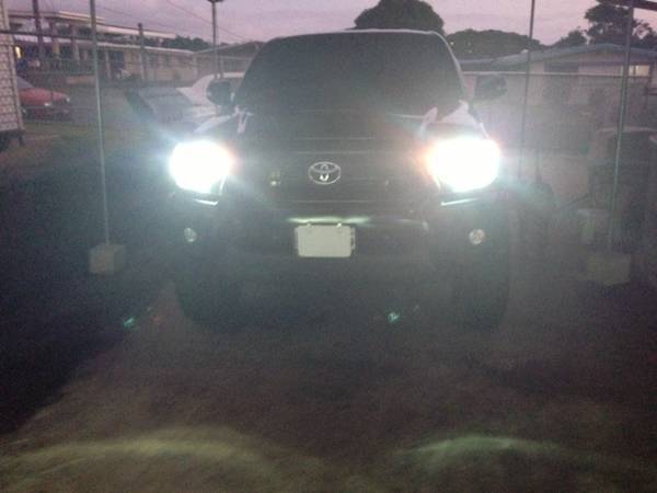

    6k Hi/Lo H.I.D

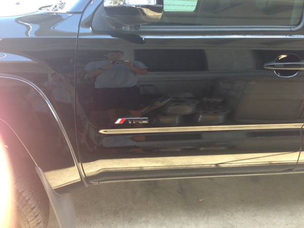

    TRD badge from eBay

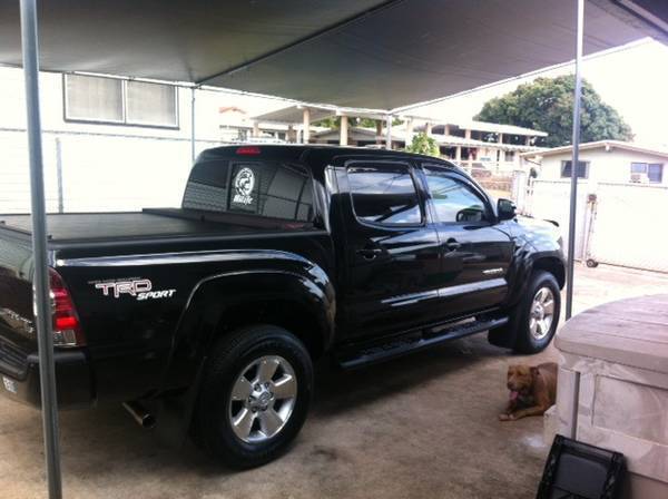

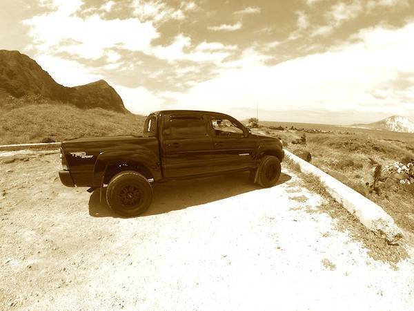

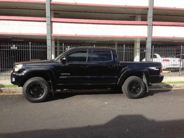

    How it looks today

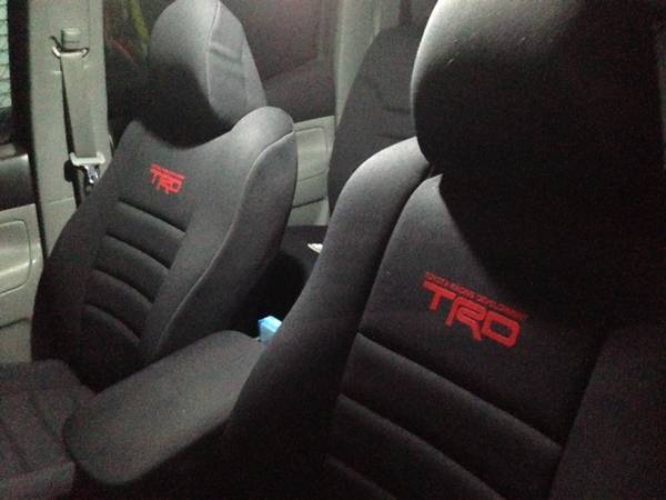

    Interior
    - Wet Okole Front and Back
    - L.E.D Dome and Map lights
    - Rubber Tacoma Floor mats

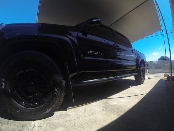

    Exterior
    - De-badged
    - TRD Flat Black Emblems
    - Tint 35% in the Front and 5% in the back
    - Retractable bed cover
    - Weather-Tech Rain Guards
    - Bug Deflector
    - OEM Tube step (sold)
    - Flowmaster Super 44
    Suspensions
    - 5100's all around set at 1.75
    - Wheelers 3-pack AAL
    - Stock coils
    Wheels
    - 16" Mickey Thompson Sidebiters
    - Bridgestone Revo 2's 265/75/16
