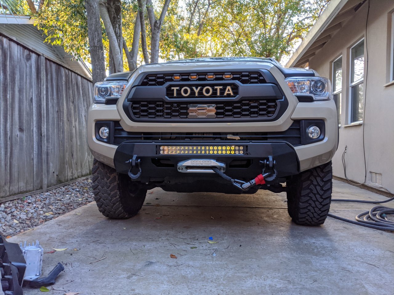

    Have it, it fits.
    Tight squeeze for sure, and you need to trim the radiator support bracket, and a tiny bit off the inside of the lower grill (like 1cm for the portion of the winch) but it fits.
    I did not relocate the control box.
