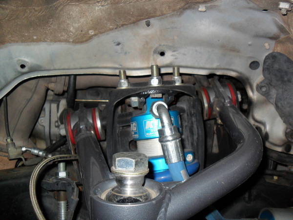

    For the guys who are in the salt belt DO NOT buy TC UCA's with chrome uni-balls. They can pit very quickly even if they are properly maintained. Camburg, All Pro, and DSMS's UCA's come with stainless uniballs (I know for a fact that DSMS uses the same exact stainless steel uniballs I have listed below in their production line).
    If your going TC then be sure to get them with a stainless uni-ball. They will last much longer without pitting and should be a small up-charge.
    Here are mine after less then 6 months.

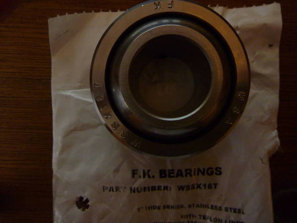

    For the guys who need replacement uni-balls like I do:
    Stainless uni-ball's are manufactured by F.K. Bearings. Part # wssx16t.
    I bought these direct through TC, but they can be found on the web for similar pricing.

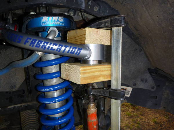

    putting the new ones in without the proper tools
    hollowed out the bottom piece of wood so the uniball wasn't touching in order to suck the ball flush.
    then used the old bolt to suck it the additional 1/4" so the spring clip could be installed
    torque nut to to 100 ft/lbs

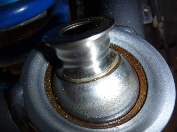

    noob question here,
    what does pitting mean?

    A few bolts are different.
    Pitting is caused from the salt. You can see in this pic the little indentions, or "pitting" rather, that the salt has caused on the round uni-ball.
