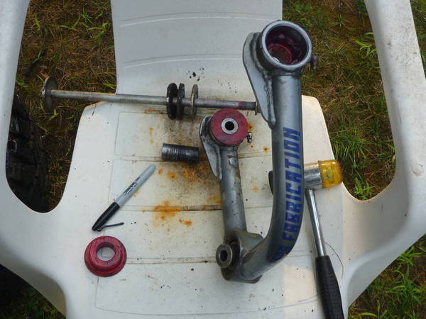

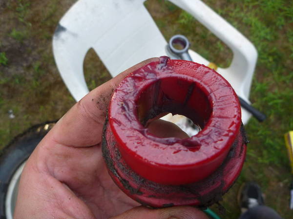

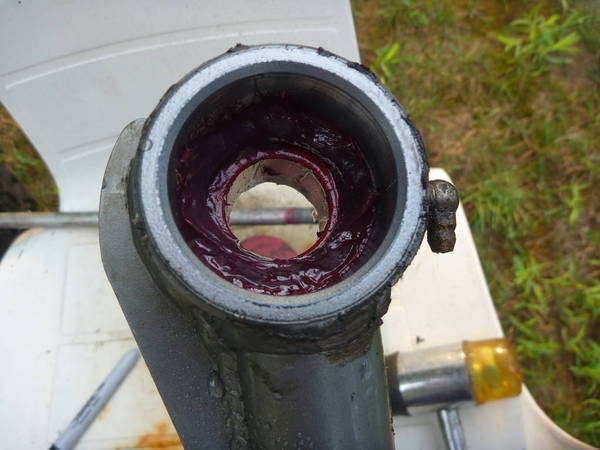

    So Ive had the stainless balls in for 6 months now and they are great. I recently took out my UCA's for a good cleaning of the bushings and surprisingly the bushings showed very little wear for having almost 30k on them now. I have used Mobil-1 synthetic grease on them from day 1 and all parts were lubed with it before installation. The balls still look great and have zero play in them. I have used Tri-Lube from Wheelers on them since the beginning and that stuff is great for wet muddy areas. The hard waxy surface keeps the crap out very nicely.

    When I took my UCAs apart I couldn't hit the uniball out? I used a mallet hitting downward, then upward, no budge. Any tips? I have to eventually take them out when my stainless uniballs come in.

    Did you remove the spring clip? The get pressed out from the top to the bottom then pressed in from the bottom to the top.
    Here's how I did it.
    http://www.tacomaworld.com/forum/su...el-uni-ball-tc-uca-05-tacoma.html#post2804791
    Try removing them while still attached to the UCA mounts. I just disconnected my spindle and hit mine out with a mattet, but if you need to you could press them out with washers and all-thread or press them out with a BJ press with the right adapters.

    Yeah I took out the spring clip. I think I'll just use a press, no biggie. Thanks
