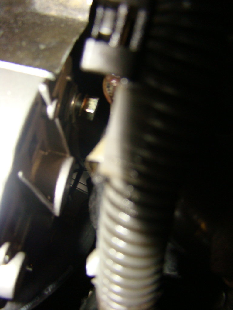

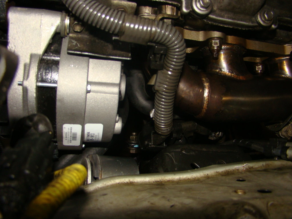

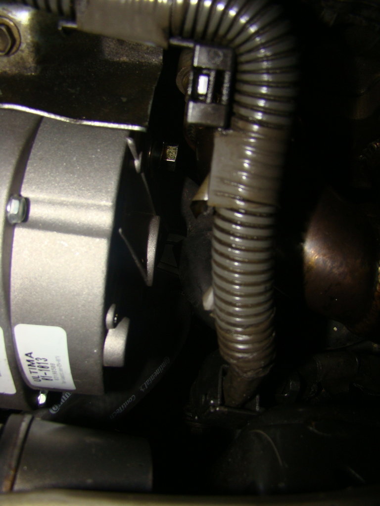

    @Rons01TRD
    Got an issue with the rear post on the alternator. Its about 1in from the exhaust:
    These pics aren't going to help much but should give a good idea of how close it is.

    You need a 90° wire harness.

    The harness is good. It goes out 90* and I wrapped it down around the bottom. This is the post for the 4ga wire to the battery.

    I'm still not sure what to do with that wire. If I can find some silicon 4ga wire, that would be great but for now, I'm thinking of insulating with this:
    http://www.amazon.com/Heatshield-Pr...rue&ref_=ox_sc_act_title_2&smid=ATVPDKIKX0DER
    Wrapped with this:
    http://www.amazon.com/Heatshield-Pr...rue&ref_=ox_sc_act_title_3&smid=ATVPDKIKX0DER
    Its still pretty damn close to the exhaust and I don't know how well that will work. Exhaust temps (from another turbo build) should be around 1500F so radiant heat I'm guessing around 800F at the max?

    @Rons01TRD fixed the alternator issue. Pulled the rear/stator off and rotated it and put It back on in a better position so that the rear post is well away from the headers.
