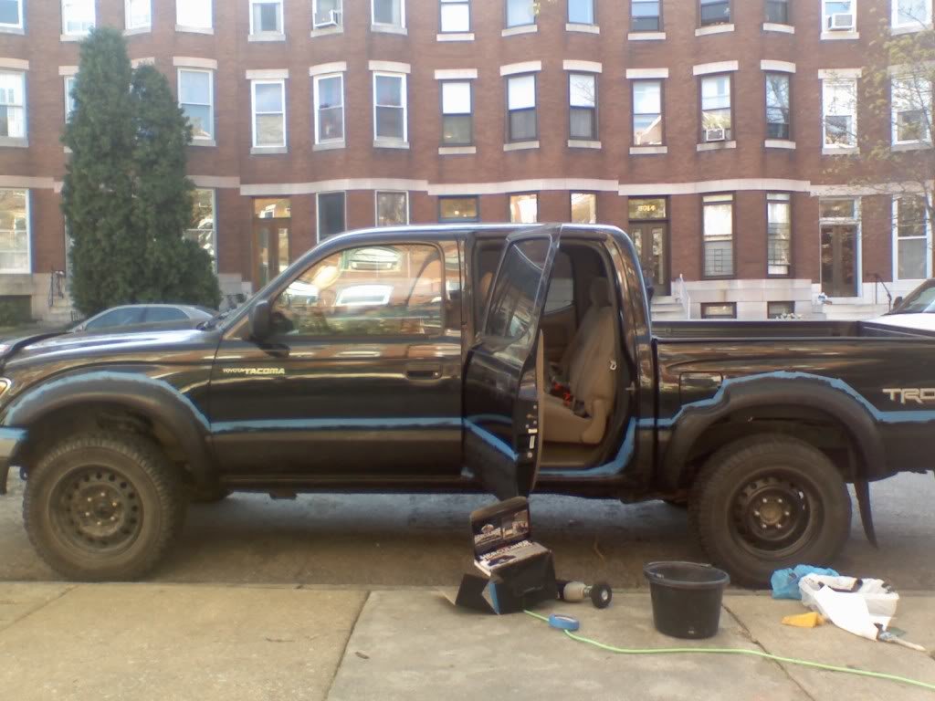

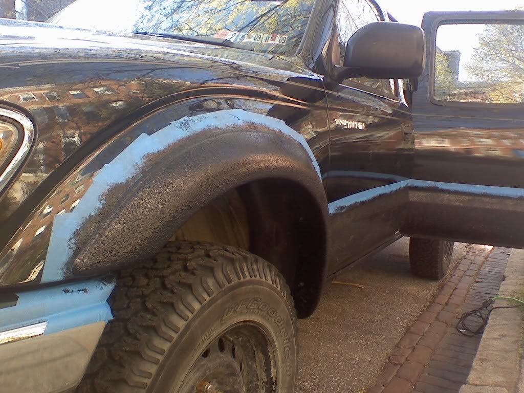

    figured i'd make a separate post for this...
    started herculining yesterday... i really like how it is turning out. 1 coat on 2 more (at least) to go on this side. i think the herculiner dries a little glossy so i am contemplating painting it flat or satin black after i'm done

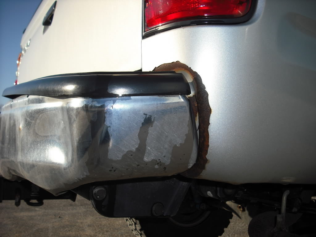

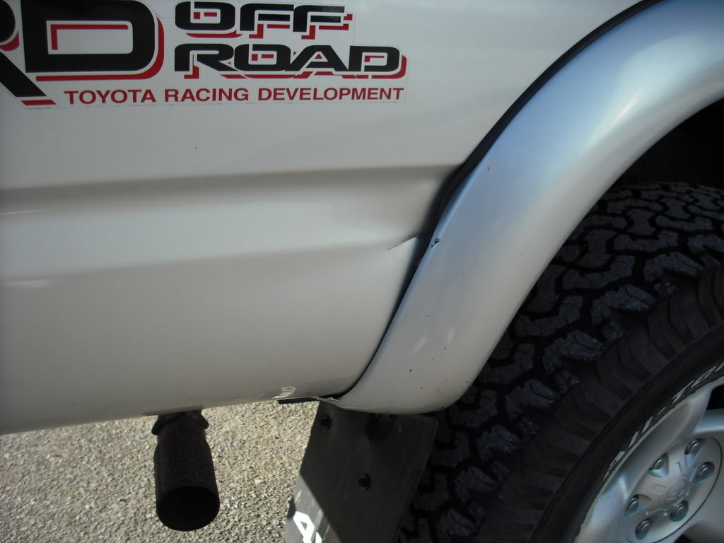

    The rear bumper of my truck was backed into a pole by the previous owner and kinked the lower rear quarter on the passenger side. I checked on having it fixed, and got quotes for almost $600 to fix the body damage and repaint the rear quarter. I had been thinking about straightening out the damage myself and doing the body filler (I can do that, just not a pro at painting) and either doing the Herculiner or something similar myself to the quarters. I'll probably do all the prep work and then see how much it would cost to just have the rear quarters sprayed with Line-X.
    I've got some pics of the damaged area that I'm talking about so you can see. I just want to fix that damaged part, but spray everything below the body line with Line-X or a do-it-yourself bedliner kit. That way I don't have to repaint the entire side of the truck, and I think it would just look good.
    I'm thinking about spraying below the bottom line behind the rear tires on both sides of the truck. What do you think?

    i sat their for 5 min before i could start grinding that paint off... it was tough
    but yeah several layers of herculiner definately covers up minor imperfections and black on your white truck would look sweet... but you would have to get every bit of that rust off to avoid problems later.

    i did my rockers with herculiner, well..i did one side so far. it's holding up pretty well. and just so you kno flat black spray paint sticks to that stuff great, thats what i did to mine. what'd you do to prep the fender flares? thats gonna be my next thing to do.

    i scratched up the flares with the grinder same as body.

    ok, so i just herculined my flares yesterday. they look really good, but i taped off the seal so that only the plastic got herculined. It really does dry glossy, VERY glossy. is it easy to paint the liner?

    i started removing the tape yesterday... i let the liner dry too much first and now i have to razorblade it to get the tape off
