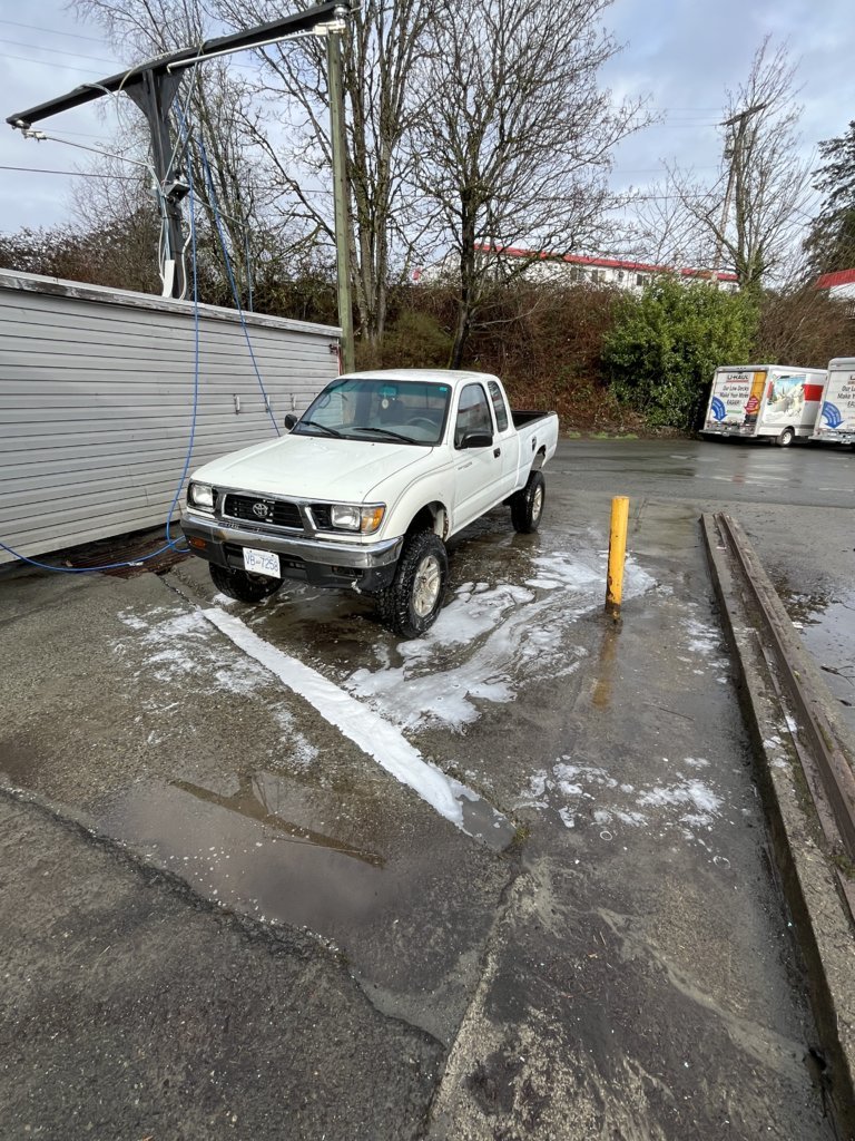

  15. Mar 13, 2025 at 12:11 AM
    RichBcTacoma
    RichBcTacoma [OP] Member
    Mar 9, 2025
    #467405
    21
    Rich
    1997 Tacoma Extended cab 2.7L
    Long list
    Cab swap successful! for the most part lol
