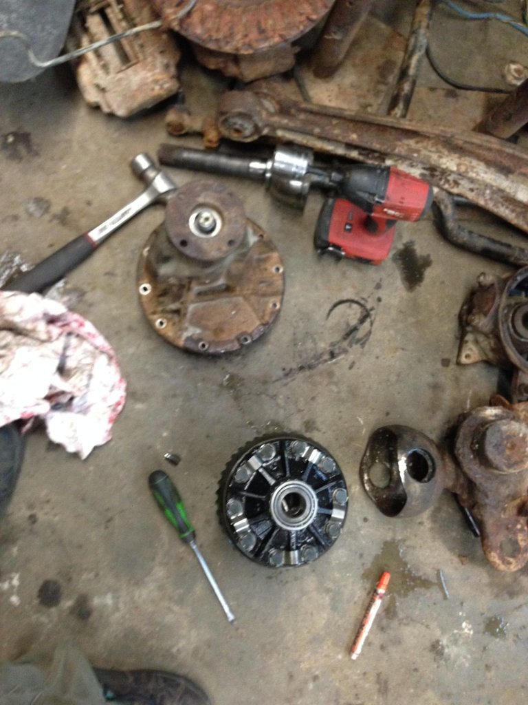

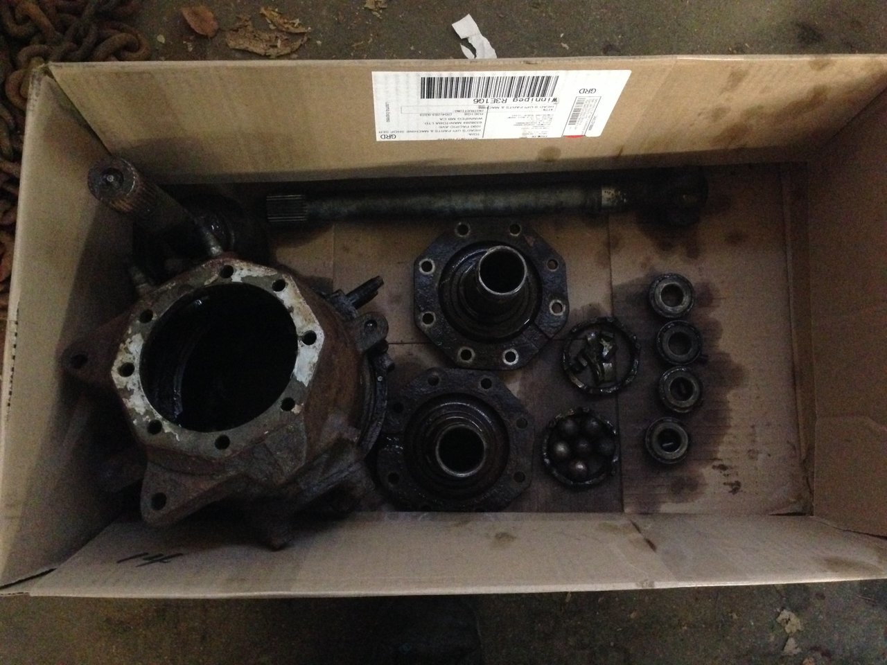

    Today, i cleaned all the grease and oil off all of the inner workings of the diff
    Also took the third apart to replace all bearings, yes Nwi it is an 8"

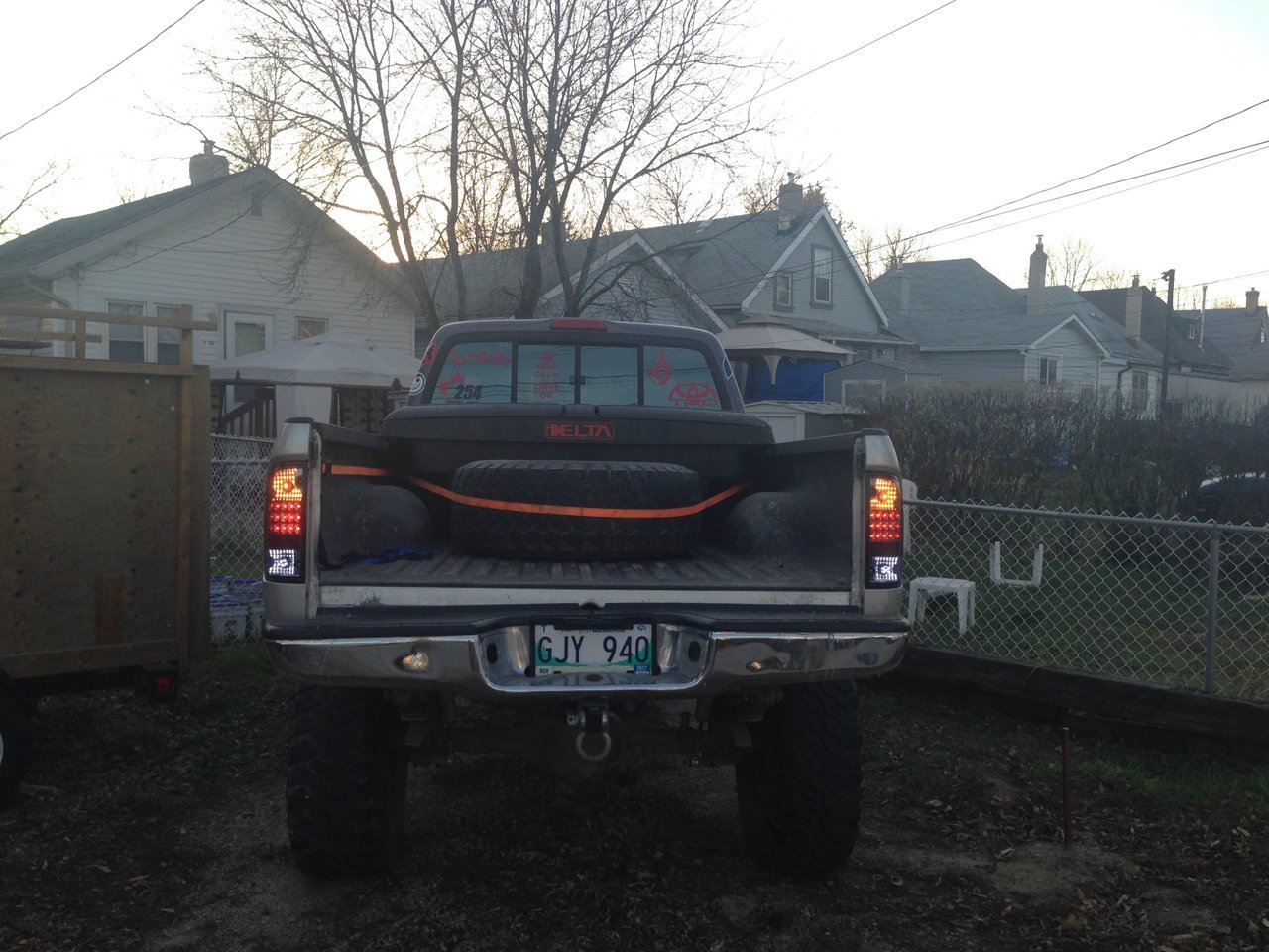

    And installed my new tail lights
    Tomorrow we are ordering all necessary parts to rebuild the diff, also will be getting new bearings locally. The only downside to doing this project my self with help from him, at least for now until it comes time to put the diff under the truck is that my truck comes second to actual work. But it keeps cost down and I'm okay with that.

    Pulled the panties off the wallet today. Ordered a gear driven marlin with 4.7's, longfield chromos, bearing kits for both the housing and the third, and painted the birfield housings and steer arms. Rear will be swapped in as well, because I've already paid for it, and the offset isn't going to cause problems. Budget surpassed. Surprise surprise :p
