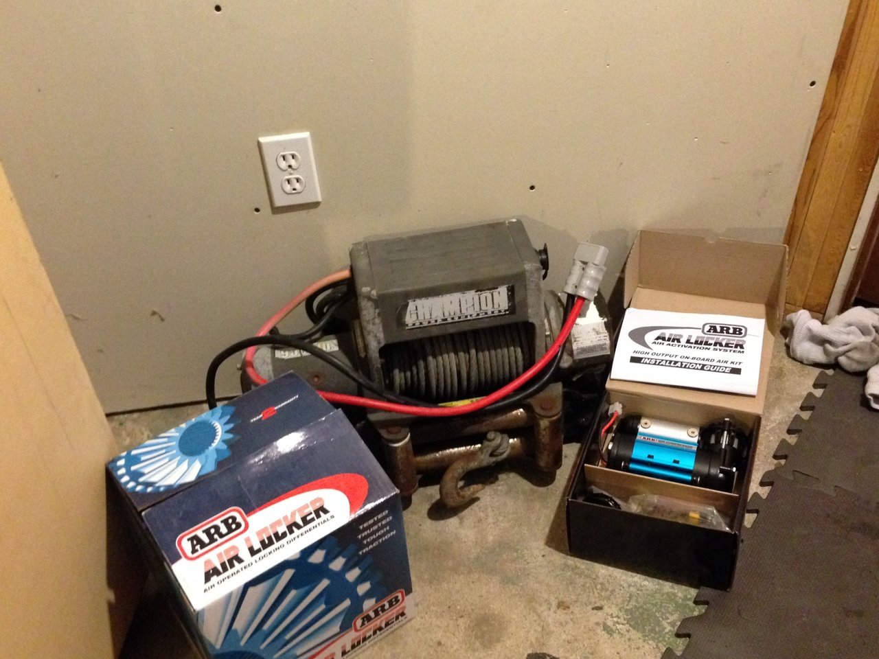

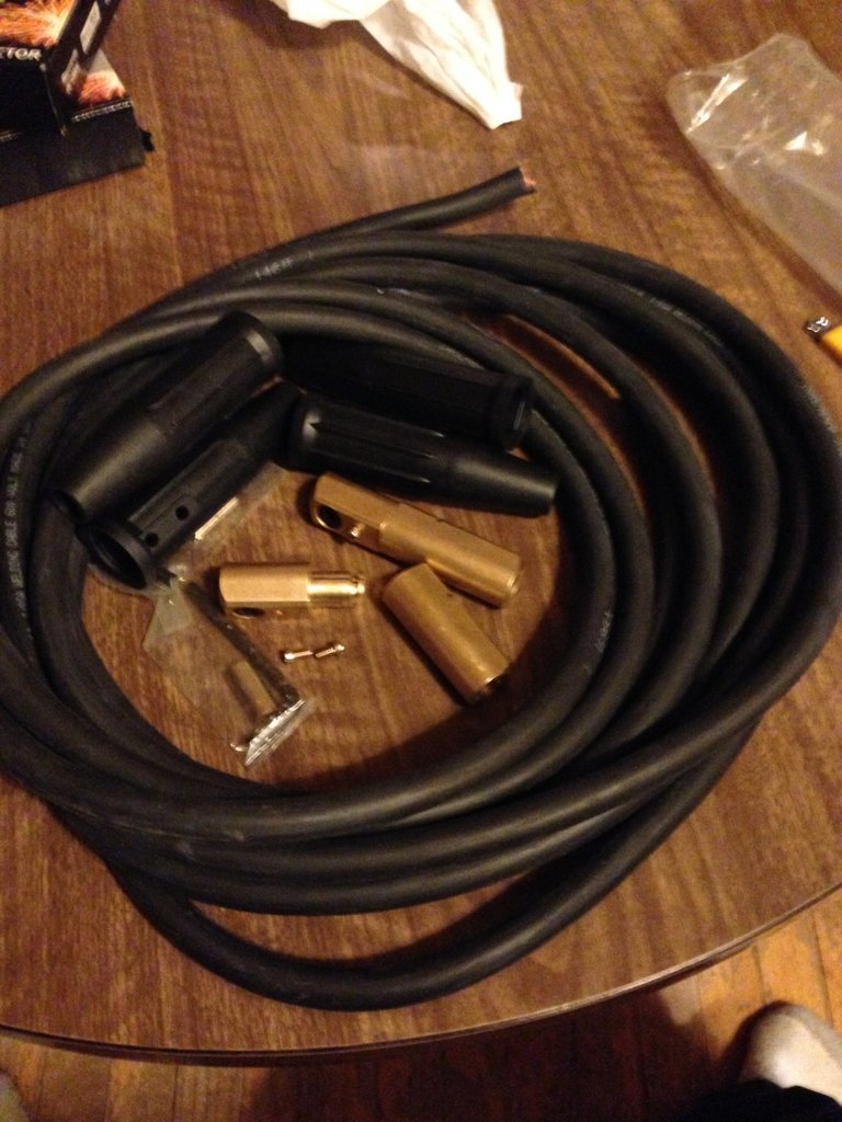

    The pile so far:D
    This is how I will be running power to the rear winch and have it still be removable. 1/O power cable running to the back, and ground to the frame with these welding cable connectors. battery ground to frame as well, and a splitter right off the battery so both winches can be used.

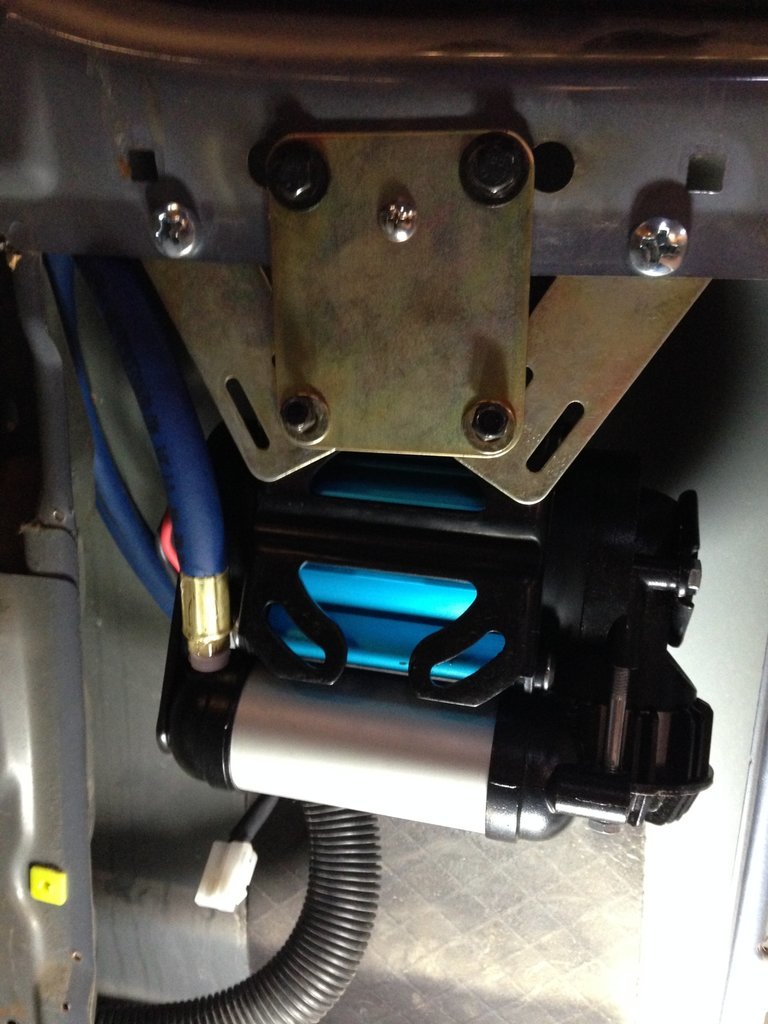

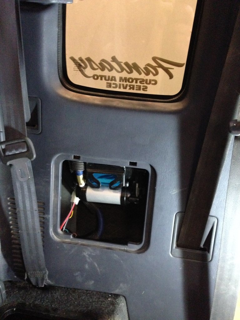

    Today, I installed my ARB compressor. Prior to this, I had an ebay special, which worked but not quite as well as i would've liked.

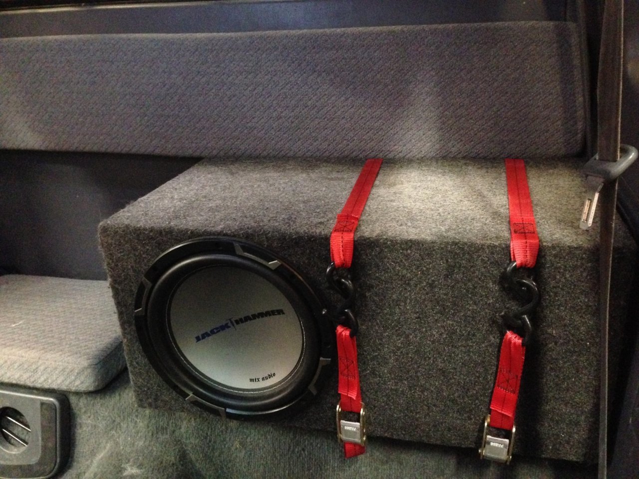

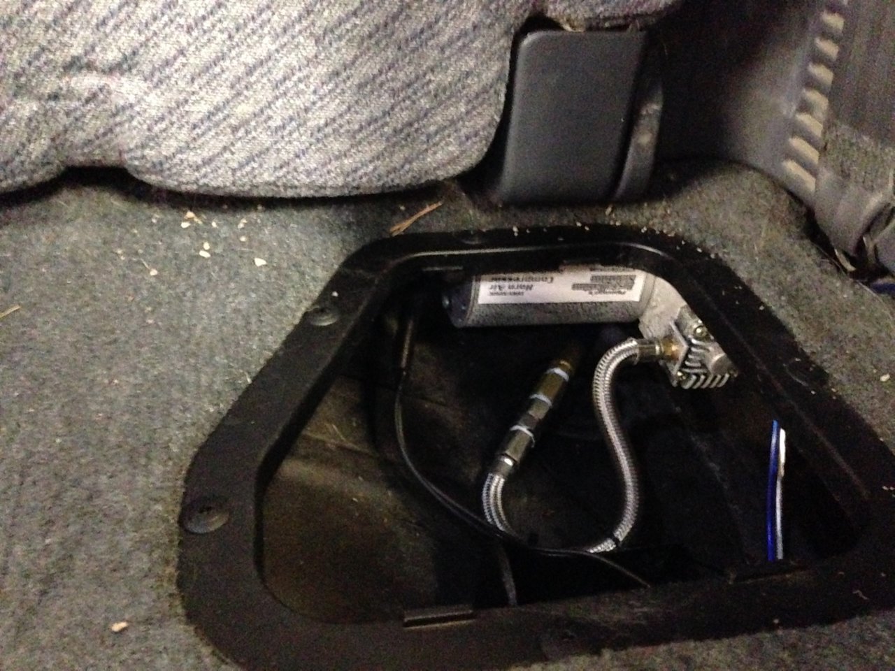

    To start, this is where the old one was:

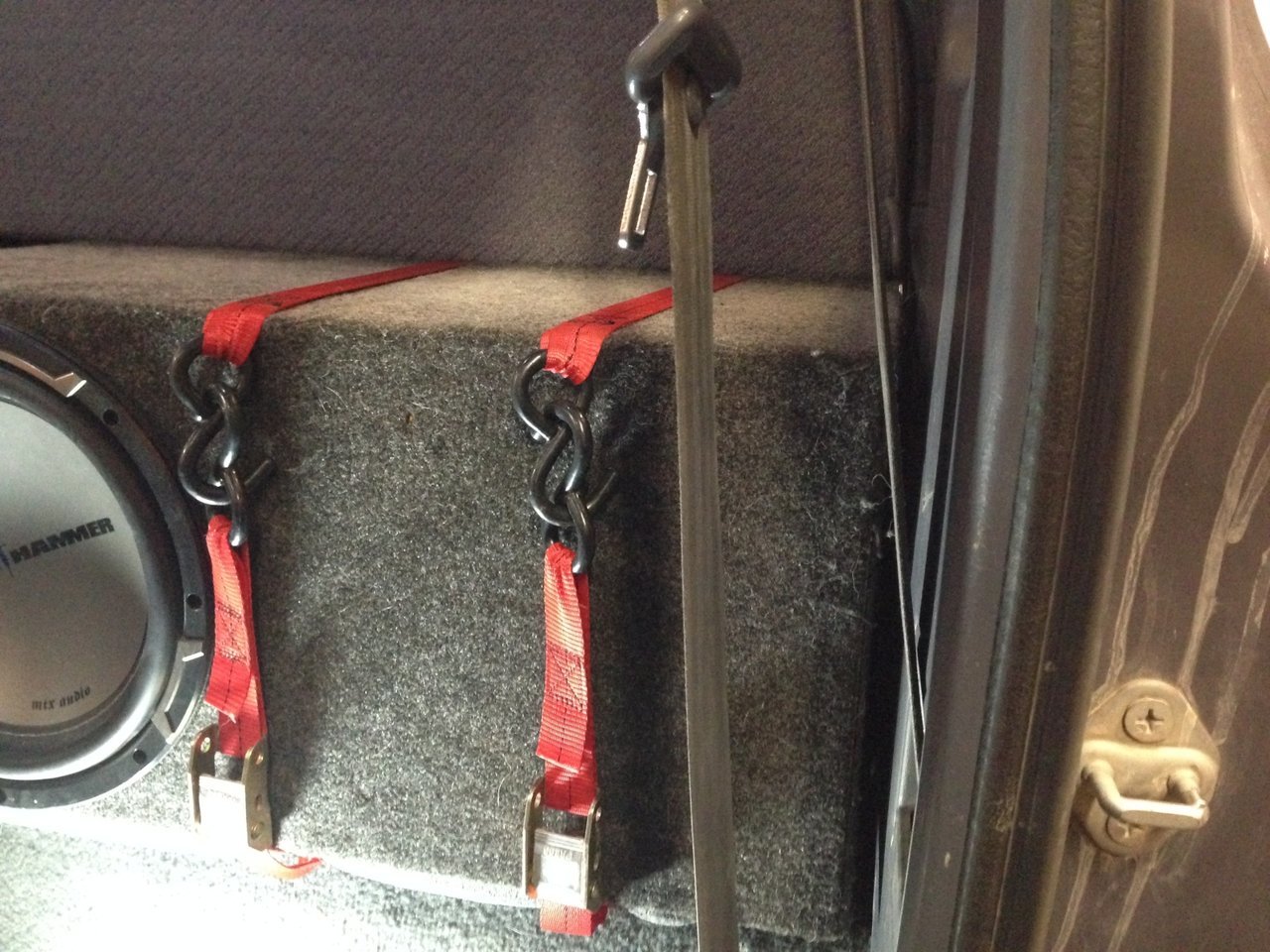

    Under the driver side rear seat, which has my sub on top of it

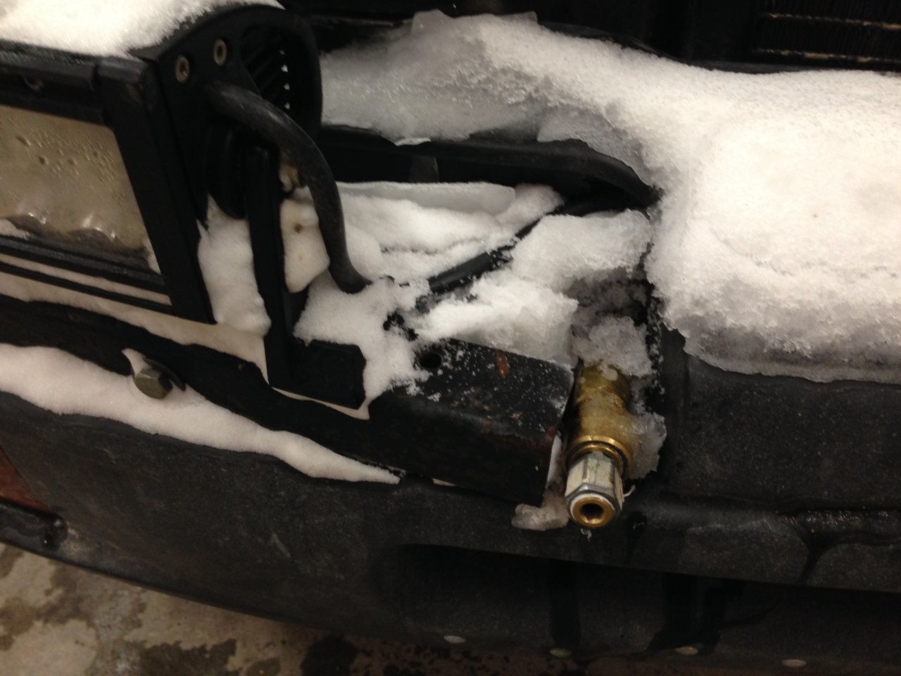

    The ebay special came atop this 1.5 gallon tank, which i removed and stuffed under the hood.
    The air line leading to the tank comes out the front bumper by one of my led bars

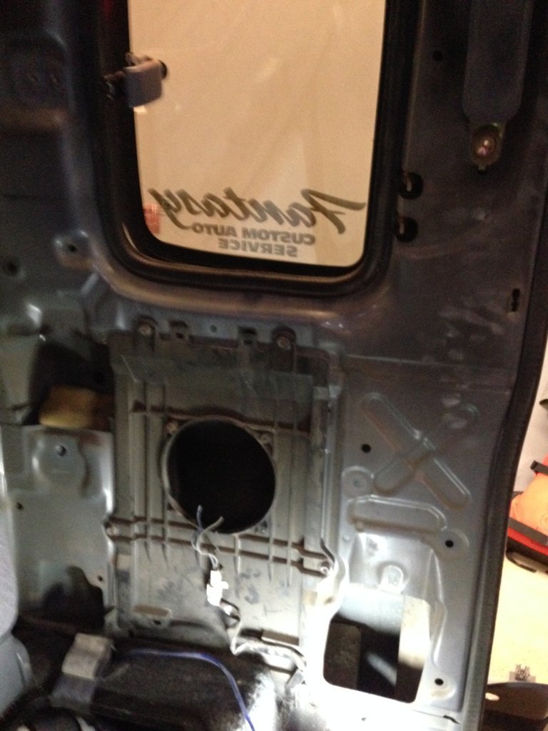

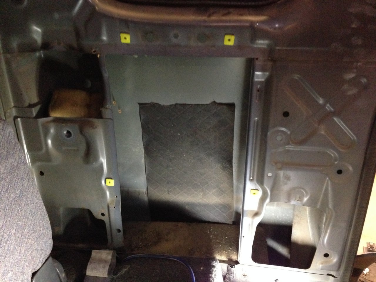

    Well, I played around with the ARB under the seat, and came to realize that it wasnt going to end up there. So I sat in the back seat, looked around and scratched my head a little, trying to figure out where i could mount it in the cab, but hidden away as to not take up usable space. I then looked at the drivers side rear speaker, which i had removed when i bought the truck as well as the passenger side(When I installed my stereo, I was going for quality, not loud, which i have anyways with just the two speakers).
    Which led to this:
    And then this:

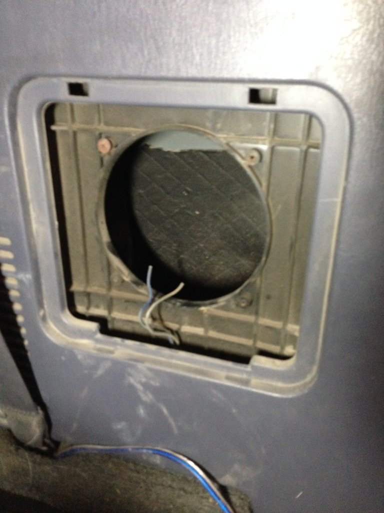

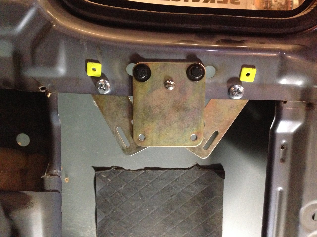

    So I drilled a couple holes, using the supplied mounting bracket, and a couple brackets my dad had at his shop(He is the lead install at Futureshop, so i get to work on my small jobs in the warm bay) and came up with something like this:
    And when mounted, the compressor looked like this:

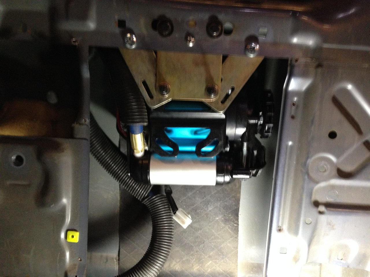

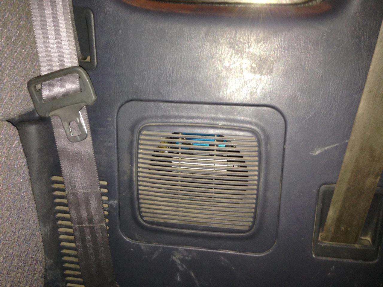

    Fast forward, and it ended up like this. Easy access via the removable speaker grille:
    And ended up looking like this when all said and done:
    And here's a few pics of the wiring:

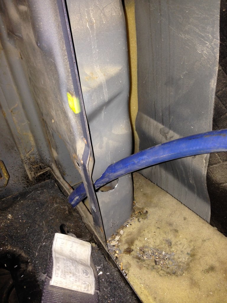

    (I forgot to snap a pic, but the air line is covered in loom where it goes through this hole that i had to cut)
    The black wire here is for my backup cam, nothing to do with the air system)

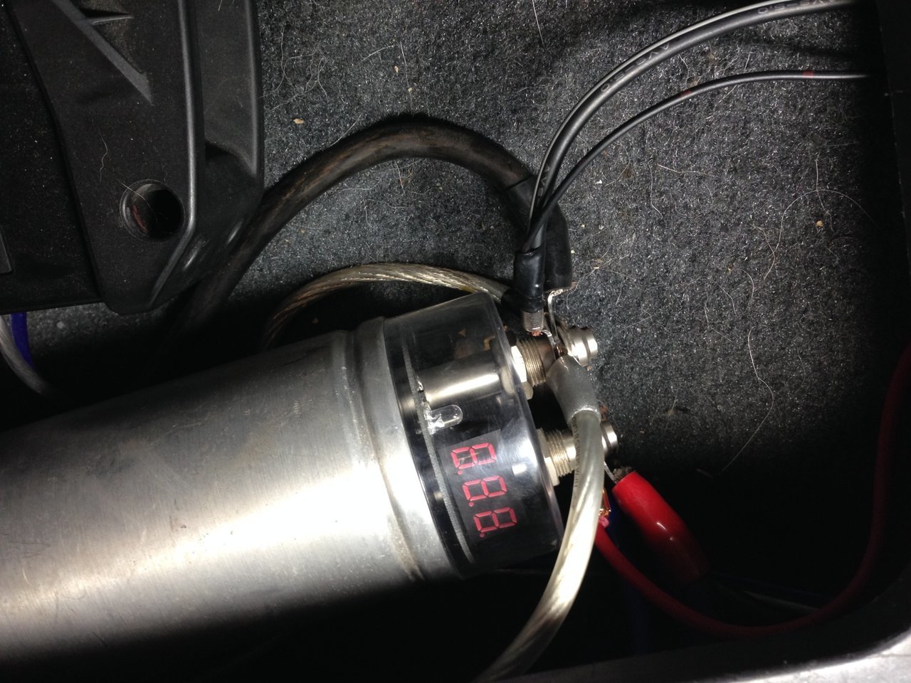

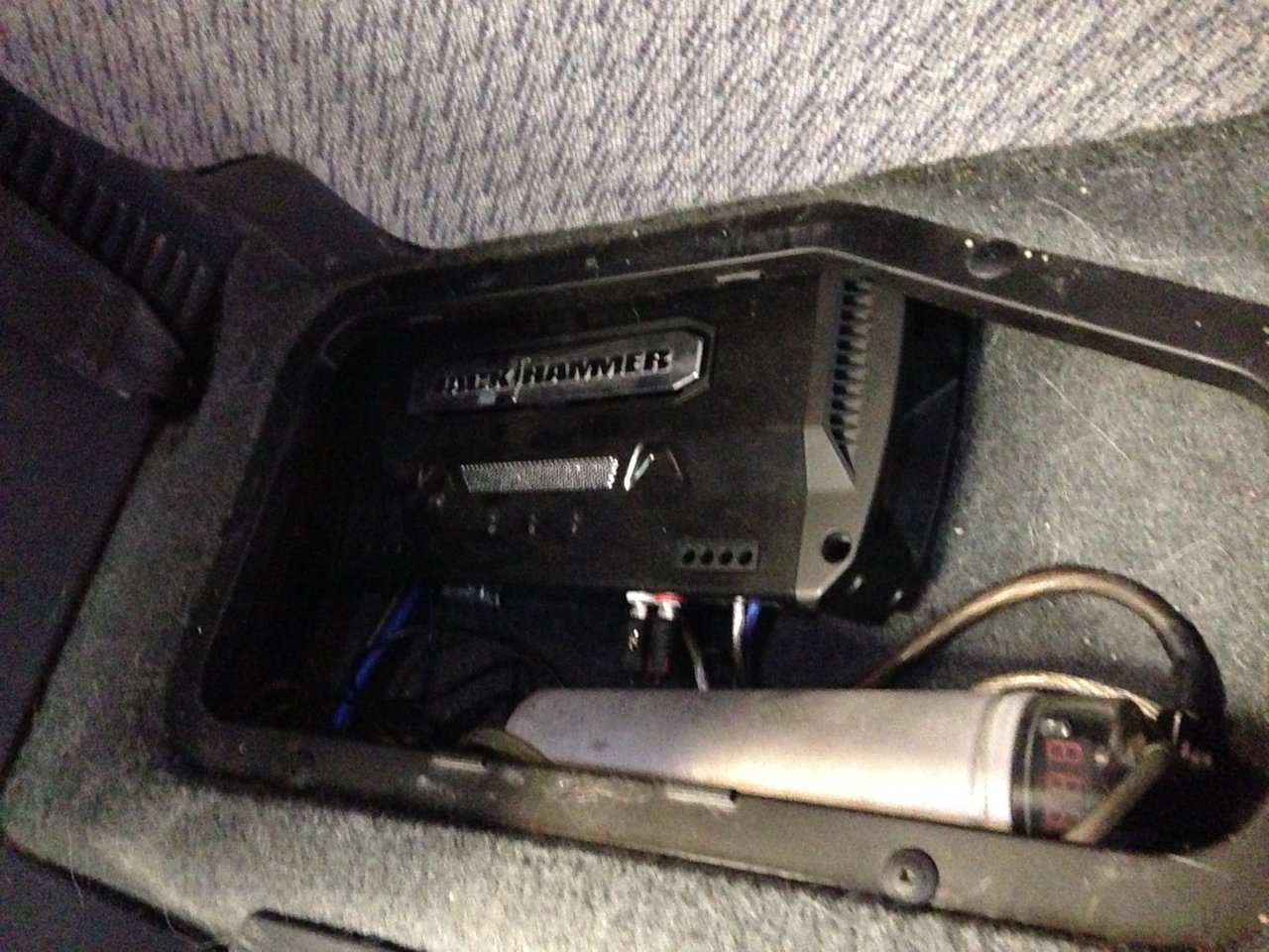

    Power was a breeze to run as i went to the capacitor in my sound system:
    And still plenty of ventilation:
    And that's how my day went. Still have to figure out where I'm mounting the switches, but the hard part is done:) To my knowledge, nobody else has mounted their compressor in this location, but i also havent done a whole lot of research on that bit.
    When I eventually buy a new cab for this truck(my buddy has one sitting in his yard, no rust and 1 small dent) I may relocate both my amplifiers and capacitor to the passenger side same spot as the compressor.
