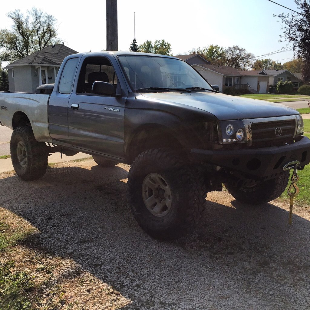

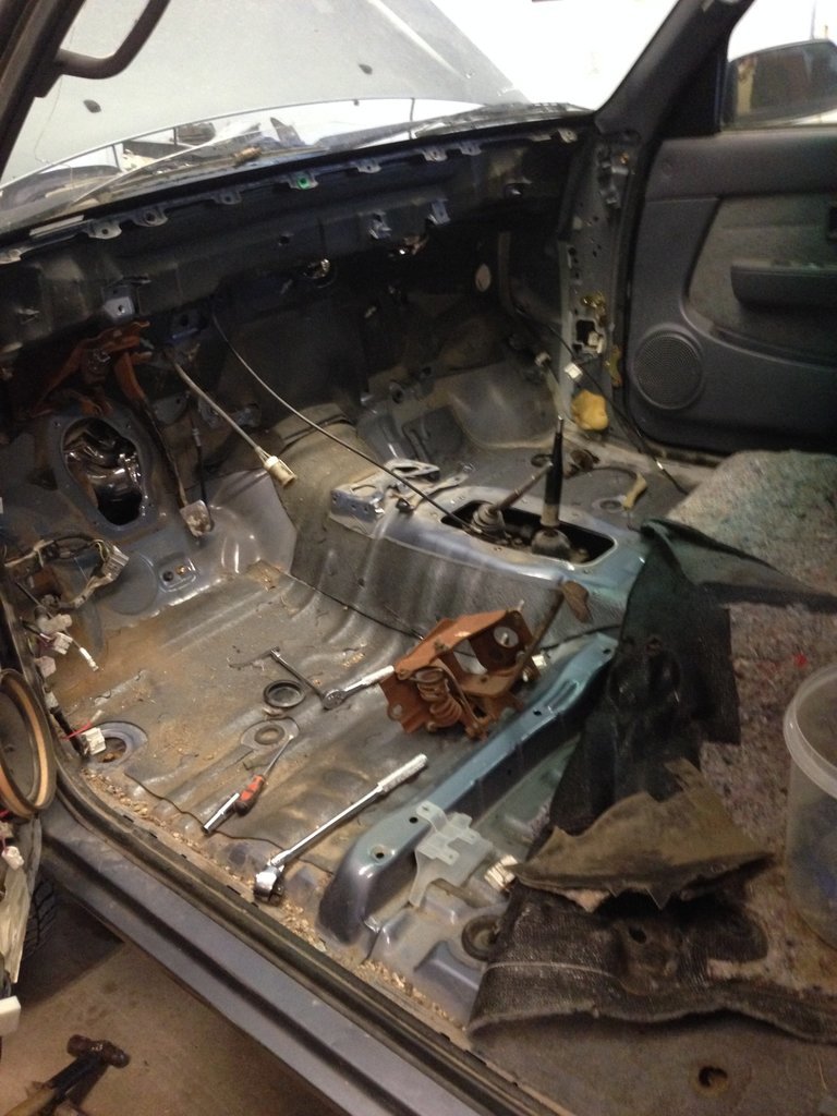

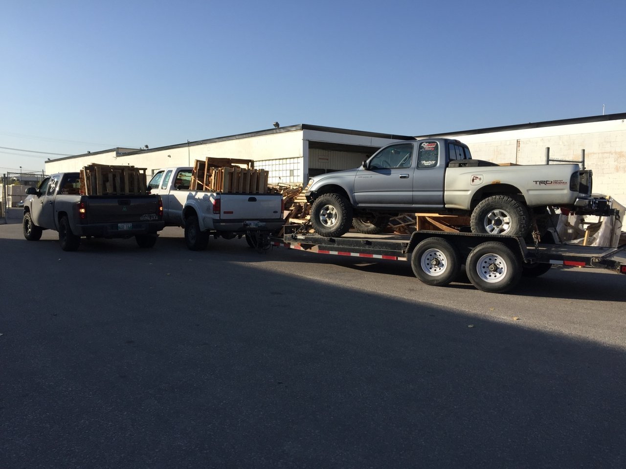

    Sooo been a while. A few updates to be added. Body swap is fully complete, as well as rack and pinion. And a bunch of other stuff as well.
    Loaded up to go home after 5 months :)

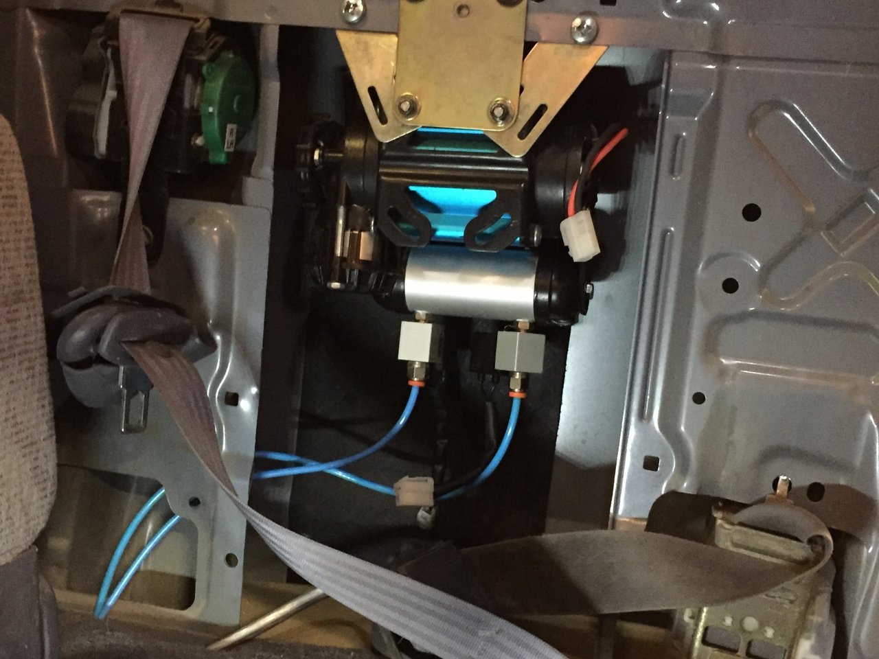

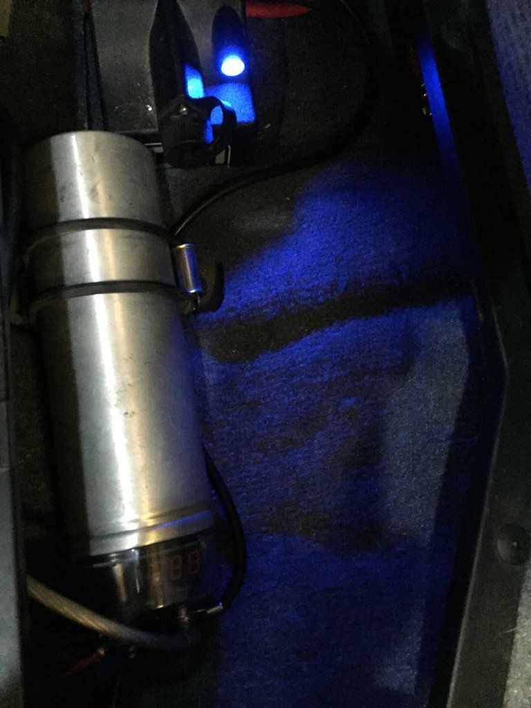

    Got the compressor installed in the new cab with the locker air lines pre run to the storage under the back seat
    Got some turn signals

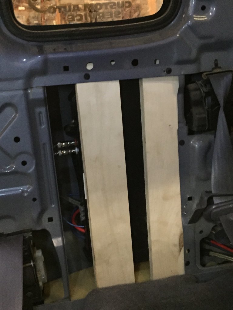

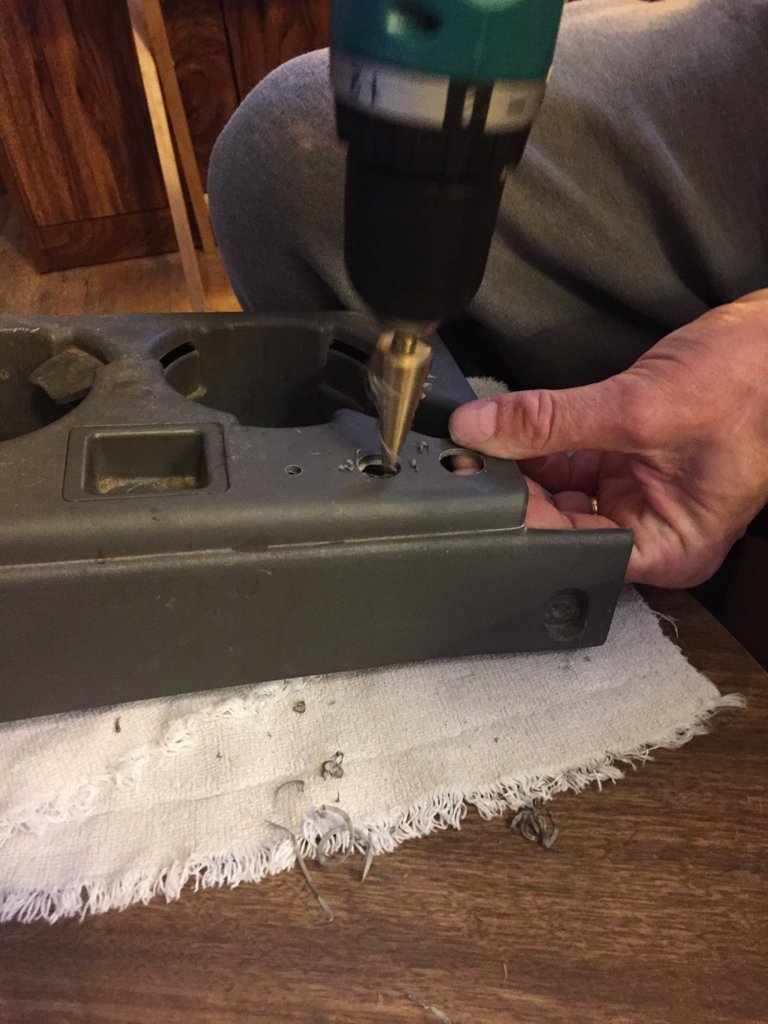

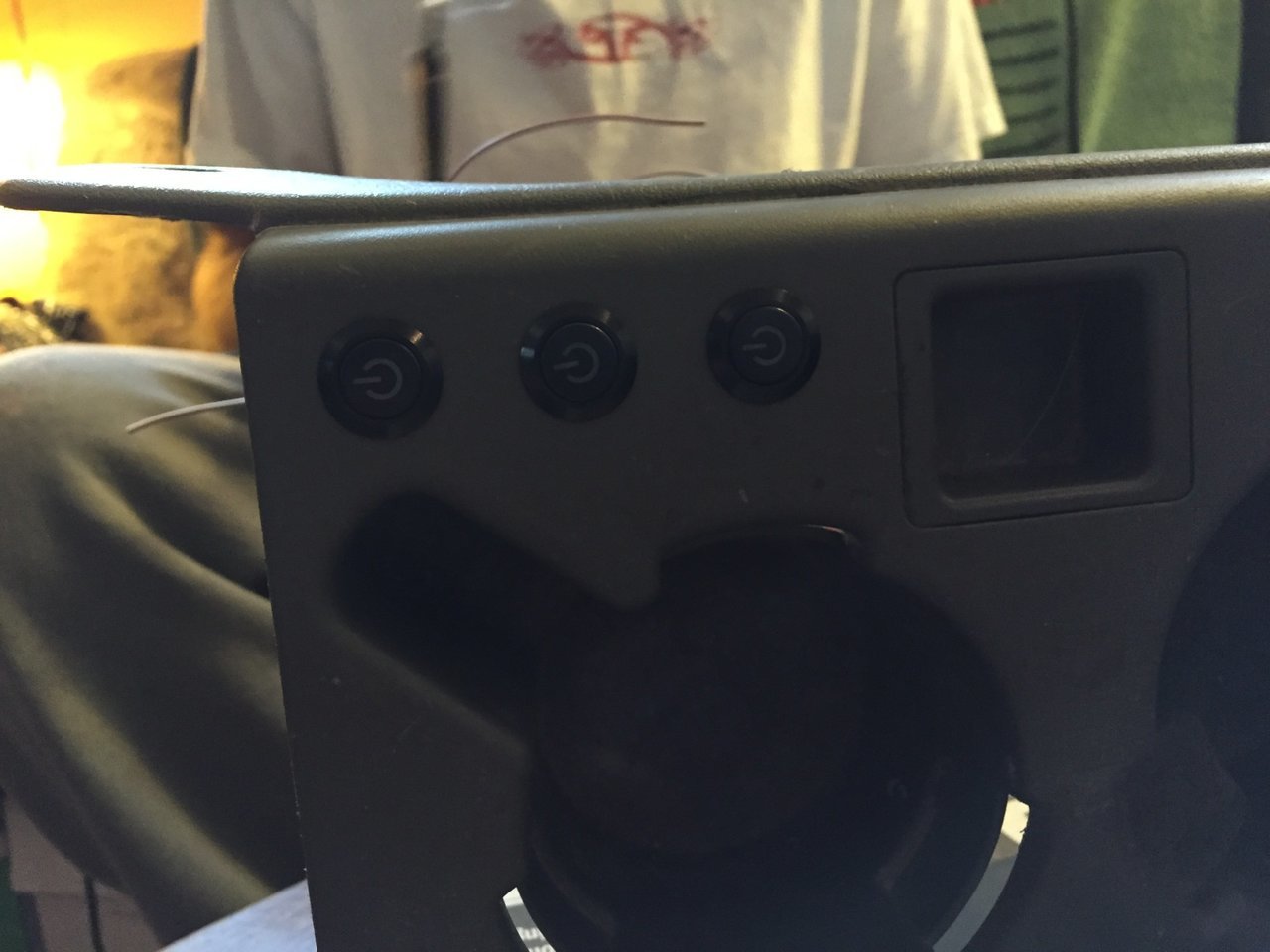

    Put my 600W amp for sub woofer in the passenger side cab wall
    Controller for front winch is under passenger side back seat - wireless still works for a good 75', haven't maxed it out yet!

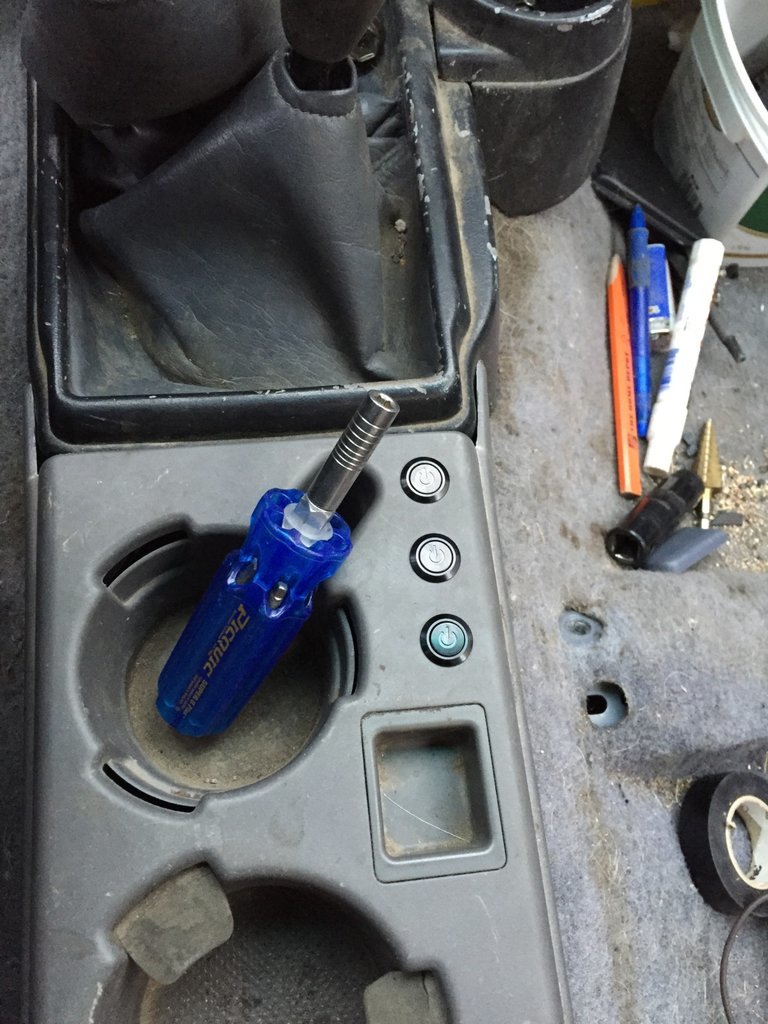

    Ran my own switches for the front air locker(front red switch), compressor(blue switch) and rear air locker(rear red switch)(Yes, I know the rear red switch is crooked, it wasnt tightend down at the point of the pictures_

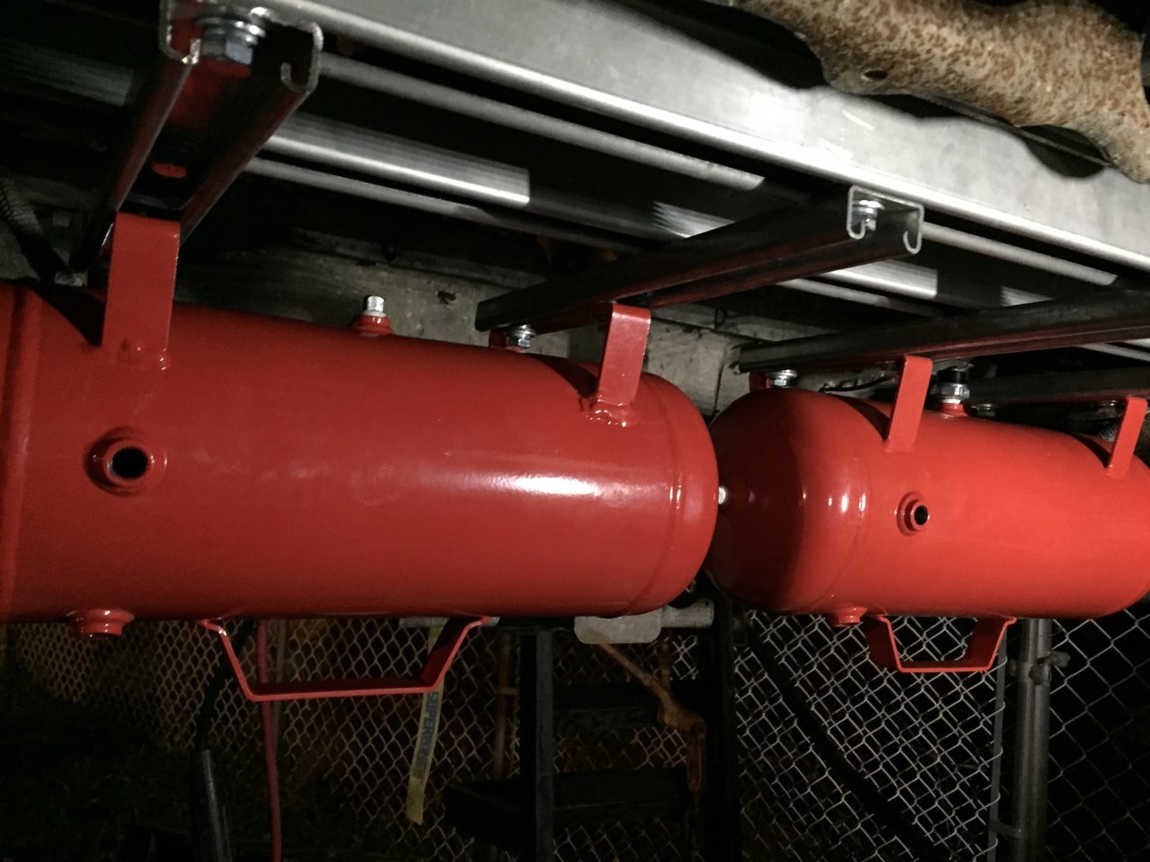

    Got my air tanks mounted about 1/4" forward of my hitch and about even with the bottom of it

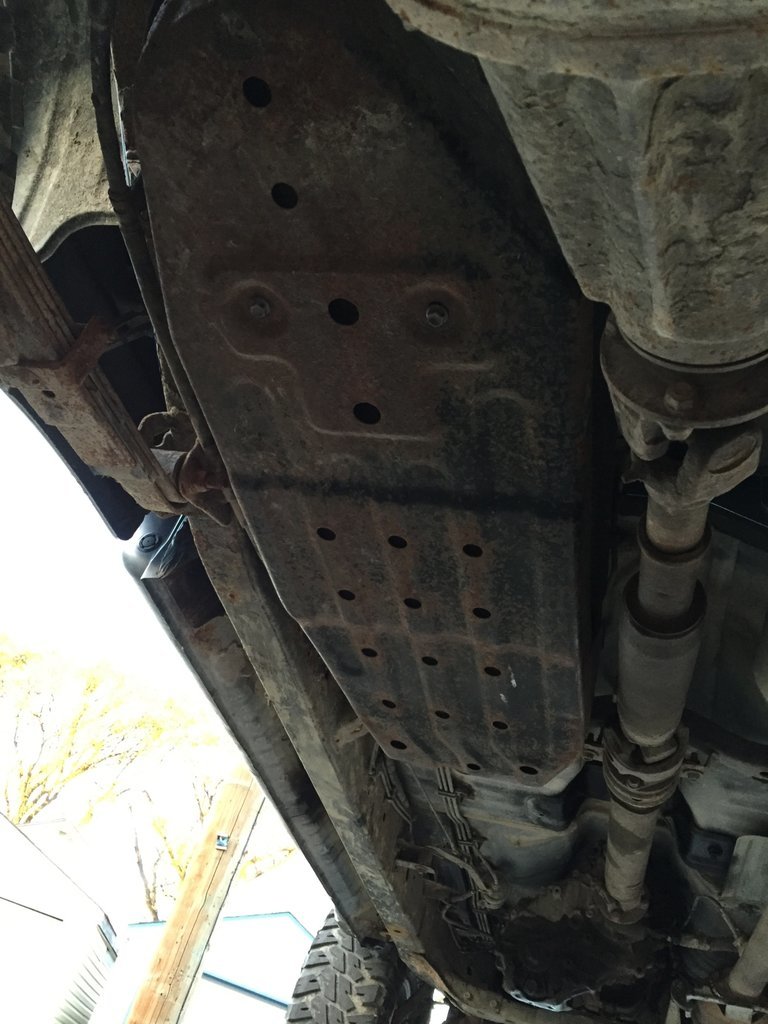

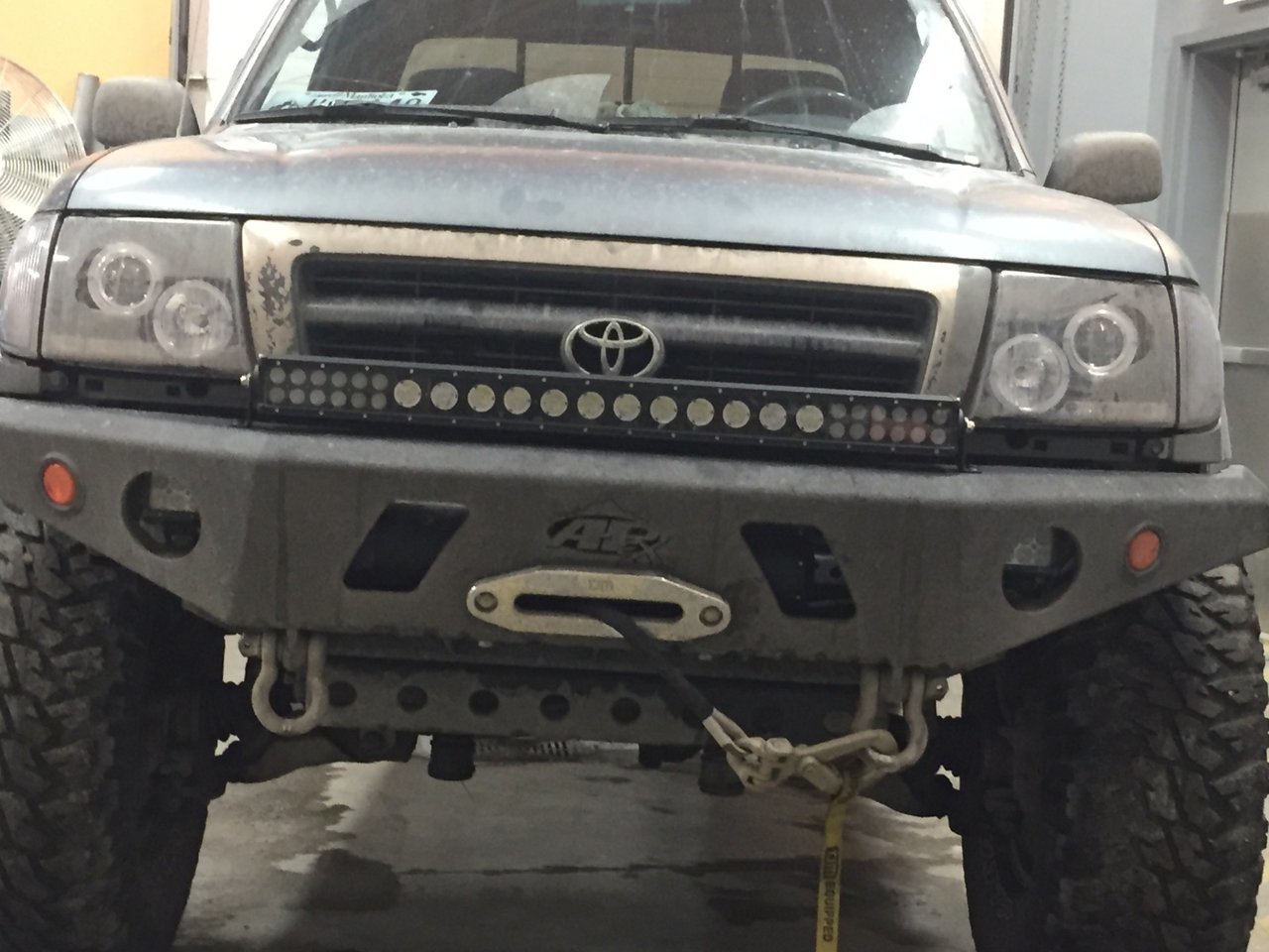

    Swapped out my gas tank skid seeing as the strap had broken 3 times and the old one was rotten... Nice to have this E-Brake cable bracket too, never had it before and was always worried about it catching something
    And the weight ov the winch/bumper sucked my front end down a little as expected, so i threw some spacers on finally for clearance!

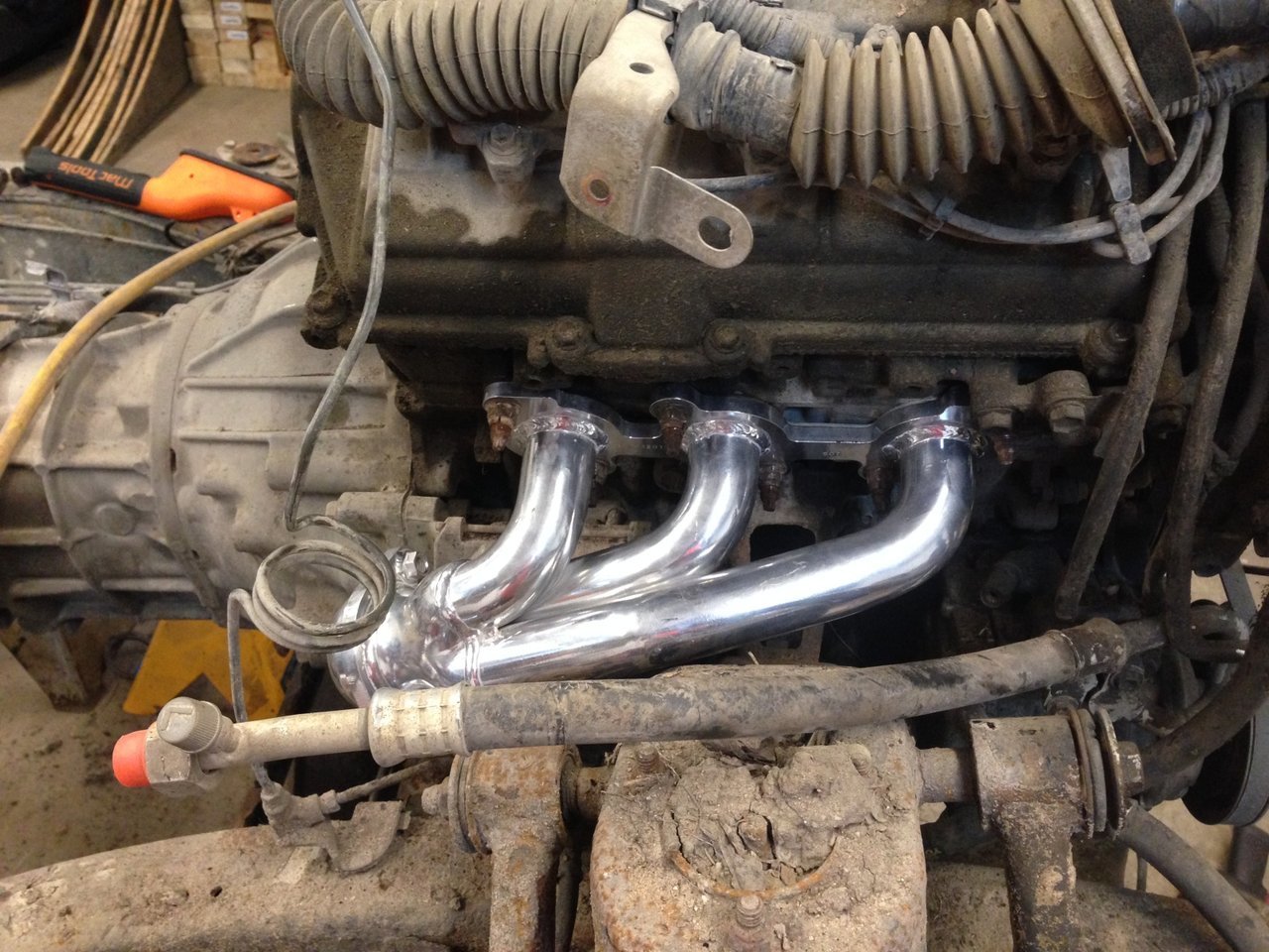

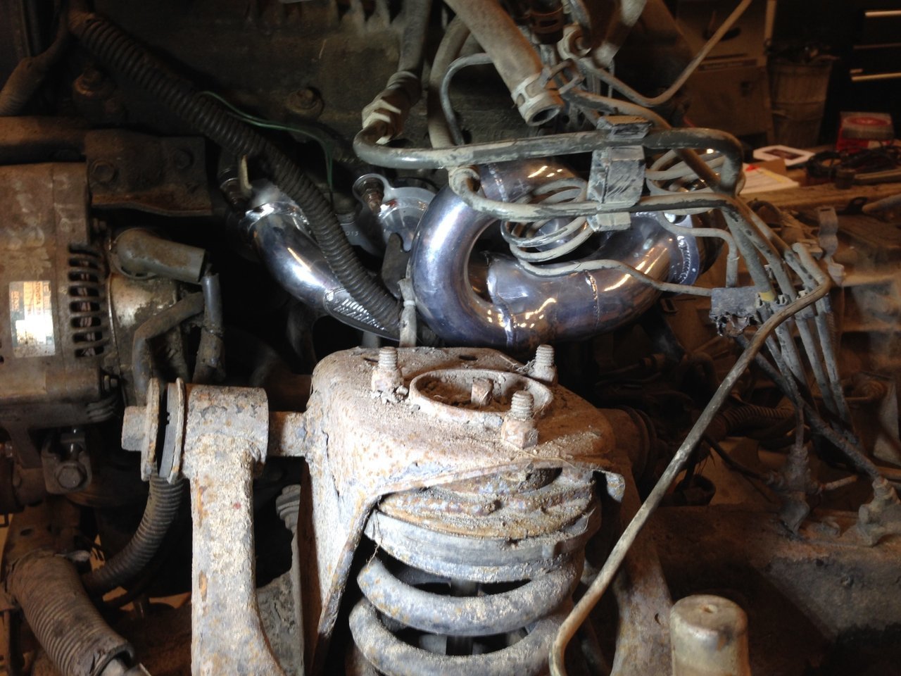

    Threw my headers on when the cab was off
    Still waiting on insurance to inspect the truck because the VIN's no longer match. So for now shes a trailer queen! Went out Saturday evening/night and had some fun with it but spent more time at the bonfire than wheeling.
    Some random pics

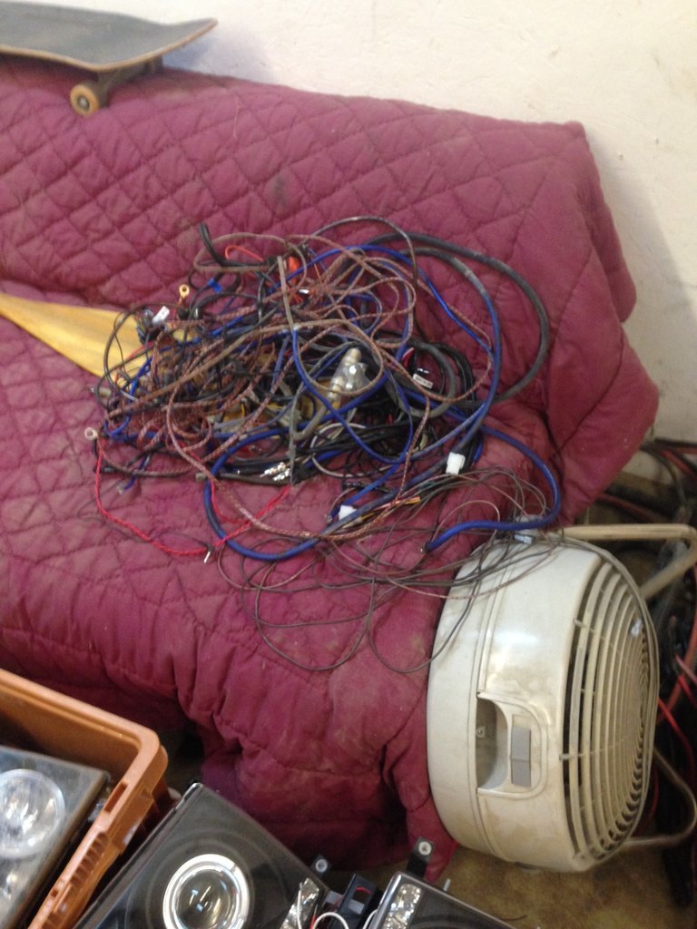

    Not even all the aftermarket wiring that was pulled out... And i put about twice as much back in if you take into account the 3 4ga, 1 8ga and 1 1ga wires i ran for the winch controller!
    Swapped to a 98 style automatic cab so there was some custom cuts to make as well as using the whole wiring harness and dash from the original 97 body
    I've found someone local who actually wants to build my truck, which makes me happy and sad. Happy cause its cheaper than driving it to and from South Carolina, sad because i was excited to go to South Carolina. Same guy who built this LT Chevy
    And that's about it for now!

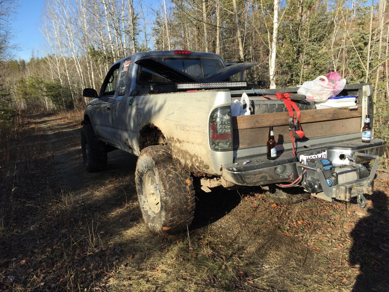

    I suppose you have a fair point. Still the only one to pull anyone out though :p

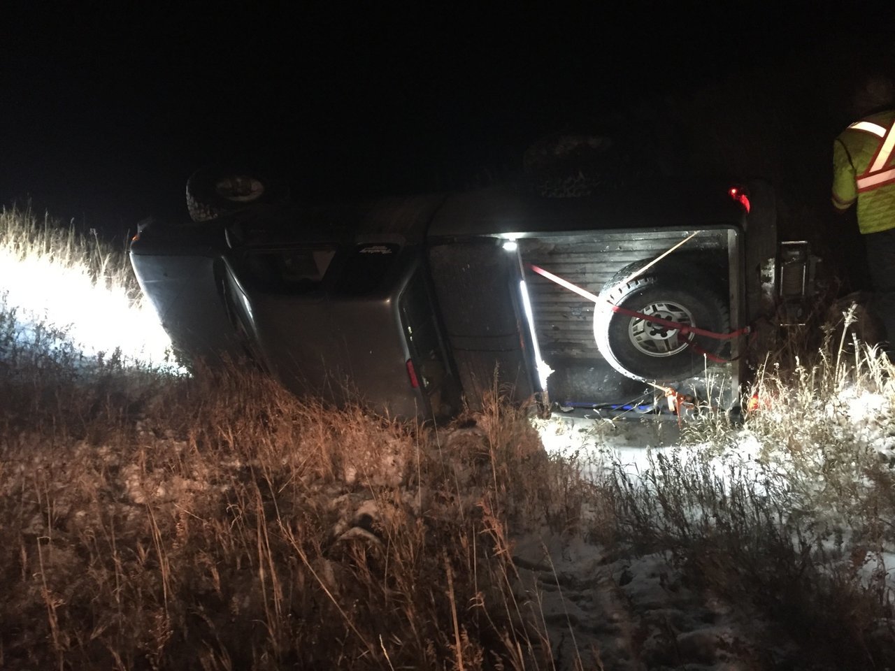

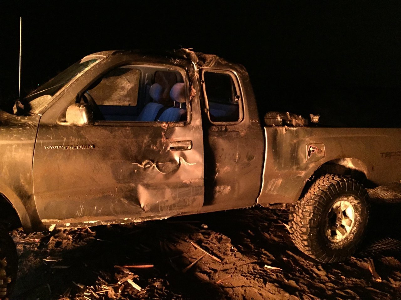

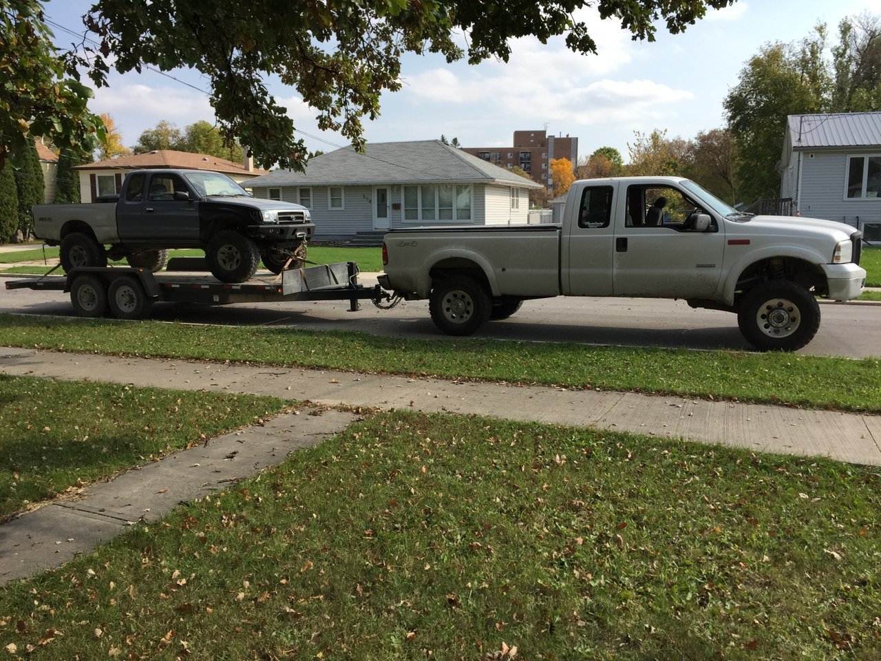

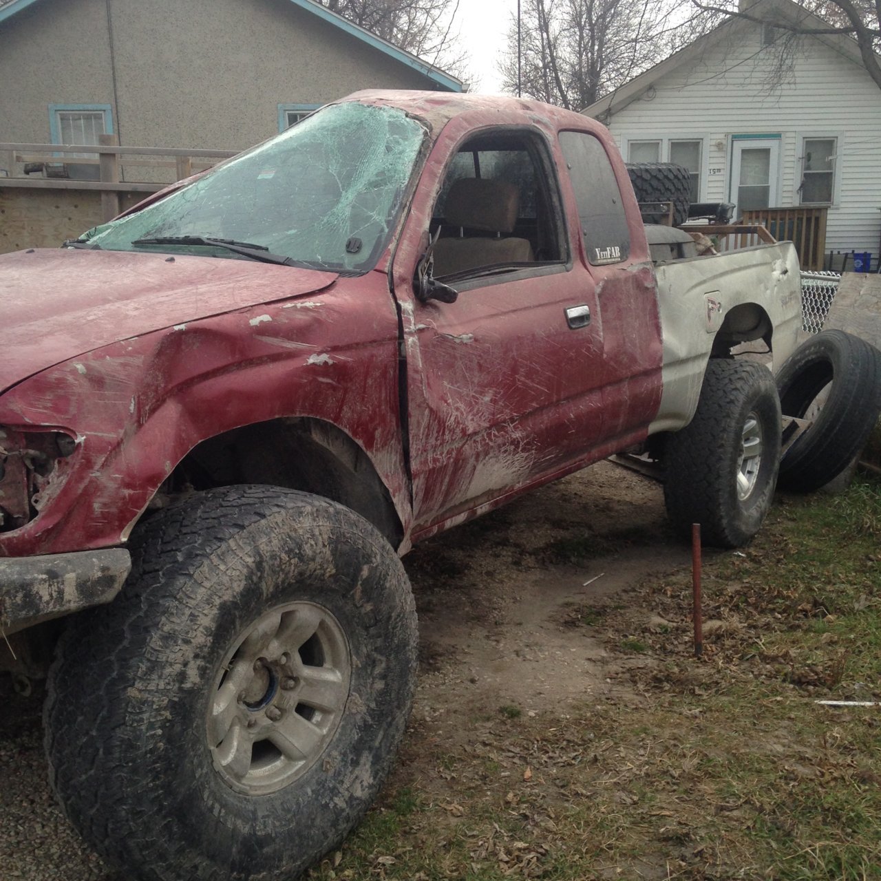

    So here's my new dilemma... Finished my cab swap. Took the truck out and had a blast of a hunting/wheeling day. Got 10 birds.
    And then 2 weeks later...
    So my question is... Does anyone know if a 98 style body can swap directly over to a 97 frame/drive train(with the exception of the speedo cable) or do i have to gut my (new) cab and put it all into my newer un rolled cab... again? I know the mounting lines up but im more worried about the interior wiring/engine harness, climate control etc.

    Yes, the bodies can be swapped. You're good to go.

    Plug and play everything?! This makes me very happy. And sad that we didn't just do it this way the first time... Still gotta swap stereo/air compressor/winch controller over but thats peanuts compared to having to swap all the wiring harness'.
    Thanks!

    Between both the jobs I'm working I don't have time to do the body work. Easier and cheaper to swap bodies seeing as I have a line on a very wide variety of 96-99 tacoma parts/cabs/etc.
    I didn't flop it "again". This is the first time :p but long story short, steep down hill grade and a rut covered by snow = taco trying to take a nap:(

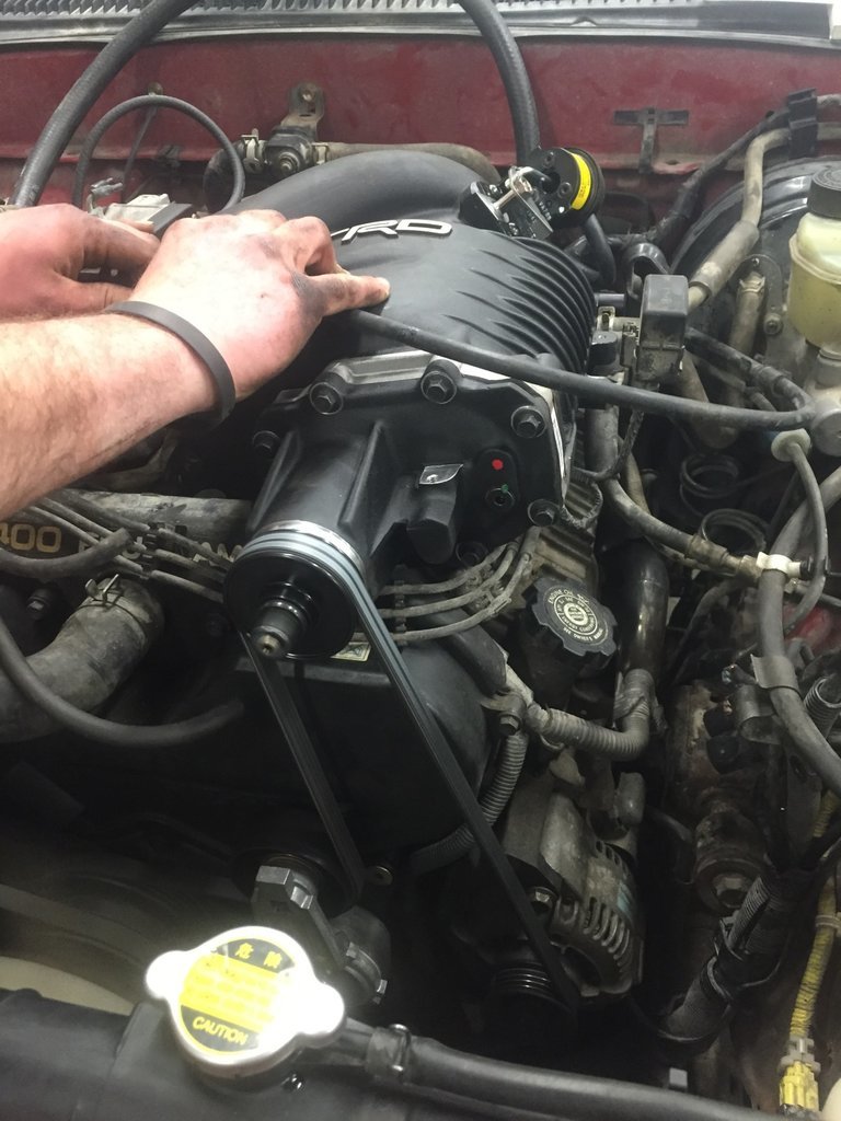

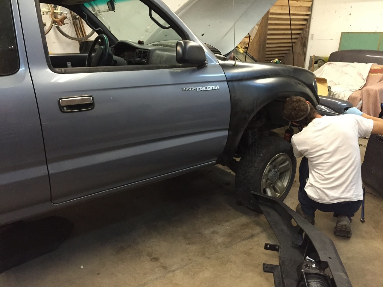

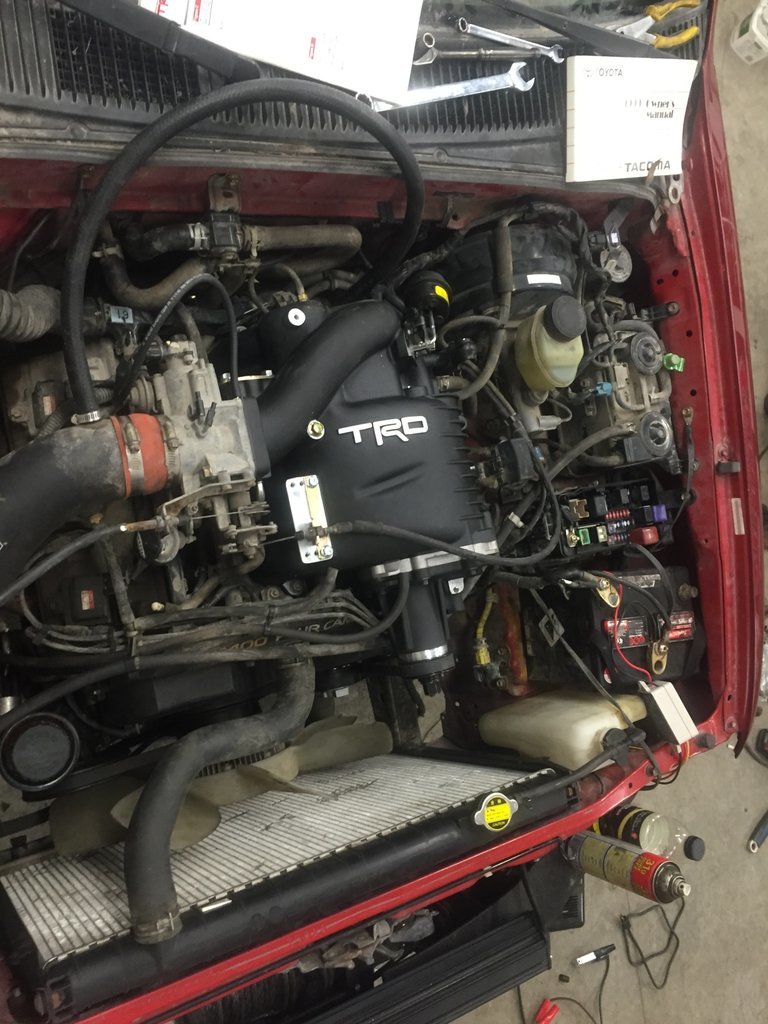

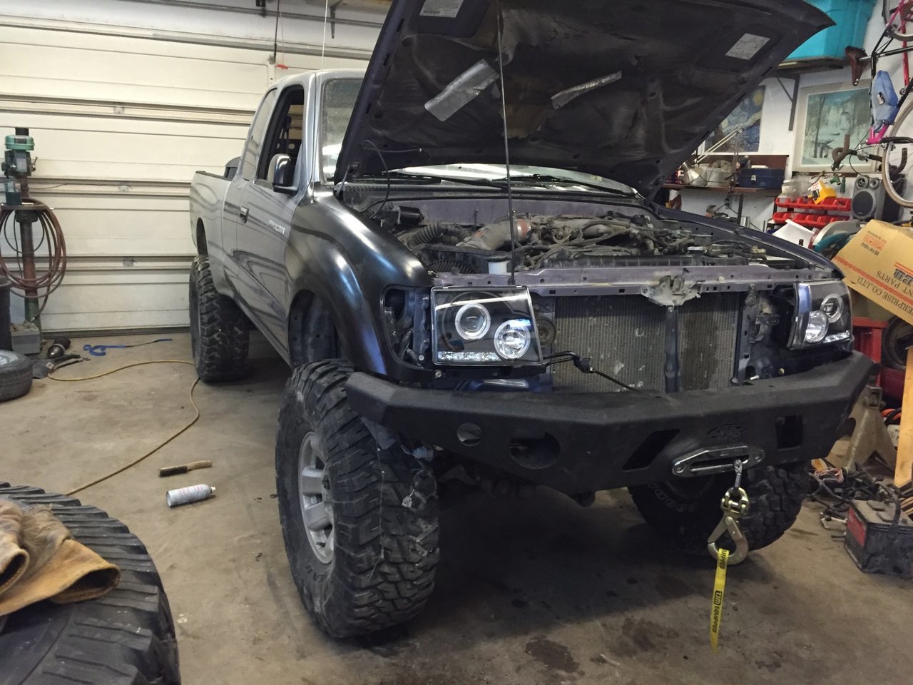

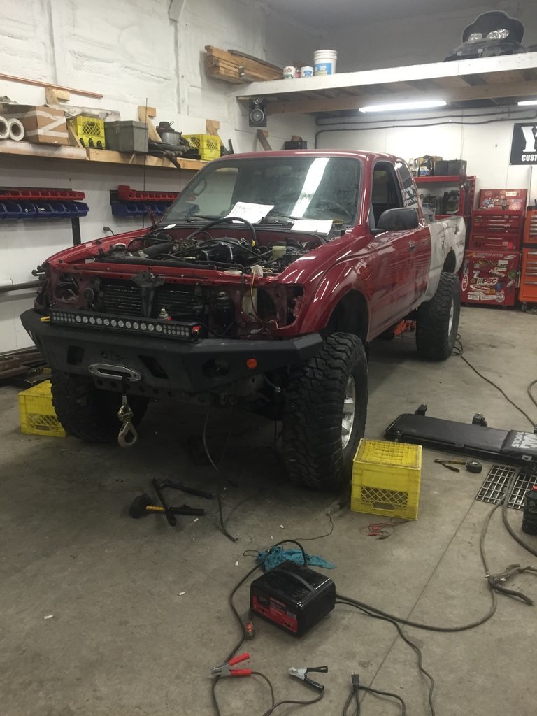

    Sooooooo finally took a stab at cab swap v2.0. Had it in and out of the shop in about the total equivalent working time of 3 evenings, over the time of 4 evenings.
    Getting the old cab off and new cab on was cake actually, had the new cab sitting on the frame at the end of the first night. Used a S100 bobcat and some sketchy rigging but got er done!
    Ran into a few hiccups though. First, pic of the new cab
    So the first hiccup came when trying to plug in the 97 manual ECU harness to the 99 ECU(New cab is a 99). They are 100% different. So instead of re pinning the wiring harness, I opted to get the engine harness from the engine of the truck that the cab came off of. I'm extremely happy with my tacoma parts hook up, Andrew :)
    So to change the engine harness, gotta pull the intake. Soooooooooo.......
    Swapped the wiring harness. threw on the S/C. She fired right up.
    Issue number 2: ran like complete shiiiiiite. Thought it was the computer learning but after 50km, it was very clear that was not the problem.

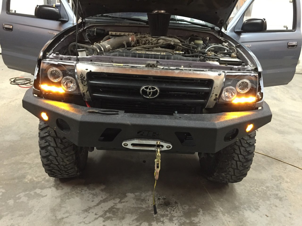

    Fast forward a night, doing research and find out the MAF and IAT sensors are different from 98-older and 99-newer. Explains the two CEL codes.
    So I drove the bag of shit to my buddy where we equipped it with the factory 99 intake. She drove like a dream on the highway home right until I turned off the highway. Turns out, neither of us thought to, you know, check to see if there was a filter in the air box. or at least if there wasn't a bunch of leaves in it. Got another MAF/IAT, and a filter. Threw em in, and MAN does she FLY! I cant wait to throw on the 7th injector kit & 2.2" pulley now!
    Also, compressor/amps/all wiring has been re done, everything is in the same spots and I wont bore you with the same pictures over again :)
    Sooooo going on a may long weekend run with my newly acquired group of off-roading friends, pretty stoked for that!
    And thats whats all new with the project. Diffs are chillin at the border till I have a truck capable of picking them up(or the time)

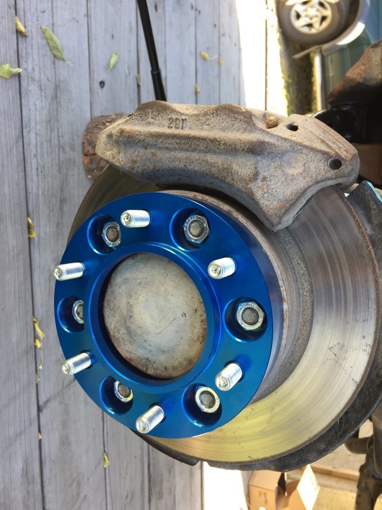

    Front:
    Diamond Axle Toyota FJ80 8" HP
    Drilled and tapped ARP slug studs
    ARP trunion studs
    ARB Air Locker w/ 4:56
    Slee Offroad HI-Steer arms in double shear configuration
    Old school Longfield (Made by RCV) Birfields/Chromoly inner shafts
    Width - 67.5" (63" WMS-WMS + 2.25" spacers)
    Ballistic coil+shock+lower link all in 1 brackets
    Ballistic adjustable upper chock and coil towers
    Ballistic forged chromoly johnny joints
    Ballistic forged chromoly rebuildable heims (1.25")
    TMR universal panhard kit (only used the heims lol)

    5vz-fe supercharged
    2.2" pulley
    URD 7th injector kit
    dual bed mounted 850CCA group 65 batteries
    GM 140a alt
    2/0 cable for all power feed and winch wiring
    Marlin Crawler pickup 4.7 gear driven transfer case
    And that's all i can think of at this current time! Hope you enjoy the pics and if you have any questions, ask away!
