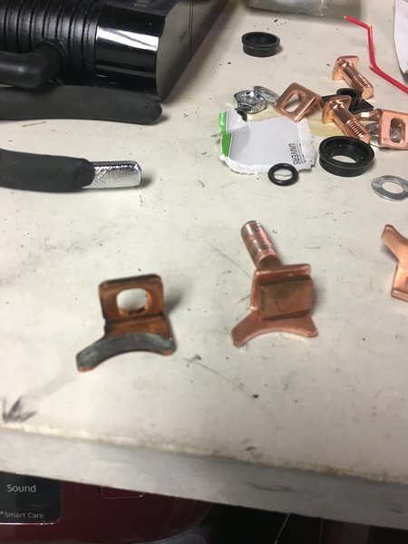

    Starter contacts are an easy cheap fix ($10-20). Don't give up on your Denso starter, it will outlive you.

    Starter contacts. I just had to do them on a skid steer I own. Basically the same Denso starter that Toyota used. Turn the key several times in a row and it would eventually start, until that wouldn't work anymore. When the ignition is engaged, all other power is shunted, but your contacts are worn (grooved) and not making contact every time. I actually got away with just filing the contact plates smooth again. But I did buy a set of contacts and a plunger for the next time. While you have the starter out, its not a bad idea to disassemble it, clean it up and grease all the gears. There are a number of videos out there on how to do this. Hardest part is getting the starter in and out.

    Along these lines, the contacts see the heaviest actual wear(possibly the plunger, but you can usually just use some steel wool and clean it up). They are a serviceable part in our starters. They're designed that way so you don't throw away a high quality OEM starter for only needing the contacts replaced.

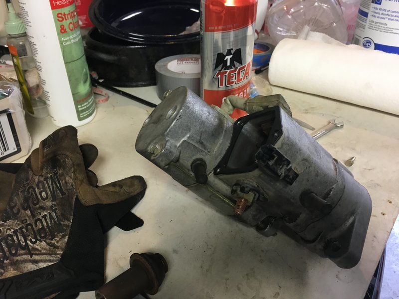

  20. Apr 24, 2017 at 10:12 PM
    #20
    Dan8906
    Dan8906 [OP] Well-Known Member
    Jul 26, 2016
    #192977
    5,138
    Daniel
    Concord, California
    2004 Tacoma ext cab TRD 4x4
    CBI sliders, ADS extend travel with compression adjuster coil overs, 9” Bilstein 5125 rear shocks, Icon Tubular UCA, Alcan custom leafs, All Pro Apex bumper and skids, NWTI rear diy bumper, 295/70/17 Cooper St Maxxs and nitro 4.88s.
    I pulled the starter and replaced the contacts. It's fires right up! Thanks everyone for the help! IMG_6167.jpgIMG_6169.jpg
