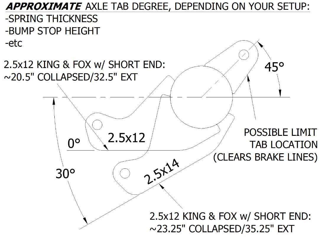

    Yeah, I have this recommendation in the 2.5" Shock relocation instructions for the axle tabs. Then I would run it up to the frame like @EatSleepTacos mentioned

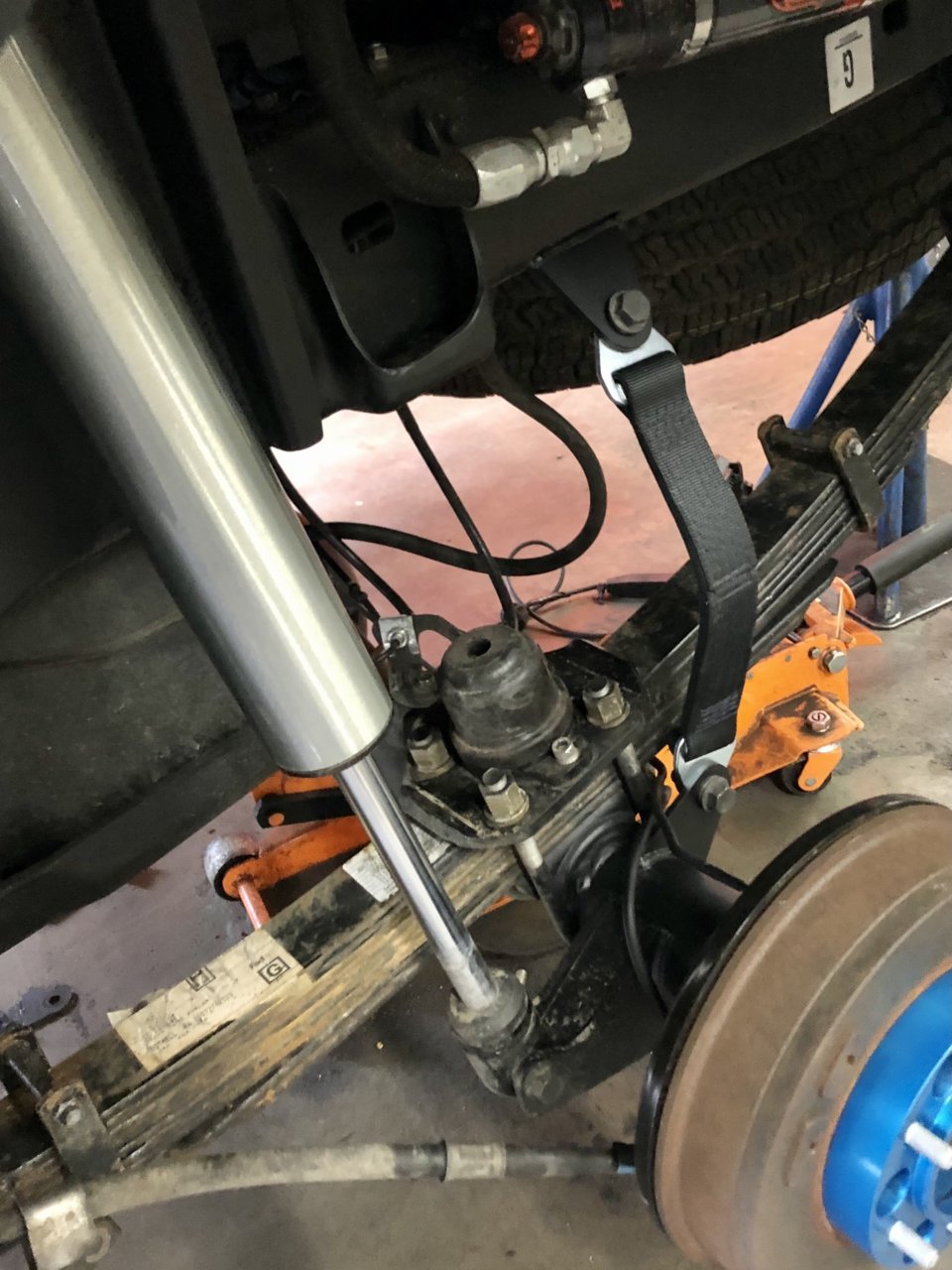

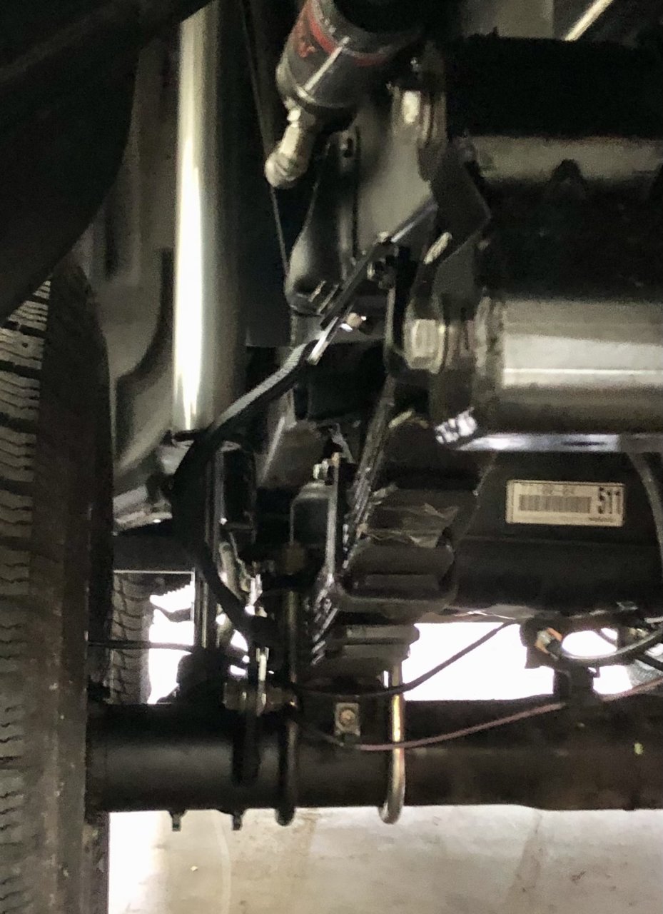

    D94C004A-F2BB-4C2B-80A4-1A182A4BAC63.jpg AABDBEC5-2D99-4870-8640-8C56D2C9F674.jpg Thanks for all the help. I think it’s fixed now, do you guys approve?

    Looks good
