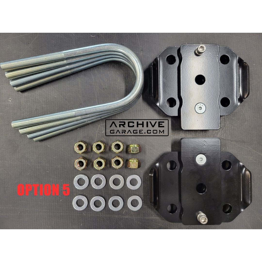

    -Option 1: Powder coated U-bolt plates, NOT for air bump, no pedestal
    -Option 2: LowPro Pedestal for thread in bumpstop, with 3/8-16 thread, without bumpstops (Customer supplies bumpstops)

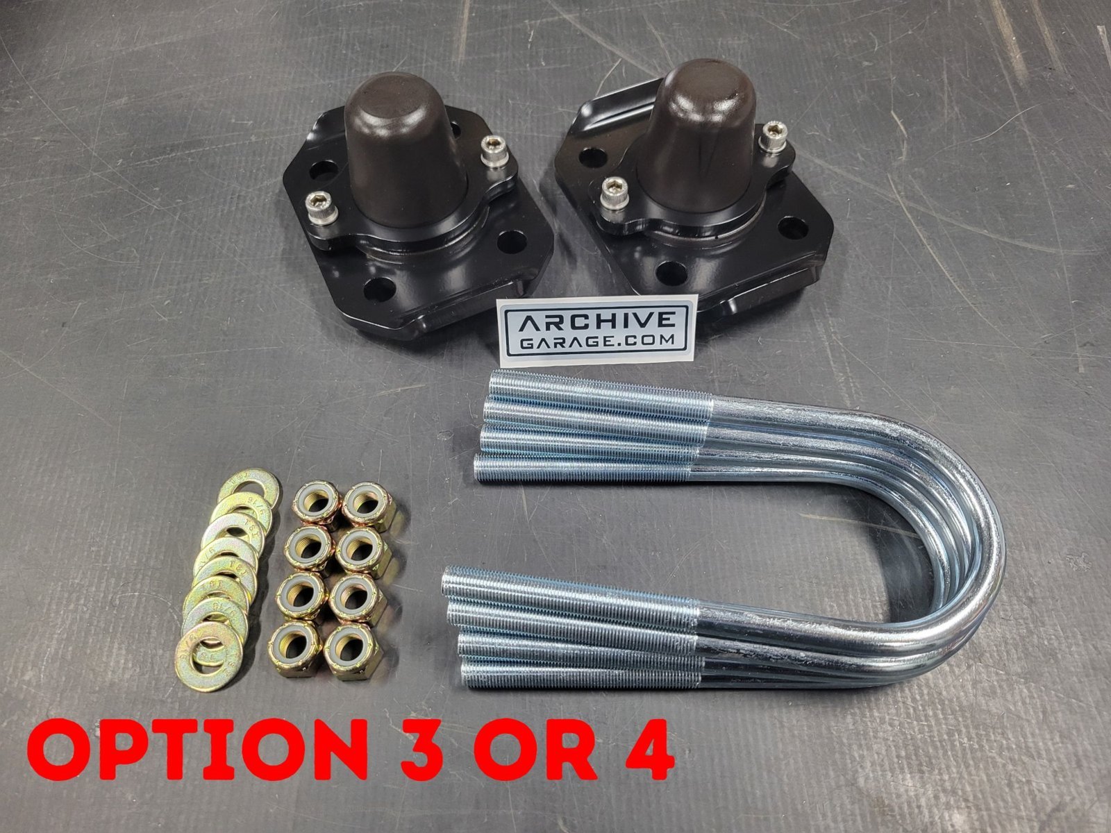

    -Option 3: Archive Speed bumps- Standard Density w/ hold-down ring (Tacomas w/ up to 1,500lbs added to axle)
    -Option 4: Archive Speed bumps- High Density w/ hold-down ring (Heavy Tacomas over 1,500 lbs added to axle)
    -Option 5: Powder coated U-bolt plates + bolt-on air bump plates w/ kick out for air bumps

    Have any customers bought the option 5 flip kit for air bumps, and if so what air bump mount are they using to line up with your plates? Would The standard Total Chaos bump stop kit work with your bump stop plates?

    Yes, several have with TC and Icon and yes it will line up, I have some Option 5 in stock

    Hey @ARCHIVE - KILLER products, you have an incredibly nice set of really well thought out products.
    I'm interested in your U-bolt flip kit & bump stop platform with pedestals (Option 4 most likely) but have a question. With Icon RXTs (setup with Option 1 - 1.875" lift without weight), no hangers yet / stock shackles, and extended length Fox 2.0 rears, is your Option 4 with the Wheeler's Super bumps enough height in the bump stop? Or will I need more of a spacer under the bump stop? I'm not really sure how much the Super Bumps compress.
    Shock: Fox 2.0 rears, 3.5-5" lift part #985-26-118
    Extended Length: 24.8"
    Collapsed Length: 15.2"
    Travel: 9.6"
    I'll email you separately and was going to ask you this question in that email, but I can point others to this thread this way. I know some people aren't running extended bump stops after increasing their suspension travel (in particular droop). Hope this post helps the community.

    @ARCHIVE I may have just figured this out. Per THIS POST on this site that I somehow missed in all my searching before, it sounds like to really get this correct I need to:
    1. Install the springs and shocks, drive a tad so it will settle.
    2. At rest/static load and on a flat surface, measure from the bump stop pad (surface where the bump stop will bolt to) up to the frame contact point. Call this measurement 'A'.
    3. Measure how much exposed shaft remains on the shock. Call this measurement 'B'.
    4. Subtract B from A. This tells me how big of a bump stop is required at full compression.
    So if for example A - B = 1.750" and I was looking a bump stop that compressed to 1.5" max, I'd need to space the bump stop up by a minimum of 1/4" (0.250"). My assumption is a 3/8" (0.375") spacer would probably be smarter in that example.
    Is this correct? And if so... sounds like your pedestals will work just fine and I may/may not need to run a bump stop spacer?

    Thanks Ted! Fortunately I know the answer, my Ubolt flip with option #4 pedastal with Super bumps, can handle shocks up to 16" compressed. You'll have a little extra room with 15.2" compressed
