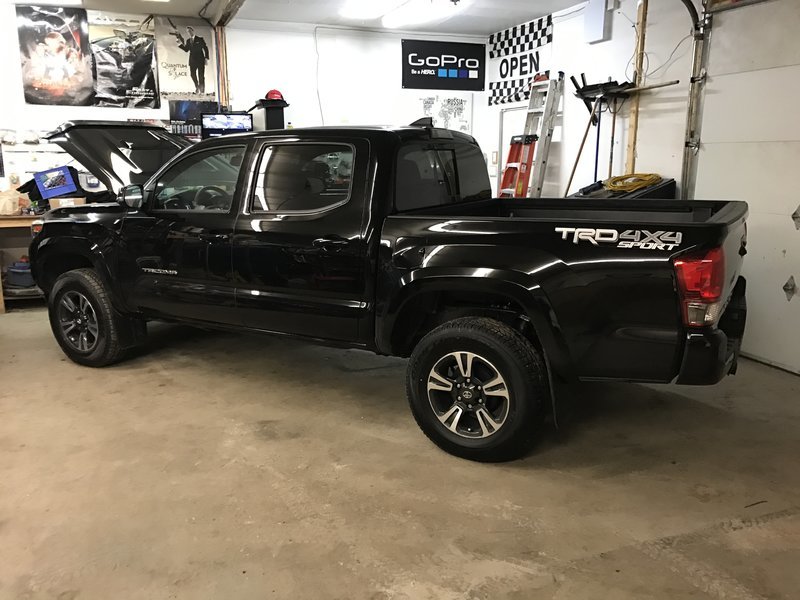

    Well, I finally have it!
    I've resarched the crap out of this thing, test drove a few of them and I am not disappointed!

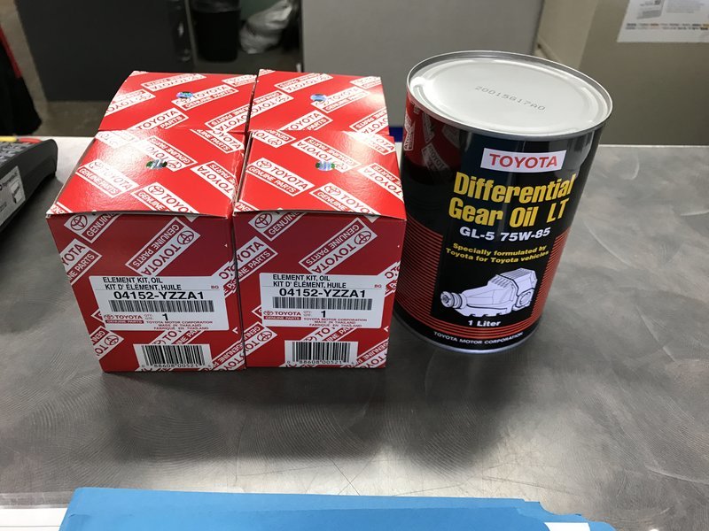

    Because I've read that some owners are finding their transmissions and diff's low on fluid I picked up some toyota differential fluid and manual transmission fluid. If mine are low, I can do something about it.
    I also picked up a few oil filter cartridges for when it's time to do that.
    Tomorrow I'll get the truck to the shop and verify fluid levels and report back.

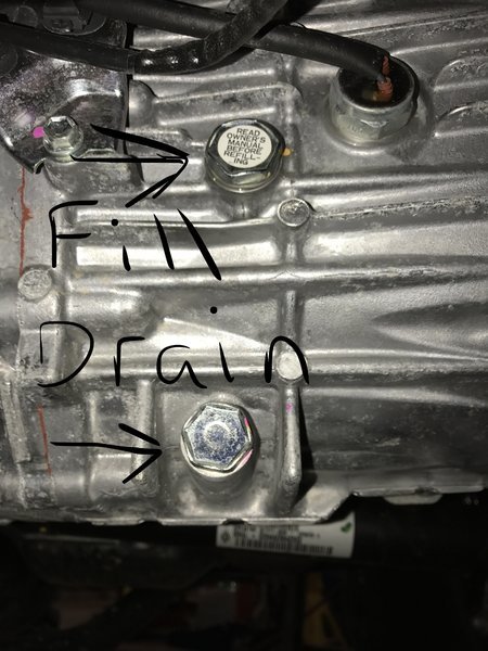

    My Rear Diff took 700ml before it started coming out of the fill hole.
    My Manual Transmission took 300ml before it started coming out of the fill hole.
    My Front Diff took 300ml before it started coming out of the fill hole.
    FSM says 5mm below fill plug and higher is acceptable.
    On the rear diff I estimate I had to reach well past 5mm to touch fluid.
    On my Transmission I couldn't reach the fluid level but it requires reaching at an awkward angle.
    On my front diff I could not reach the fluid level with my finger.

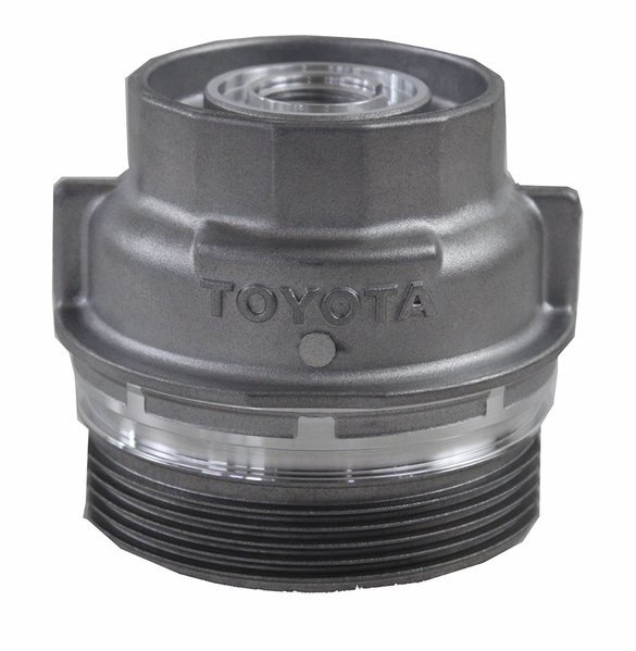

    I ordered an Aluminum version of the plastic oil filter housing from toyota today. When I do my first oil change I'll swap it out.
    Cap Assembly 15620-31060

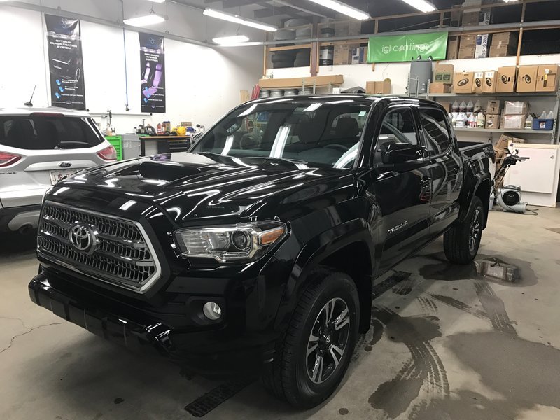

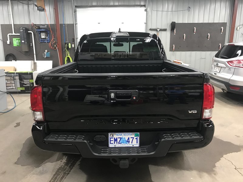

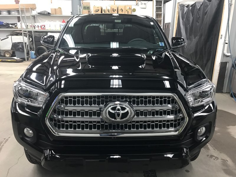

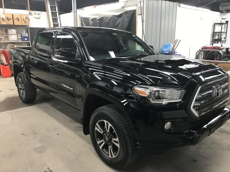

    Had the truck detailed today by the local professionals -Banks Cleaning and Maintenance-
    It's true the dealership 'detailed' the truck before I got it. My friend owns this shop and they do high end work. I will generally get them to do a full meal deal on a new vehicle I buy. They way I look at it is this service provides actual paint and fabric protection thats will help both last as long as possible if I maintain it.
    The Exterior service in steps:
    -Wash
    -Knock Out
    -Wash
    -Chamois
    -Angel Polish 9H Primer
    -Angel Polish Cosmic
    -Wait 45 Minutes
    -Remove
    -Wait an Hour
    -Wait 45 Minutes
    -Remove
    Interior:
    -Fabric Protector on Floor Carpet, Carpet Mats & Seats.
    -Aerospace 303 Rubber Protector on Rubber Mats

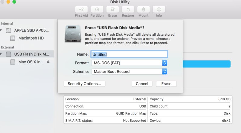

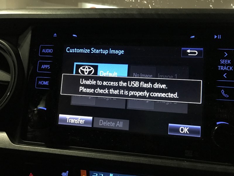

    Changed my display pictures using this tutorial.
    https://youtu.be/soXifqOWRcY
    Great tutorial but does not address the following requirement.
    Mac users need to format the USB drive to MS-DOS (FAT). This is FAT32 format which the Entune system requires.
    And if your OS has the option to choose a scheme, select Master Boot Record.
    If you do not use this format this is the message you will see on your screen.

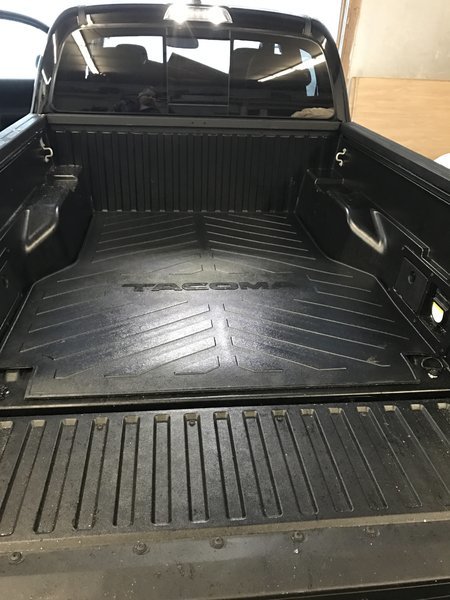

    My bed mat and aluminum oil housing arrived and I managed to stop in and pick then up today. The Toyota dealership I choose to deal with is 1 hour away from where I live.
    May seem extreme but I have family that lives in that area as well so it's not usually a special trip to the Toyota dealership.
