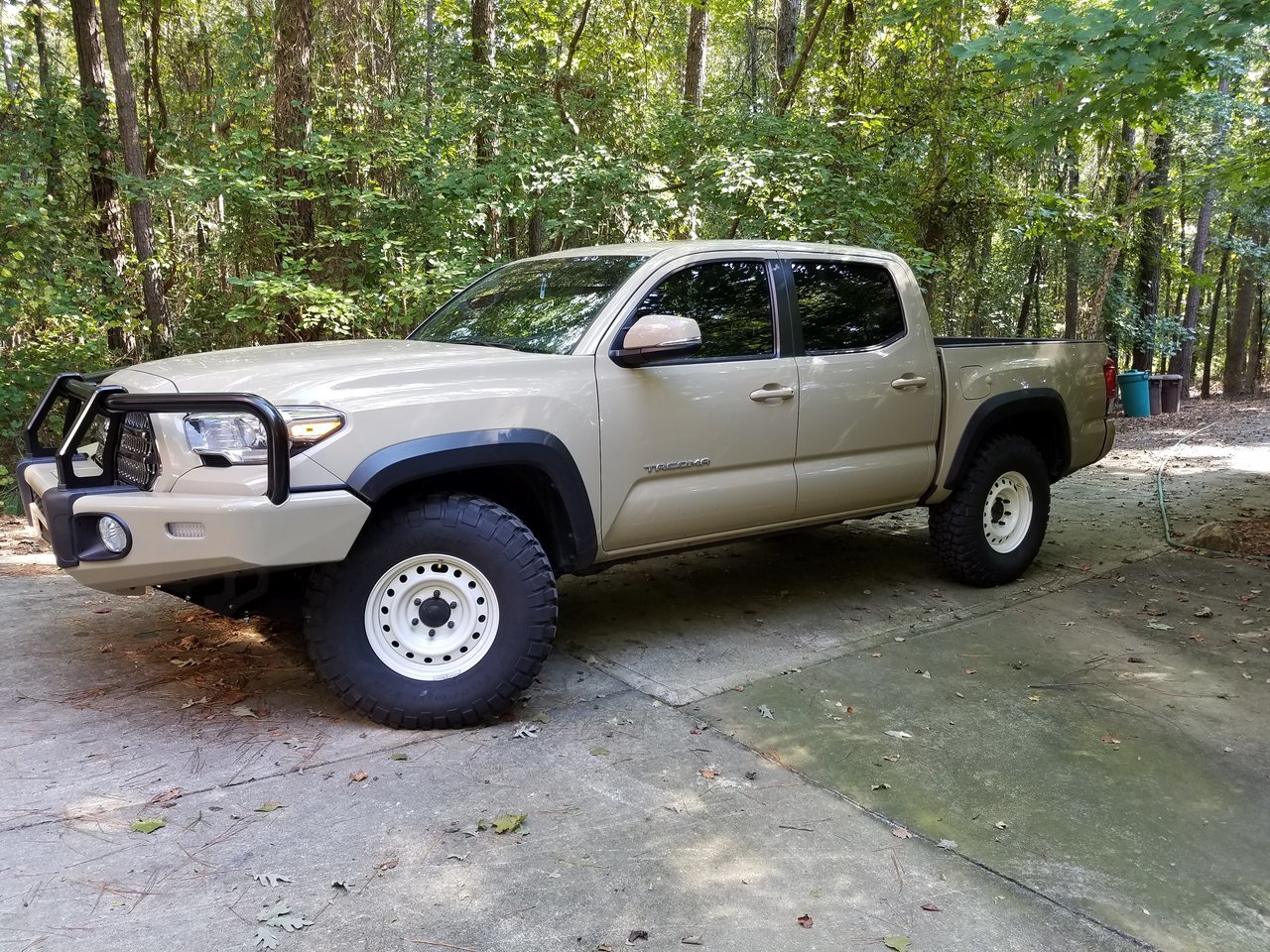

    These are 2nd gen Steelies, they fit perfectly.
    I'll look for the part number if you still need it.

    I painted them the white Toyota uses on the FJ Cruiser roof.
    I'm happy.

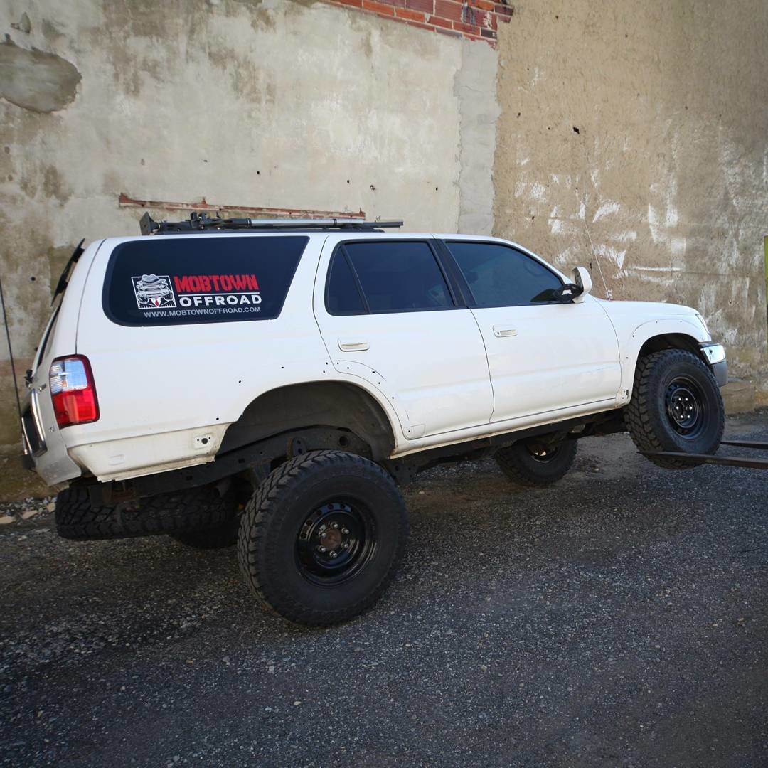

    I did just that. I collected 5 steel spares from 2nd and 3rd Gen. Tacomas, got them powder coated in gloss black and then puts 255/85-16 Maxx ST's on them. The front hit the caliper so I put spidertrax wheel spacers on and everything worked well.

    42601-AD030 is the wheel number, I bought them new online for $95 each. I had to buy TPMS for a steel Taco wheel also online, they came from Lagrange Toyota. I paid about $140 for the four.
