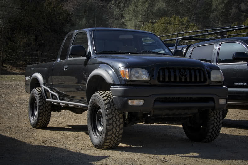

    FJ 17" steelies with 265/70/17, at stock height and no adpaters
    same setup lifted 3" with 1.5" adpaters

    You shouldn't have any issues on the 2nd gen.
    Ditto. At stock height, it will pretty much tuck in almost like stock. It's only when you lift it that you should consider adding adapters unless you prefer the tuck in look.
