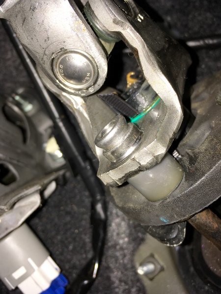

    I had my doubts and have stumbled across this thread several times the last couple of years but I decided to try this zip tie shim fix and it seems to have eliminated my sloppy steering over bumps. After removing the white plastic nuts and cover I noticed some play in the joint when pushing on the lower section. I was able to wedge in a zip tie barely with needle nose pliers then I cut off the excess. It instantly tightened the joint 100% when pushing on it. There is no play now. When replacing the cover, the white plastic nuts just simply push back on, no need to screw them back on. I don't know to what degree the placebo effect is a factor but this mods seems to have cured the sloppy steering over speed bumps and rough roads.

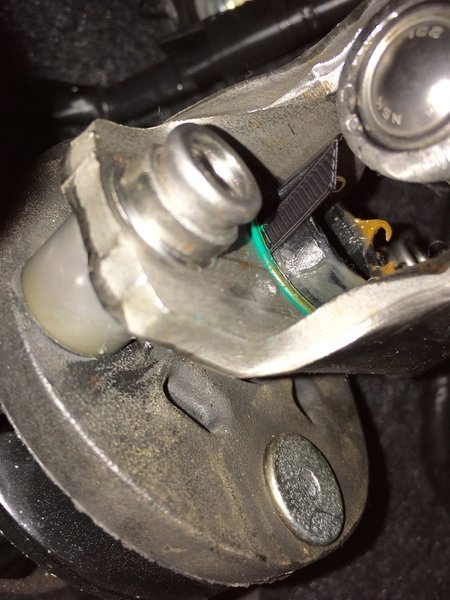

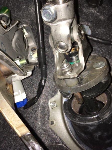

    After a week of enjoying my tighter steering feel with much less slop and bump steer I wondered if I was going crazy and it was getting worse again so soon. I thought maybe the zip tie fell out. I waited a couple days and paid close attention to the steering feel. Today I took off the cover to investigate. The zip tie was indeed still there but the rag joint had some play in it.... again. It wasn't nearly as loose as it was to begin with but it had loosened itself just a little. I managed to wedge another zip tie in there and it now is tight again. This leaves me wondering how long it will last.......
