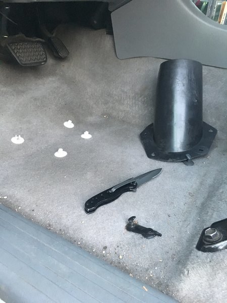

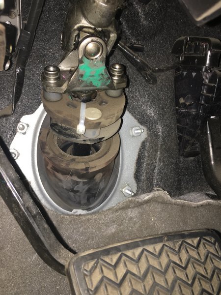

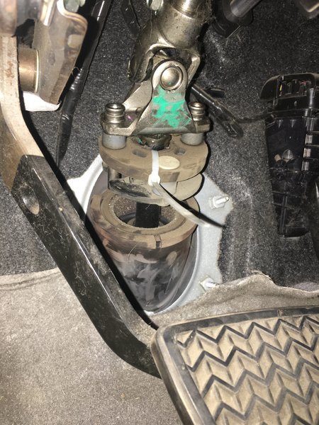

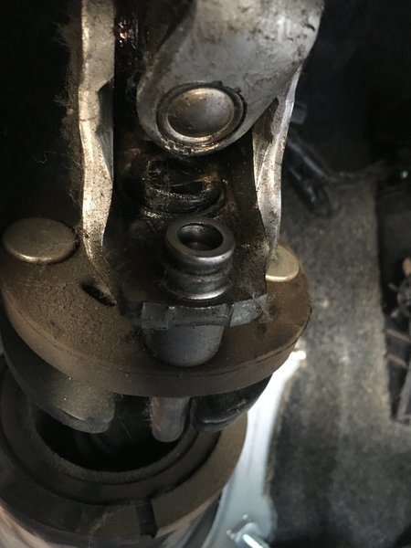

    I'm giving this a try to see if it helps...
    I'm going to go drive the truck now and see if it helps. I'll report back in a little bit

    So, after driving over some somewhat bumpy roads and on the freeway, I didn't notice any difference. It's possible that I needed a thicker, more heavy duty zip tie in there or more of them :notsure:
    The fix probably works, I think it just depends on the particular vehicle and how much play there is etc

    Not sure your ziptie is in same place as in pic from pg 1...............

    Hmm...that's a possibility. I'll go out and have a closer look in the morning.

    For those of you installing zip tie you are defeating purpose of this joint. Yes the design of this joint sucks but it is meant to isolate steering wheel from steering rack and by installing zip tie your going to feel and hear every pebble in road unless your truck is loud or rattle trap. I tried the zip tie and immediately removed it. Do what post 11 says, what he is doing stretches the rubber in joint making it slightly less flexible eliminating clunk.

    I can't get a zip tie in there....no room.
