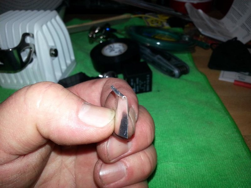

    Thanks TOYOTA 09 for the the idea. I went ahead and made two small spacers (one for each side) out of sheet aluminum. I put a lip on the top edge to keep it from sliding down, then rounded it slightly. Went for a short drive and it felt fine and stayed in place. I'll check it again in a few days.

    What about a fuel line or a rubber line cut in half? Wouldnt that work?

    I thought about something like that, but it would have to be quite thin and may eventually slip down.
