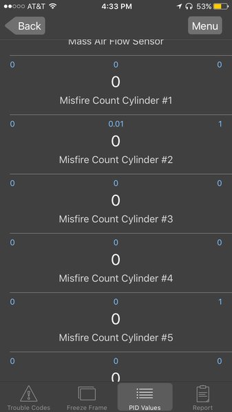

    Alright daily report. Truck, besides the weird vibes during acceleration, is still driving great. Would have got over 23 mpg going home but hit bad seattle traffic the last couple miles. Ended up at a measly 22.0 mpg.
    As far as the OBD fusion, I had a technical difficulty apparently. I hadn't loaded the PIDs driving to work, so the log from my morning commute is useless and then for some reason the app gave me messages saying that it could not communicate with the truck coming home. Log didn't record.
    However, if i'm reading the app correctly, I had a misfire on cylinder #2 and #5 going home. I think the 3 small blue values for any given diagnostic tool display represent the min, mean, and maximum values recorded by the app. This explains why some cylinders read 0,0,0 and the misfires are 0,0,1 or 0,0.1,1.
    OP, please let me know what PIDs you would like to see tracked to compare against. Hopefully we can find a common condition that is causing this. Oh, and you might want to cancel that CPS order :anonymous:
