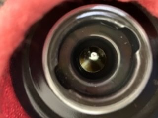

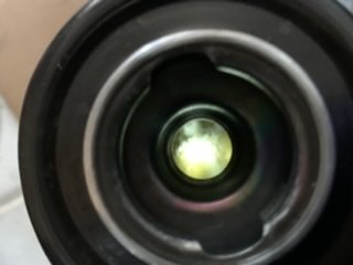

    Finally was able to clean the tank before and after image 0A6D51A5-9DF9-46D1-A8F1-0F4BB5E0AA86.jpg7EC245A4-6F6A-40B9-9E0B-2ED2D3EB561B.jpg it was dirty. The steering feel at first did not really improve, however after driving it for about 5 miles it did get better. The fluid is at the right level.

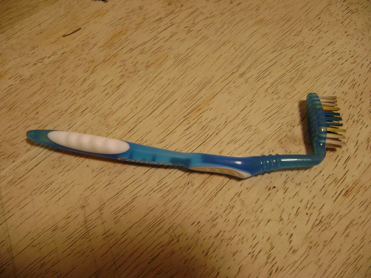

    You will never get all of the dirt out of the screen without pulling the top off the reservoir. I pulled the top off mine a few weeks ago and cleaned it using engine degreaser and kerosene with a took bush i heated up and bent to a 90* angle it got the screen 100% clean. Steering in my truck is great now and the top does not leak after re-bending the tabs back.

    I wholeheartedly disagree with your statement that you have to pry off the top of the reservoir to effectively clean the filter screen. Go to play time 29:39 in the video I linked above and see how clean I was able to get it without pulling the top off. That reservoir screen was very clean, and if I bothered to spend more time with it with another can of brake cleaner, I could have gotten even cleaner. Prying off the top is just making more work for yourself and you risk damaging the reservoir by doing it.

    I watched your video before doing mine. But the opening is so small on the top and it's dished inwards so you if you try to reverse flush it it just ends up allover the top side of the cap and will not run out. I wanted every last speck of dirt out so i took it apart and i don't regret doing it and it does not leak. I tried carb cleaner at first but like in your video it did not do a very good job of breaking up the gunk. I found 1/3 of a can of gunk engine degreaser and it imminently started dissolving the gunk, then i ran out. So i used some kerosene and it worked just as well at breaking up and dissolving the gunk.
    Scrubbing the screen with a bent tooth brush really helped break it up. But even then i spent 10 minutes cleaning it with my thumb over the bottom hole and a short piece of 3/8" rubber gas line plugged off with a bolt so i could scrub the screen while the reservoir was full of engine degreaser/kerosene. And i had to do it 3 times before i got it perfectly clean. The top went back on just as easy as it came off. I only bent the tabs back as far as they needed to be bent and i did not straighten them out. I did not unbend the tab above the return line inlet and when reinstalling the cap i put a little tension on the oppiset side with a pair of vice grips to preload the rubber seal and bent the tabs back.
