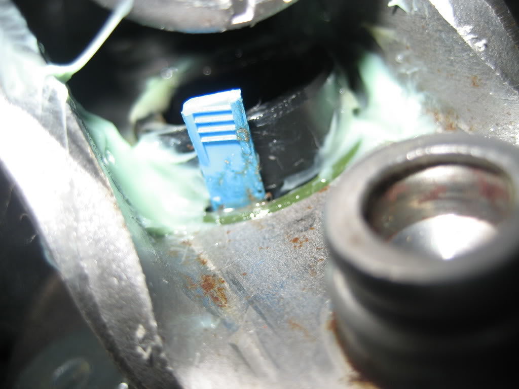

    This is bad (from jlvhrse's thread):

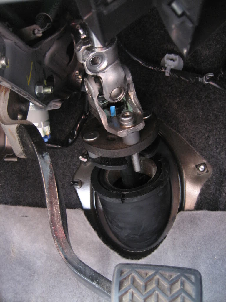

    Get under your dash and pull the cover off the steering shaft (2 plastic finger nuts).
    Grab the shaft and shake it. If it has a lot of play, slop, wobble, yada, yada
    Go here for Toyota 09's Steering column fix (also to see pictures of what I'm talking about)
    Other threads regarding the same issue.
    Steering Rag Joint Mod, Phase-1
    Tightening up steering?
    The Steering Intermediate Shaft Rattle Noise Fix, also tightens your steering
    It'll only take you a few minutes and might solve your problem
    Or you can go pay the stealership to install the updated bushing
    The Blue in the picture is a cut off cable tie taking up the slop in the intermediate steering shaft bushing.......Ta Da, Done!
