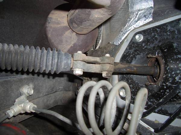

    Could anyone help here?? I bought a 2006 Taco with 40,000 miles of mostly highway. No if any offroad miles. I use my taco for geologic exploration in extreme offroad conditions. From the git go, I noticed a "clunking" noise that I could feel through the steering wheel. At first, I suspected a loose shock, since that is exactly what the clunking noise sounded like. After much inspection and checking tightness of all bolts, I have come to a conclusion.
    It seems the offroad clunking comes from loose steering linkage. After much investigation, I have narrowed it down to this. The key line of evidence is... When the vehicle is turned off, when I move the unlocked steering wheel left and right, the SAME clunking noise is heard. So to me, the problem is loose steering linkage.
    I have a collegue with an '09 taco. He also has some slop in the linkage, but not as much as mine. He is aware of a "metal to metal" feeling in the linkage offroad and is not comfortable with it.
    My question is this... How can I tighten my steering linkage?? Is this something I can do or do I need to take it "in$$"? Please, someone help. I need this truck for my offroad duties and want to feel comfortable with the clunking noise.

    Chris states that the off-road "clunk" is normal and not to worry. He believes it is due to the soft rubber bushings on the steering rack. I can duplicate the "clunk" by turning free play in the steering wheel with the engine off. That is why I believe it is in the steering linkage. Off-road, when bumps in the road make the front end clunk, I can feel it directly in the steering wheel. So the steering linkage is related to the clunking sound. It is still a concern to me.

    Being as it is hard for me to tell the severity of the clunk in your truck over the internetz, I originally figured it was the normal "clunk" people feel when offfroading. Since the sound can be re created with the truck standing still, Im thinking you may have a loose slip joint in the steering linkage.

    Chris, is this something I can tighten? I am somewhat mechanically minded and have most tools. Or is this something I should take in to the dealership? Thanks for any comment you can make on this.

    Yes. There are 2 under the hood. One closest to the firewall:
    And one closer to the steering rack:

    Chris, thanks for going the extra step with photos. A picture tells a thousand words!!! I did stop by the dealership and voiced my concern to the service manager. He too has driven Tacos off road and knew exactly what I was talking about. His comment was exactly like yours. Tacos clunk off road.
    I will check linkages you showed me and will again thank you for your diligence. THANK YOU!!!

    I checked both linkages and found them both to be tight with no play. Guess I will have to get use to the "Taco Clunky" Thanks again for your help Chris.
