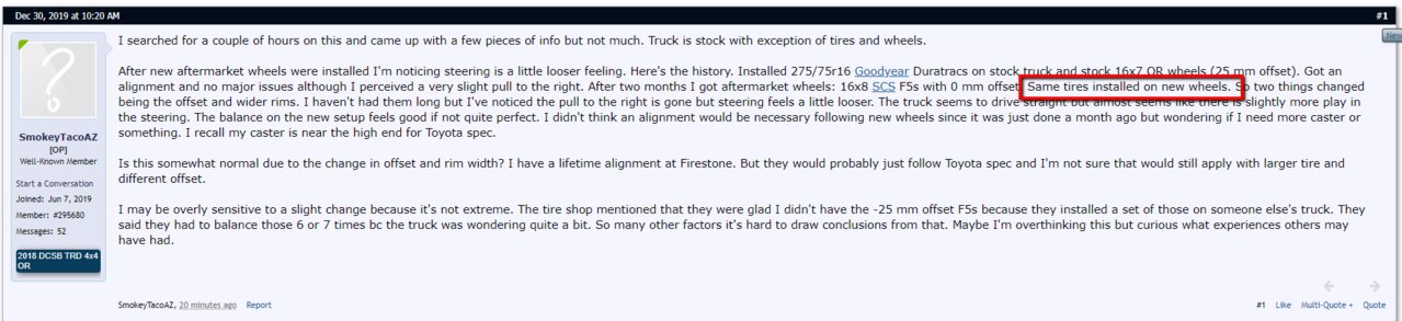

    I searched for a couple of hours on this and came up with a few pieces of info but not much. Truck is stock with exception of tires and wheels.
    After new aftermarket wheels were installed I'm noticing steering is a little looser feeling. Here's the history. Installed 275/75r16 Goodyear Duratracs on stock truck and stock 16x7 OR wheels (25 mm offset). Got an alignment and no major issues although I perceived a very slight pull to the right. After two months I got aftermarket wheels: 16x8 SCS F5s with 0 mm offset. Same tires installed on new wheels. So two things changed being the offset and wider rims. I haven't had them long but I've noticed the pull to the right is gone but steering feels a little looser. The truck seems to drive straight but almost seems like there is slightly more play in the steering. The balance on the new setup feels good if not quite perfect. I didn't think an alignment would be necessary following new wheels since it was just done a month ago but wondering if I need more caster or something. I recall my caster is near the high end for Toyota spec.
    Is this somewhat normal due to the change in offset and rim width? I have a lifetime alignment at Firestone. But they would probably just follow Toyota spec and I'm not sure that would still apply with larger tire and different offset.
    I may be overly sensitive to a slight change because it's not extreme. The tire shop mentioned that they were glad I didn't have the -25 mm offset F5s because they installed a set of those on someone else's truck. They said they had to balance those 6 or 7 times bc the truck was wondering quite a bit. So many other factors it's hard to draw conclusions from that. Maybe I'm overthinking this but curious what experiences others may have had.
