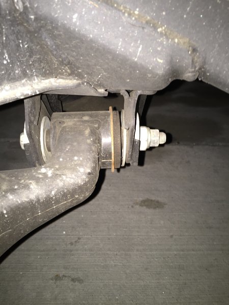

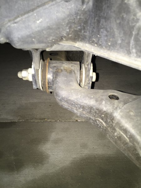

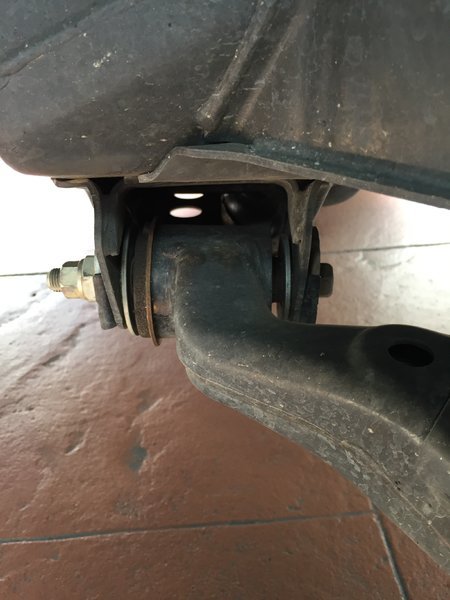

    I have had a persistent problem with steering wander on my 2014 tacoma. It appears there are gaps where the LCA bushings are supposed to be tight, and perhaps even missing bushings. Any insight you can give from these photos? Surely there shouldn't be gaps...

    Thats how those bushings are from the factory. Its normal to have that gap.
    What are your caster number (really all alignment numbers)

    Wouldn't the gaps allow the Lca to move? I am not just talking about no bushings existing on the front - also gaps on the rear side. Don't these need to be snug?

    6 lug LCA bolts torque to 100ftlbs.

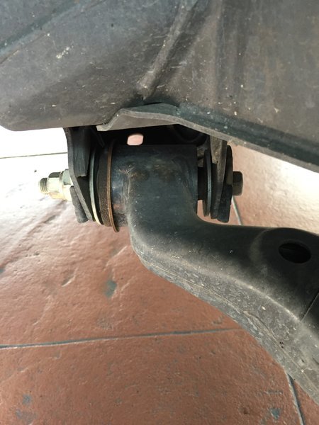

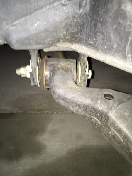

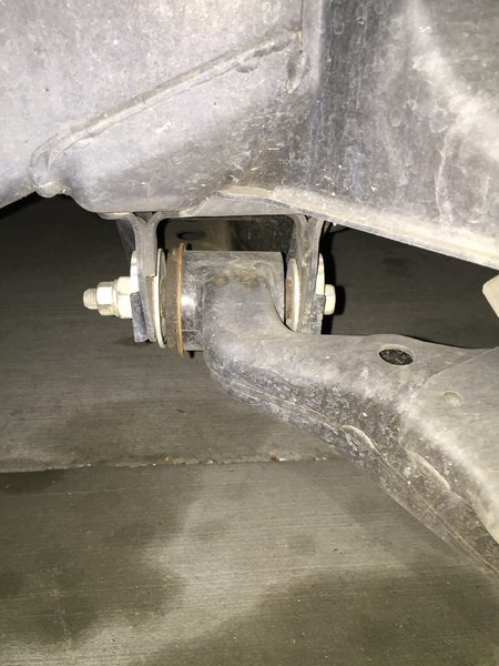

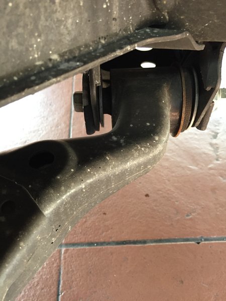

    OP the bushings in the stock LCA's are bonded, that is the center sleeve is bonded to the rubber so its all one piece. They will move forward n back a bit by nature but not anywhere close to the gap. And they way they are oriented with the big gaps facing eachother on the inside the lca cant move forward or back unless it compresses the big rubber.

    I have a 2WD Prerunner sport. The bushings should not be separated, correct? And they are aligned or stacked improperly? (Explain: "And they way they are oriented with the big gaps facing each other on the inside the lca cant move forward or back unless it compresses the big rubber.")

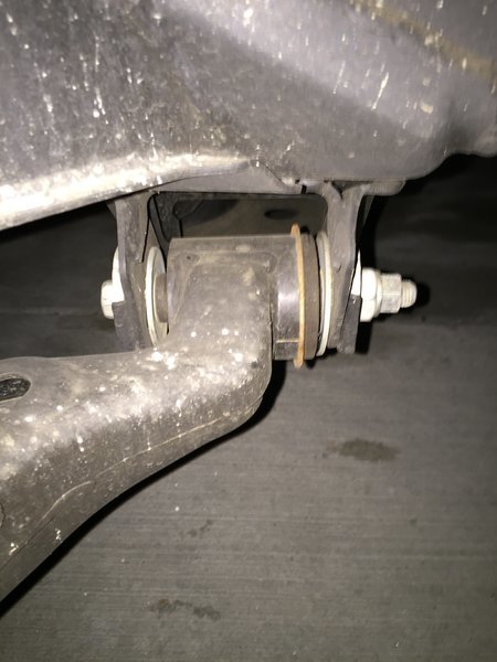

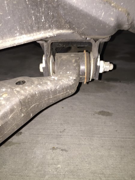

    Two more looks at the lca bushings and configuration. Can't be right. Help me explain what's wrong. Gracias.
