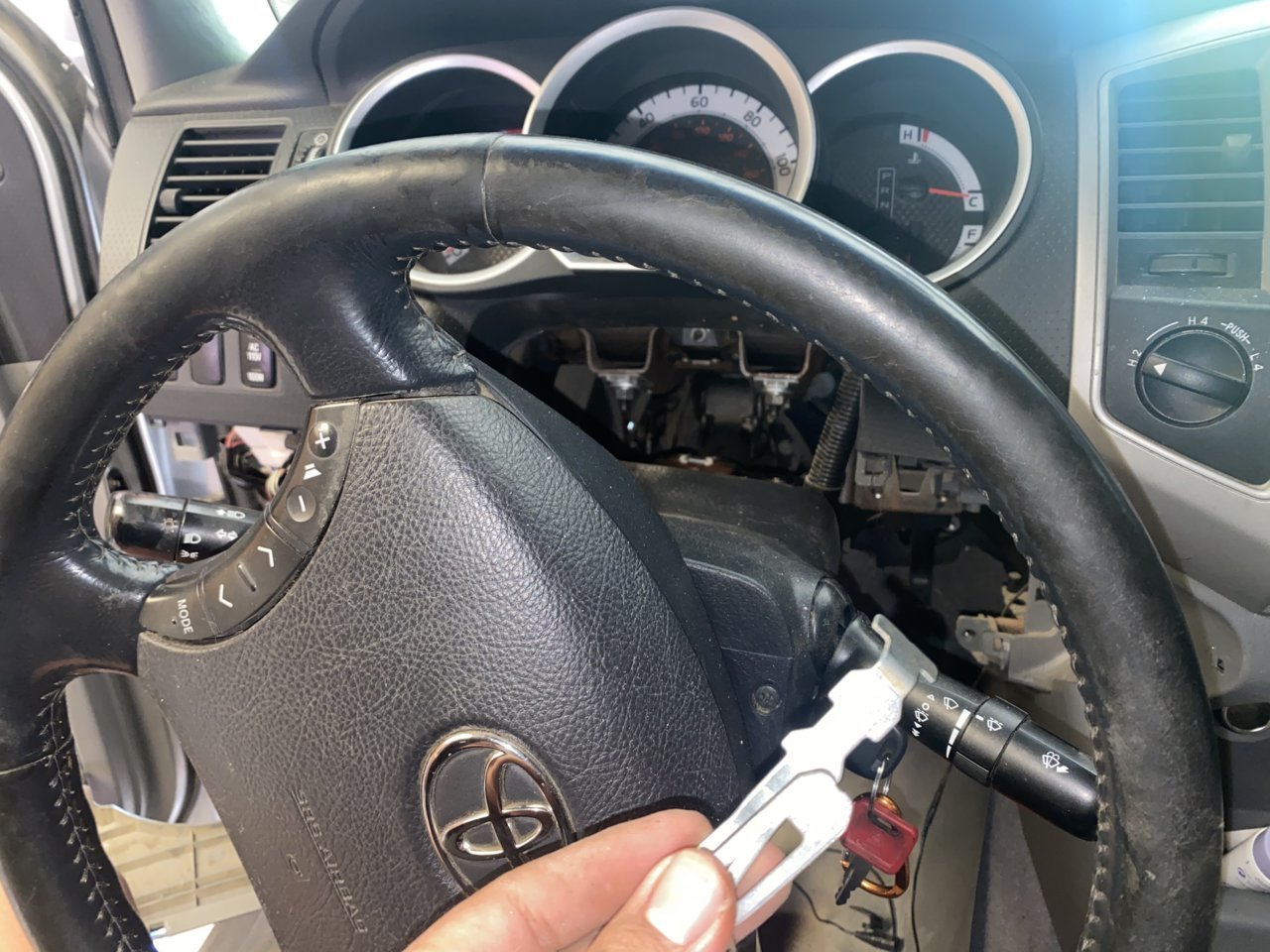

    My steering wheel came off how do I bolt it back up?

    Some pictures

    Yeah there’s no “bolting it back on”. Metal has snapped. You should be able to look at the back of the wheel assembly and see the raw metal that should match up with raw metal on the column.

    The steering column is designed to collapse in the event of a collision, it looks like something caused it to collapse unintentionally or it was installed incorrectly. I'm not sure if it can be put back on the mounts or not but I think it can be.

    It is fixable, but a real pain in the @ss to get it together. That piece you are holding is supposed to prevent what you have from happening so first you need to get it reinstalled. So something happened to force that piece out of its designated location.

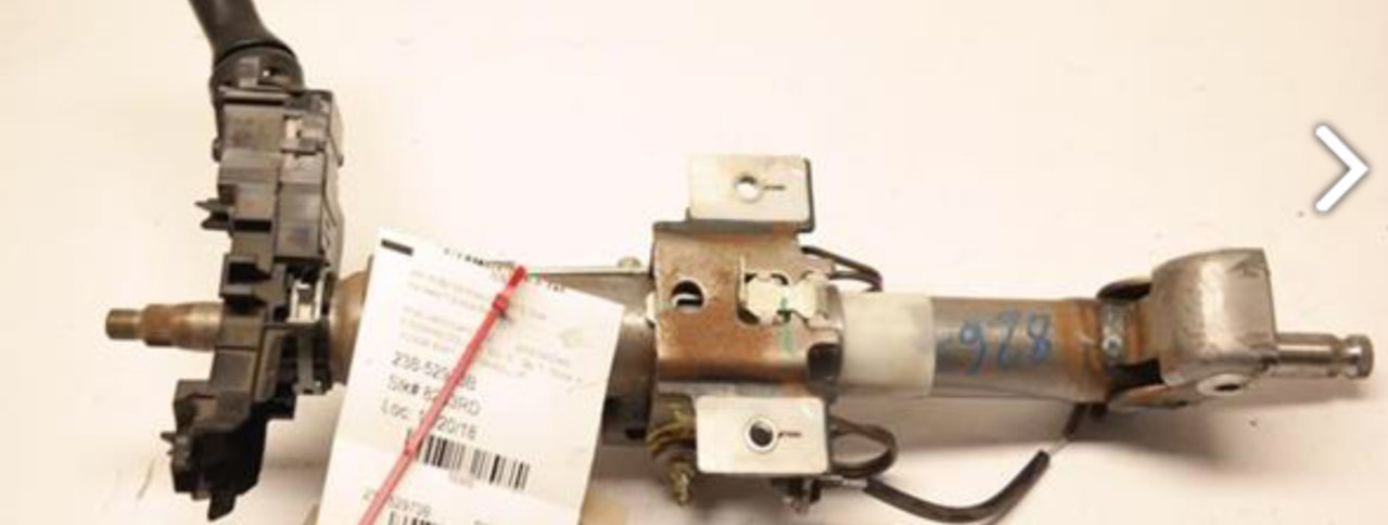

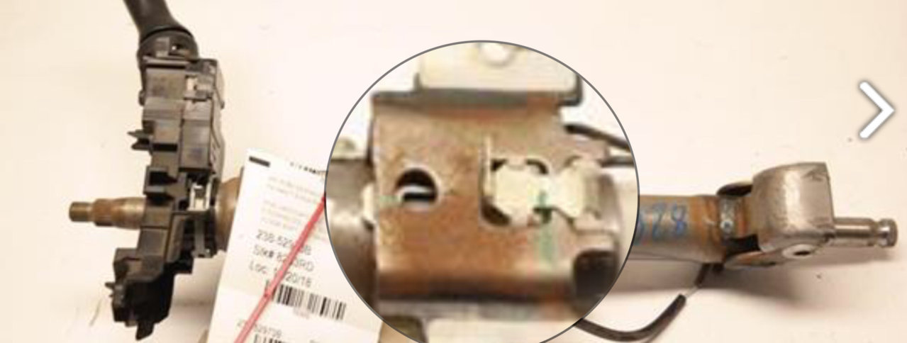

    I’m trying to figure out how this works?
    I believe that the 2 pieces that are plastic with nuts - are the slides and the limit stop for the up movement of the tilt/slide?
    The metal piece that fell off, is the down travel limit stop?
    And for the wheel to fall of and out of the slides, you need to have the tilt latch unlocked and the metal stop not in place. (Fell off or broken)
    Or have the slides physically break off?
    I’m also interested in how the metal piece that fell out is attached.
    It looks like it just slides in and snaps in place by retention?
    I think it’s probably NOT a good idea to use the steering wheel as an aid to pull yourself into the truck.
    That can’t be good for it at all!

    If you loosen the latch and jam it downward with enough force the limiter will pop out and you end up with the wheel in your lap.

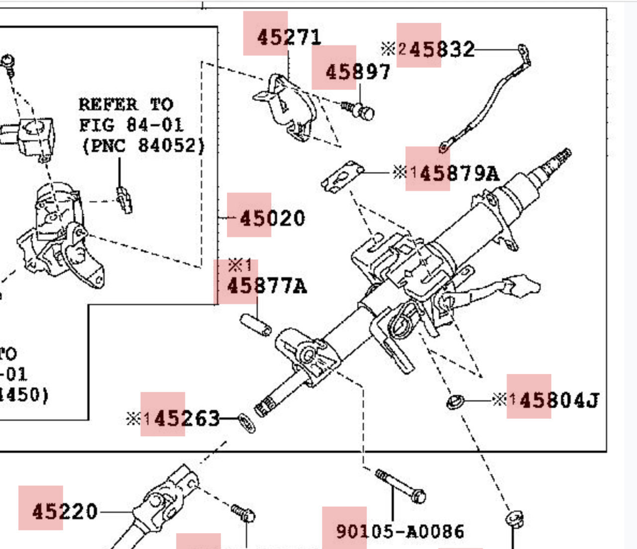

    I took a peek at the parts manual and it calls the section in question as being the Steering Column Assembly and shows the following events and part number change:
    45250-04220 05/2008 - 08/2011
    45250-04221 09/2011 - 07/2015
    A note appears that says the 45250-04221 part is the replacement for all 2005 - 2015.

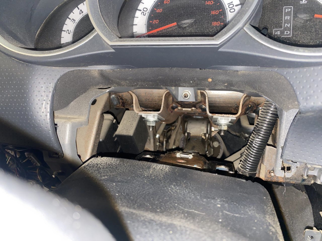

    Unfortunately this is a relatively common Tacoma issue. Most experience steering wheel slop or play, vertically. Mine had the same issue. Pull the plastic covers, remove 1 of the 2 nuts (which will be loose), add some Loctite and reinstall the nut. Repeat on the second nut. I had about 1.5" of vertical play before the fix. This procedure eliminated all movement.
    Best of luck.
