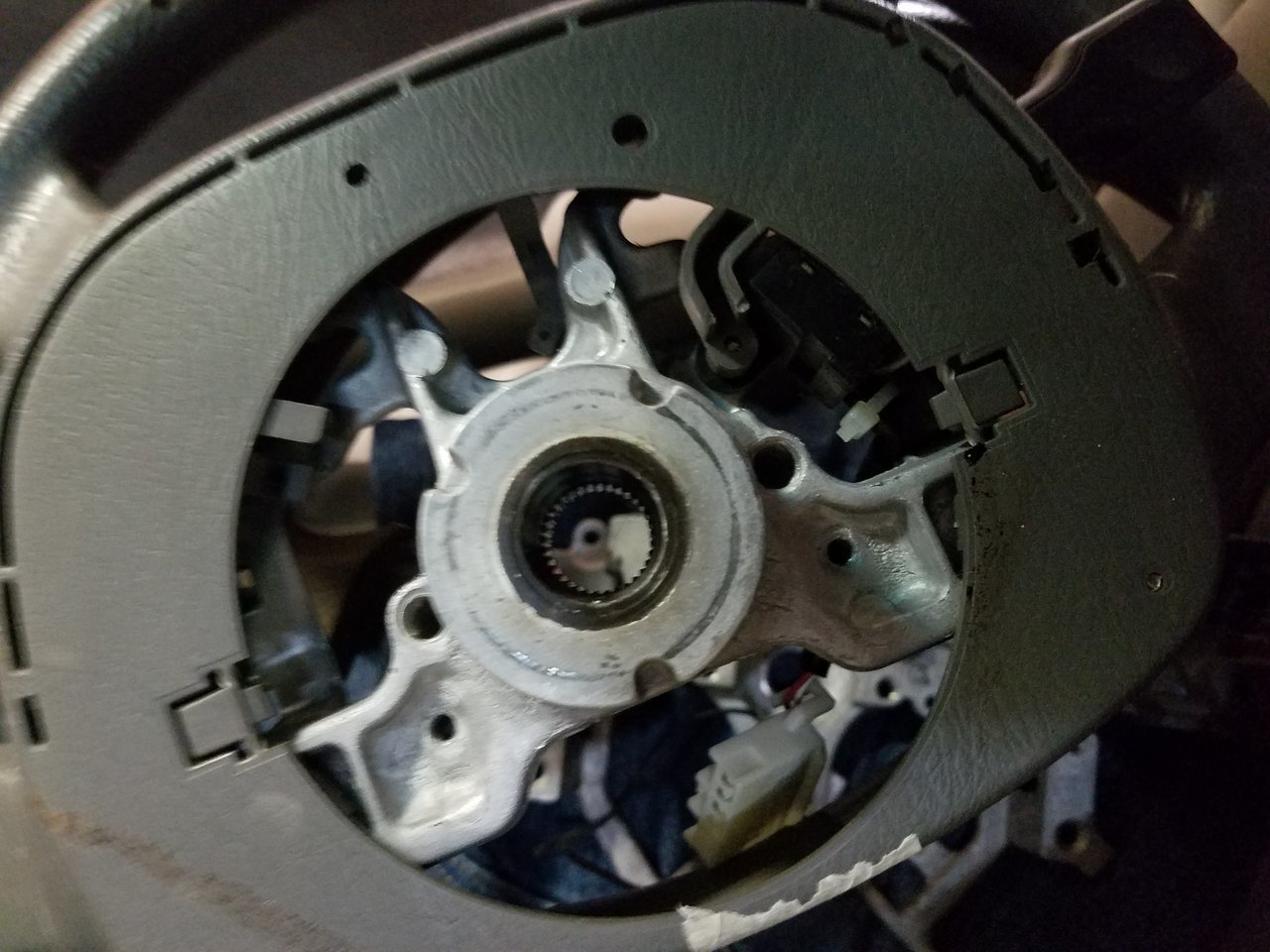

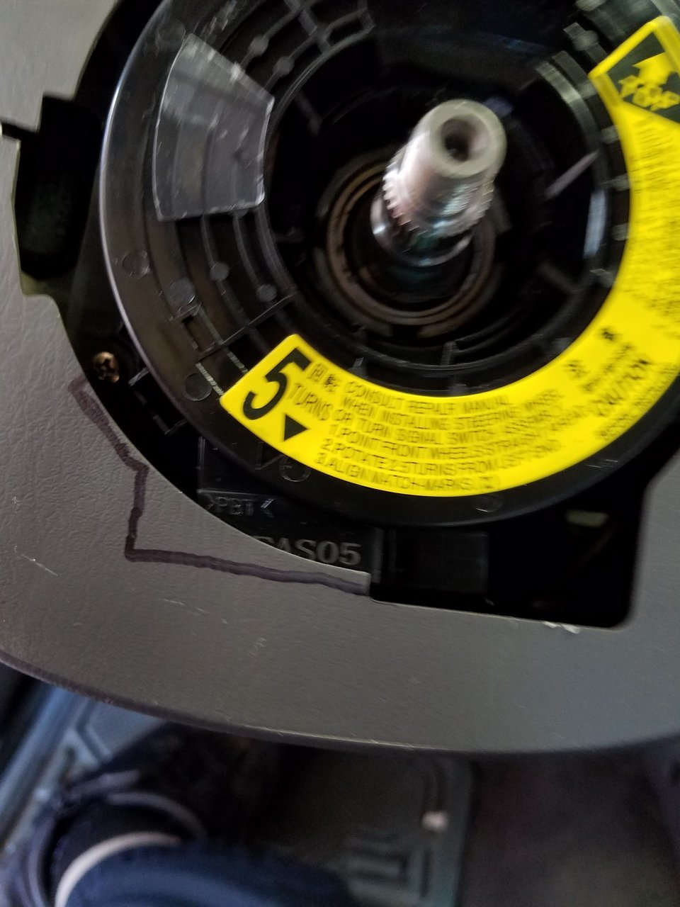

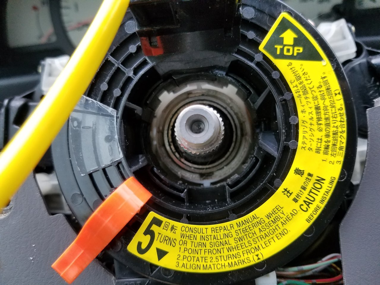

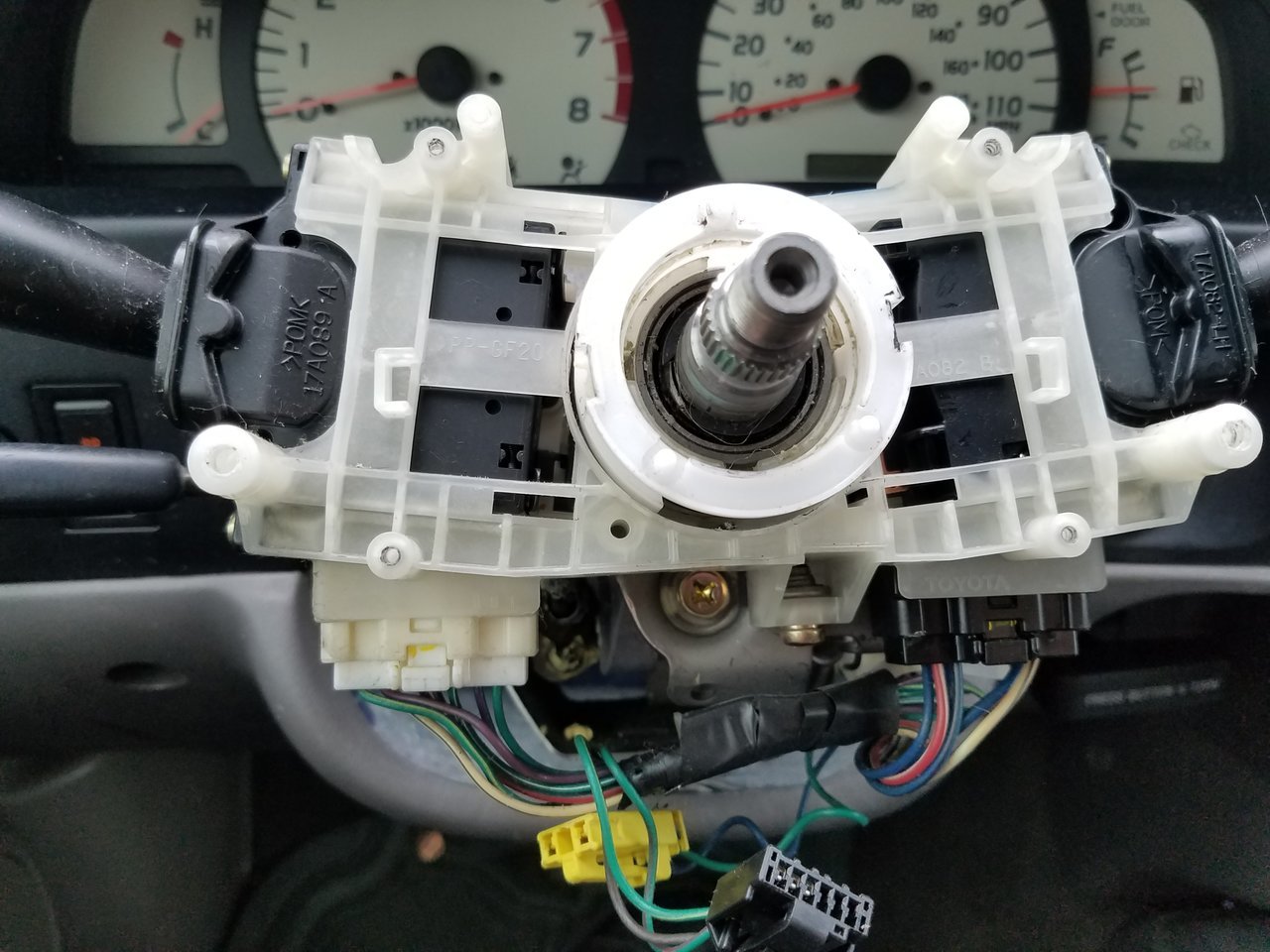

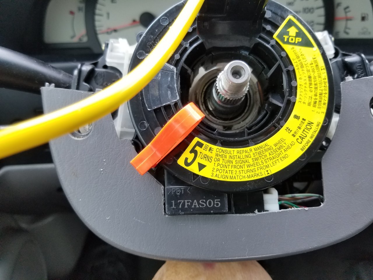

    A teaser. The cancel cam needs a little triming to work with new clock spring.
    Before:
    After
    New cancel clock spring with cam and trimmed cover.

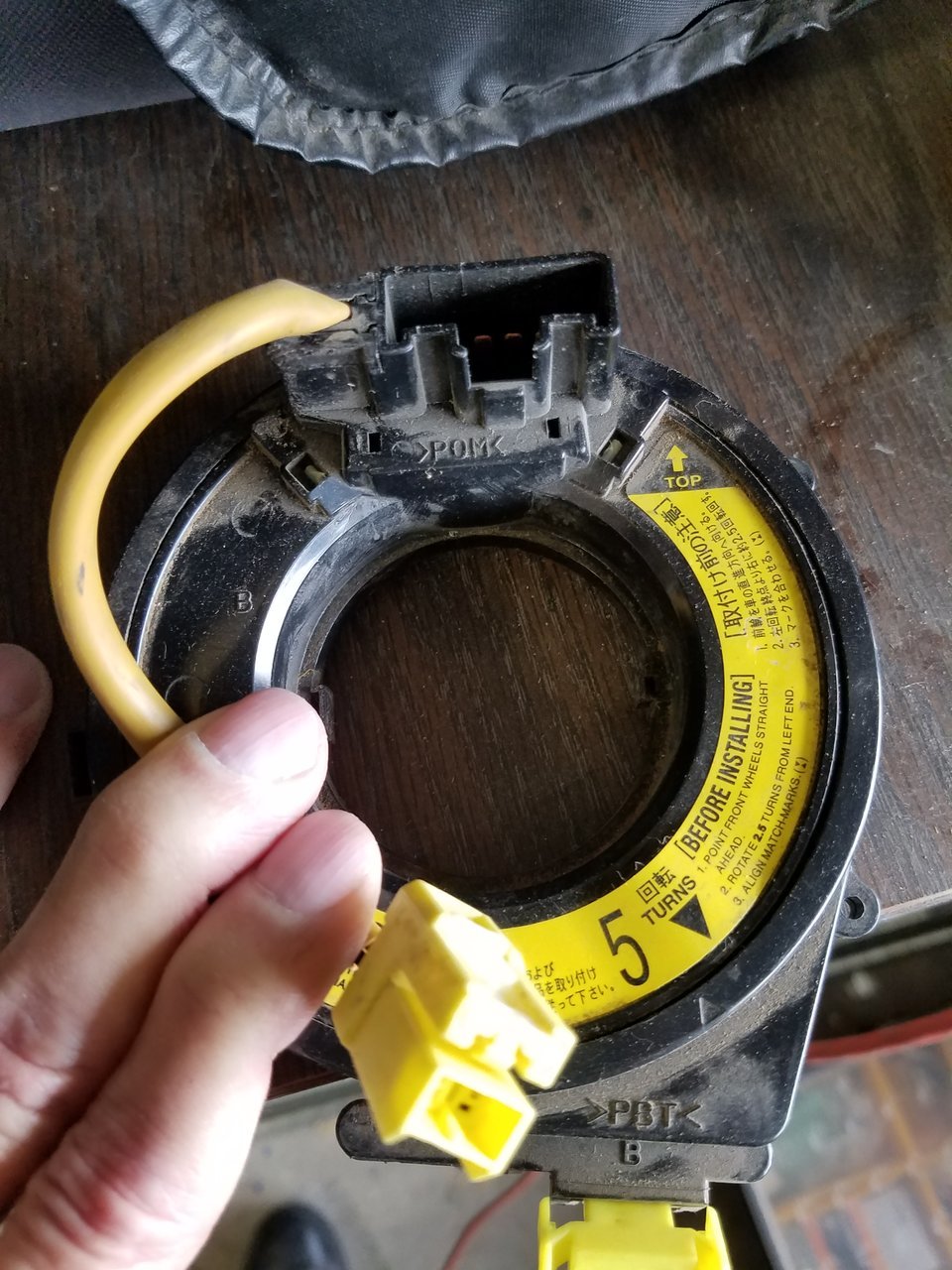

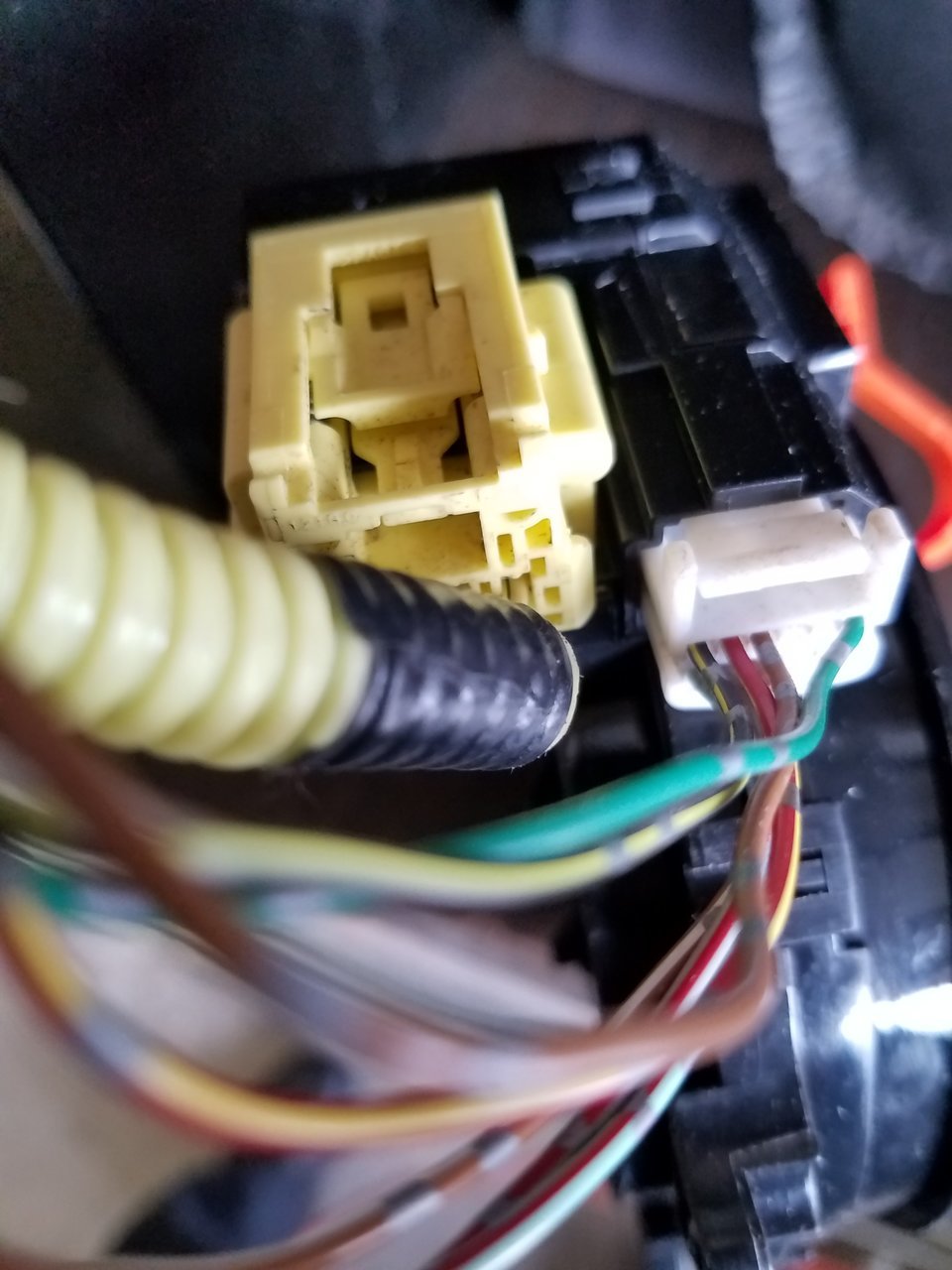

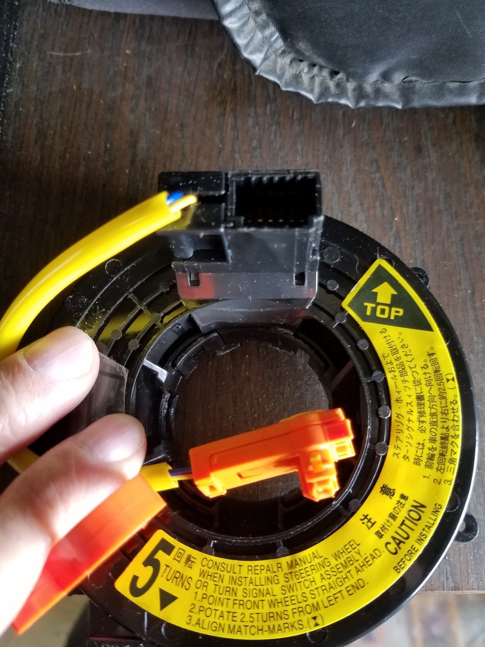

    John, do you have a picture of the airbag connector on your stock clock spring? I put my new wheel on today BTW, cruise control plugged right in which was neat and so did the horn. Kinda strange that your clockspring is only a 5 turn unit, mine is a 6.

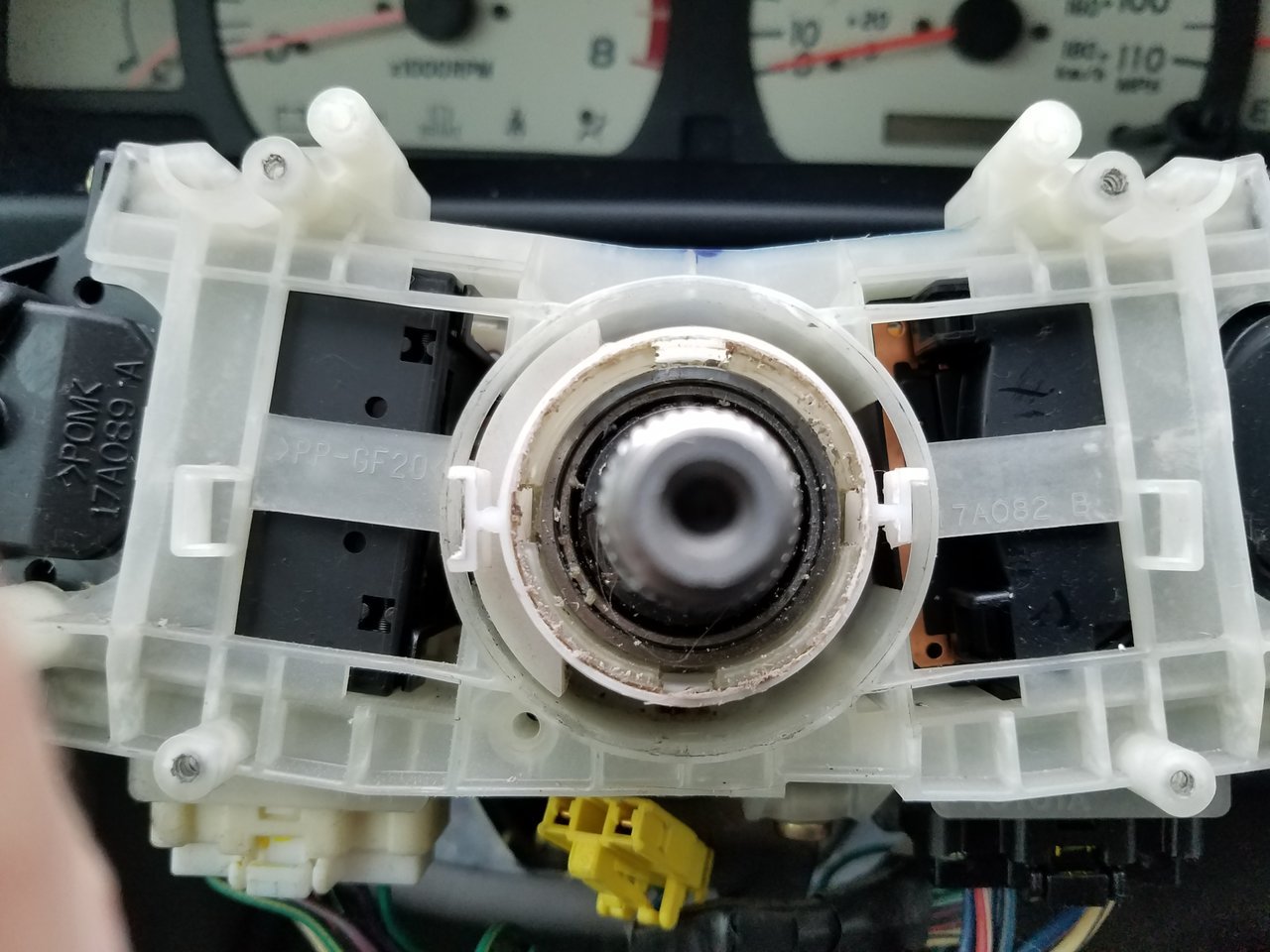

    The steering wheels are differant on the back, as far as what turns the clock spring and cancel cam.
    Old
    New
    I'll get that picture for you @Speedytech7
    Speedytech7 likes this.

    Interesting, so you have the airbag connector I need for my new steering wheel, I guess my clockspring is just too old. The other connectors look the same though, wonder why they only changed that. Thanks John
