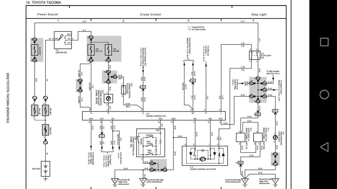

    Look for the cruise control switches in the two diagrams. You will see that the older Toyotas use dedicated wire for the on/off function.

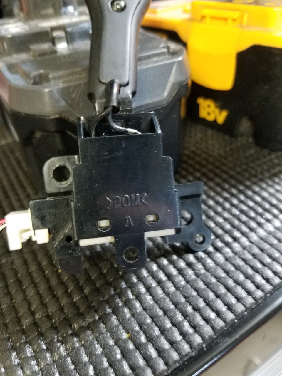

    The new cruise switch I has three wires. I disassembled it and found one wire wasn't used. When I compared ohm readings to my current one they were identical. So I should be able to repin the plug. My 2004 switch only uses 2 wires.

    By the switch diagram you could just tie the 3rd wire into the other wire.

    I've come up with a work around for this issue. The 3rd wire is for the on off of the cruise control. If you look at the back of the stalk. Those two wires are for the switch. Just cut the wire that is not tied into the ground part of the switch. Extend that wire with solder and shrink wrap the connection.
    There's you third wire.

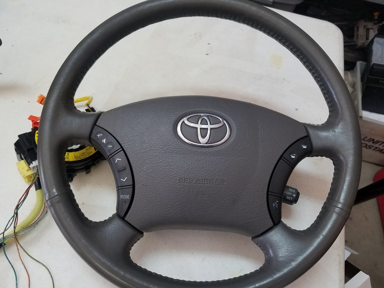

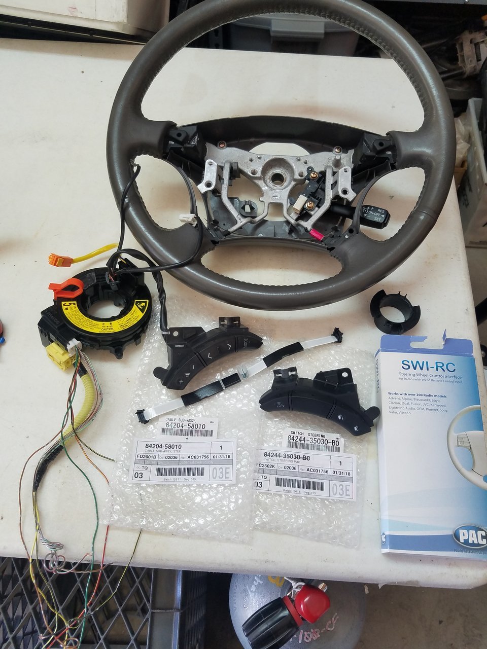

    I've collected all the pieces. Time to commece with the upgrade.
