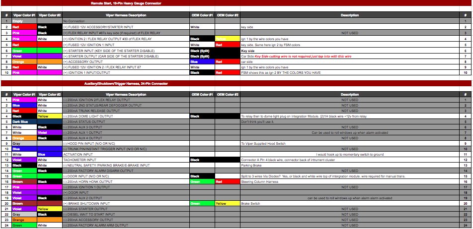

    I have a spreadsheet and I just got lost in the amount of wires I had to splice. This is about half the wires on my spreadsheet.

    5,285
    Our 1st gens are simple, don't really need a whole lot from the alarm wiring. Now if you're adding additional sensors thats a different story, but still possible to do because they are all ground triggers.

    Everything is straightforward besides splicing into the ignition wires for me. It's a little confusing

    simple, there's only 1 wire to cut and the others are tapped in.

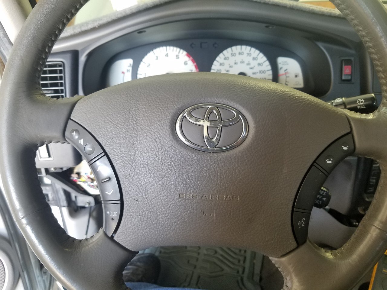

    Awesome! Looks great too! Just to be clear, you are using a 2003 Sequoia steering wheel, airbag, and click spring, correct?

    Yep

    Oh and the cancel cam for the turn signal. You can make the original one work but it's hokie.

    The hard part to find will be the single stage airbag. It only came in the 2003-04 Sequoia and Tundra. There's a handful on ebay for sale.
