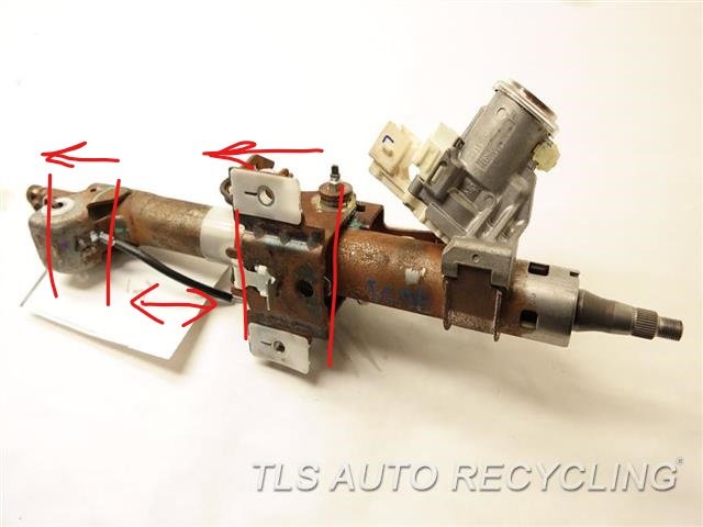

    Maybe chop mounts extend the tube and slide those mounts down? Thoughts?
    I mean with this much work I think working on a traditional spacer would be easier.

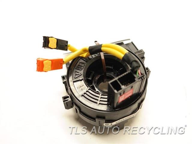

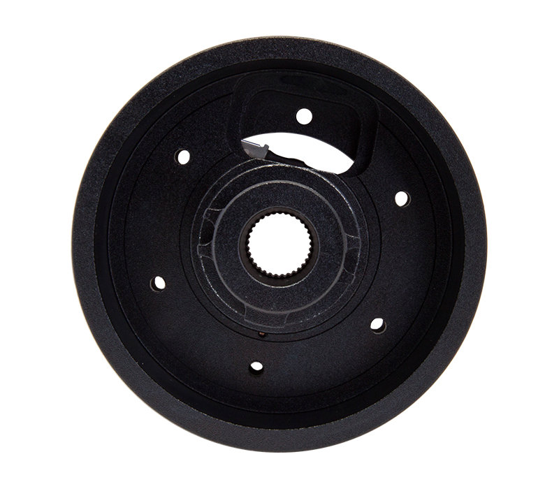

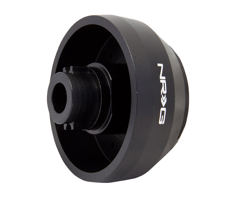

    Here is the 2016 clock spring and hub that nrg has for 05+ looks like it might work.
    292015_02.jpg SRK-125H-03-780x700-780x700.jpg SRK-125H-04-780x700-780x700.jpg

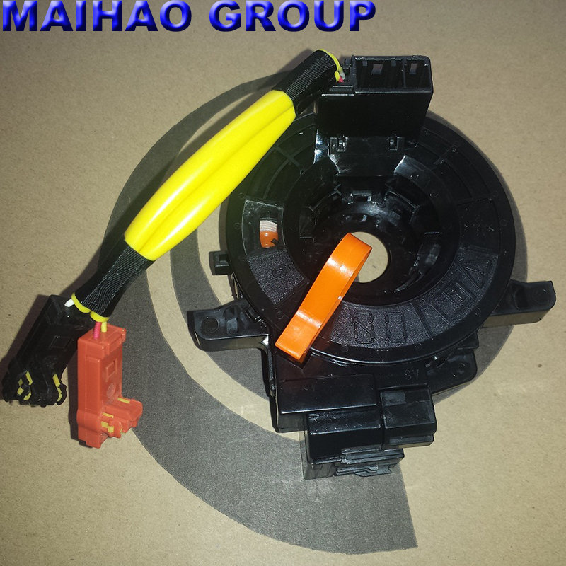

    Here is an 05 clock spring.
    Clock-Spring-Airbag-font-b-Spiral-b-font-font-b-Cable-b-font-84306-48030-8430648030.jpg
    Here is the 16 clock spring. Looks pretty damn close.

    So the only issue is... the splines on the column, are they the same for the 05 and the 16? If so the nrg hub for 05+ SHOULD work on an gen 3.

    Not that easy, you have the tube part of the column, you also have the steering shaft inside it. The steering shaft has some kind of slip joint in it to make up the difference in length when the column is extended or collapsed. Either the slip in the shaft as well as the slip in the column need to be extended to have more slip of an equal amount, or the entire assembly needs to be extended (both the shaft and the column) making both the extended and collapsed positions longer.

    I agree too many issues for this.

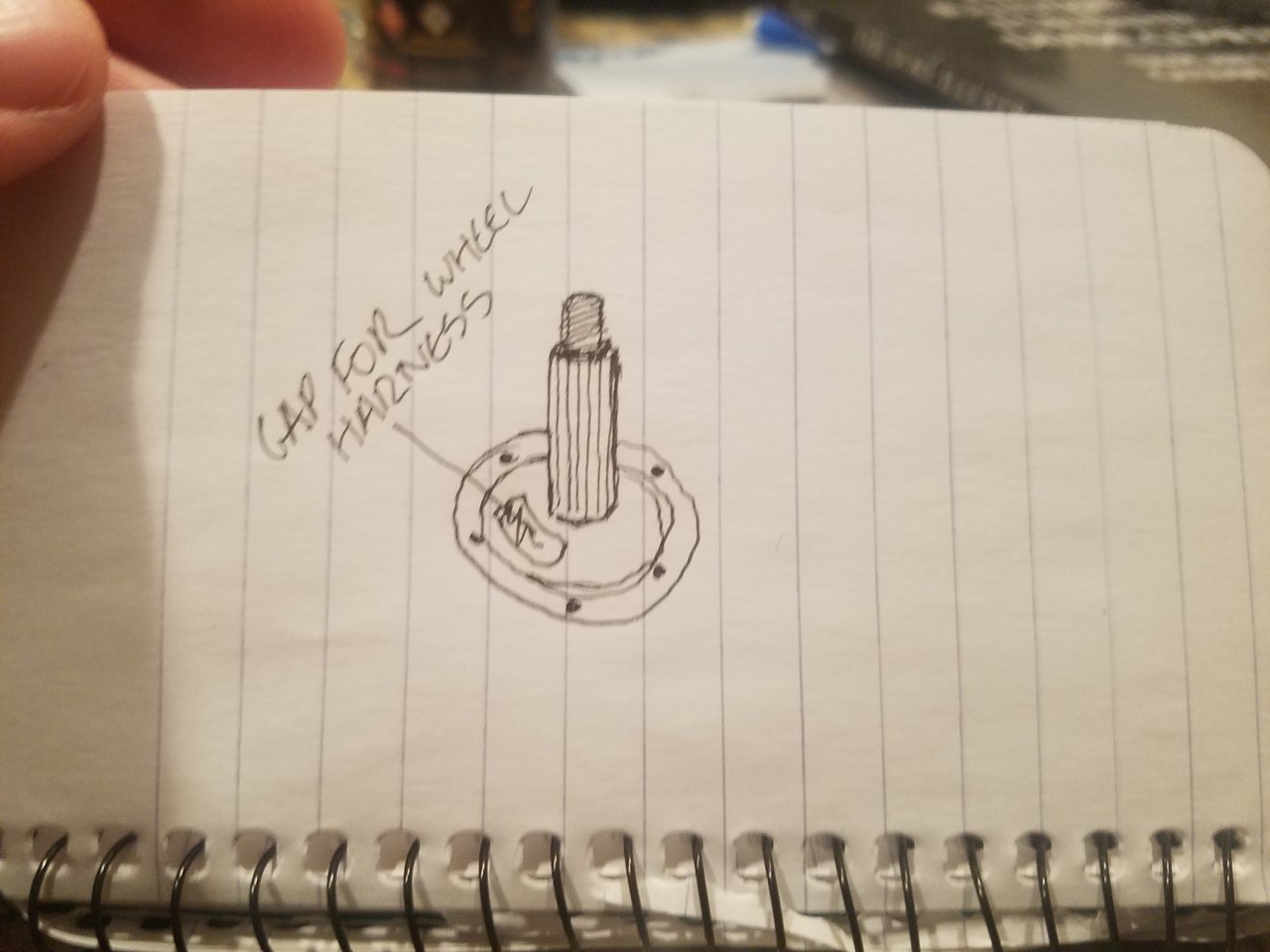

    I'm going with option 1. Make a two piece adapter utilizing a nrg hub as the 1st piece then extend the airbag and wheel harness. The second piece I will have to get machined. I emailed nrg to see if they tested their gen 2 hub on a 3 yet. I offered to guinea pig for them. Might just order one up next week and try it out either way.

    So again this is what I need to make. I will take some measurements this weekend.
