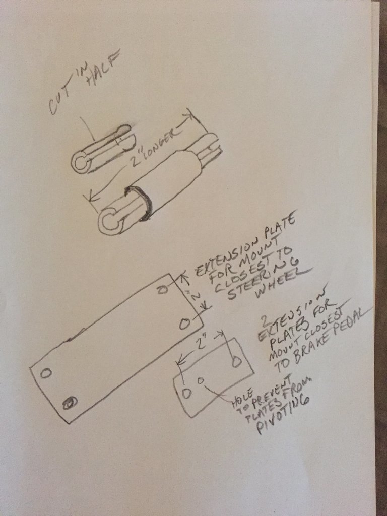

    Looks almost too easy

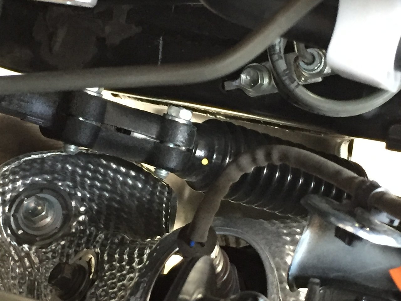

    Extend under hood here at the coupler ( cut coupler in half, weld tube your desired length between halves)IMG_8604.jpg
    Or in the interior here (cut shaft weld tube in )
    Then extend your other mounts
    SandTaco138[OP] likes this.

    BUT if that spacer doesn't work
    Figure out how much you want to extend it, (for this example and my pencil drawing let's say 2"- but it could be whatever) Buy another coupler extend it 2" (if you want send it to me I'll extend it and send it back :D)
    The rest is extra nuts and bolts and flat stock with holes drilled at whatever extension length you decided
    All easily reversible - unbolt plates put stock coupler back in
    All your getting is a quick pencil drawing my youngest kid is 16 and ate all of my crayons years ago

    I can def see that working. Will have to keep it in mind.

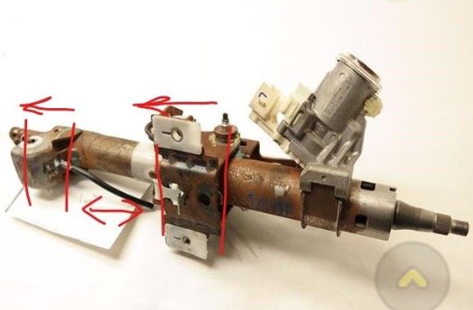

    Based on some of the suggestions, I'm not sure everyone knows what parts telescope and what parts don't. Only the red part moves and it is only allowed to move as far as the slots in that mount allow it (one for tilt and one for telescoping). The telescoping slot is really only visible on the back side of this diagram. You can see it in the quoted pic facing up (the 'bolt' is actually stationary and the slot moves).
    So, some section of the 'red' part has to be extended (or the mount moved, but then the locking lever would move and you would instead have to extend something else).
