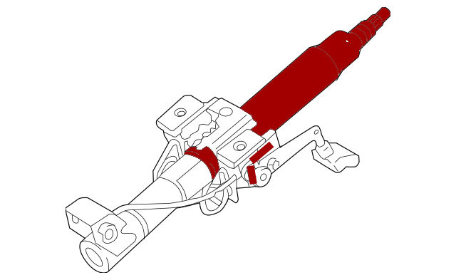

    Maybe I'm missing something, but yes the tube telescopes but the shaft inside is what allows the distance for telescope and it is 2 mated pieces. If you just extend the outer tube the shaft will come apart inside and you will lose all steering.

    Maybe you're the first person that isn't missing anything... myself included.
    I don't if any of us know what the inside looks like. Hopefully after extending the outer sleeve ("red part") then you could just extend from the lower joint (the part that "almost looks too easy").

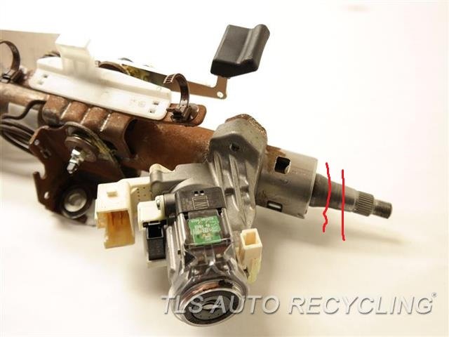

    I do know what the inside looks like...I make these steering columns for a living.
    I think the best option if you're willing is to cut in this section and weld an extension here.
    Modifying your steering column in any way is VERY risky. You and anyone else on the road with you will pay a price if your weld breaks because you WILL lose steering. Me, I'd just live with being kind of uncomfortable.
    @SandTaco138 My guy says that the splines are the same.

    If you slide it all the way, would it be hard to put back together? Can you show us what it looks like when pulled apart?
    Good to point out the safety aspect. I would be concerned of it collapsing in an odd way in a frontal crash... there's not nearly as much stress on it from steering... but if you're heavy and yank it everyday to get in???
    If I am seeing it correctly (it hard to see)...
    If you want it to come down a little bit more, it looks like you might be able to add a washer or two at the upper mounting bracket without affecting safety too much. (You might be able to do that to the lower mounting bracket to move it up a little.)
