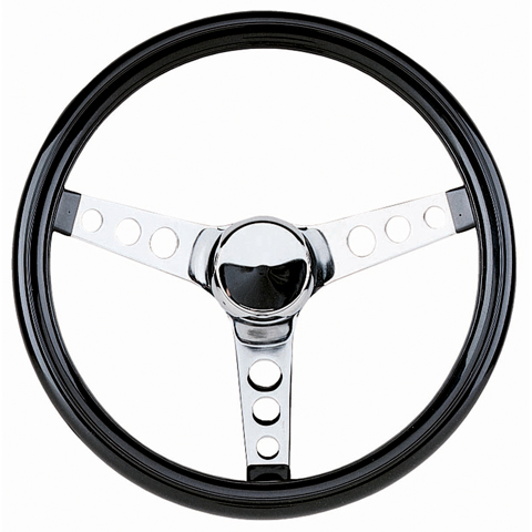

    Hello everyone. I have a toyota tacoma 98 2.4L DLX. I recently got a grant steering wheel to install on my truck. but I have no idea which hub adapter would work to fit that steering wheel on my truck . Does anyone know where i can find the right one?

    I did this a while back. You just need to get an adapter for a '94 pickup, it's the same spline count.

    image.jpg That or one from an 80 series land cruiser. I as well have gotten rid of the gross massive stock steering wheel. I used an NRG hub, with the new Gen 2 quick release and an OMP Corsica suede wheel (330mm)

    i've been trying to look for those. but cant find a website that sells those. I even tried contacting grant services. Where did you get yours from?

    Thanks for the help. I got installation kit from pepboys for 94 pickup and it worked pretty good. little hard to put it on but works perfect. Thanks again.

    you could either get a steering wheel with it's own horn mechanism designed into it, or relocate to a push button off to the side.
    I had this one from grant on my 76 superbeetle. the cap in the center depressed as the horn mechanism. just a single wire design. worked great.
    or the relocating option is to use a simple push button of any sort that will do the job.
