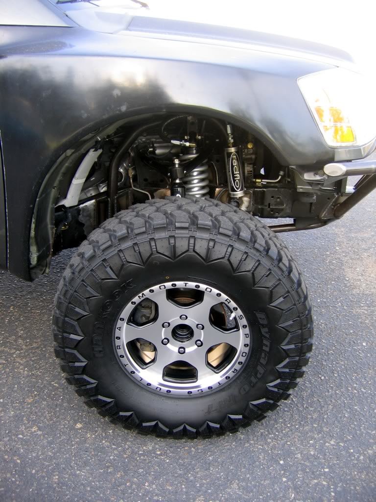

    HANKOOK Dynapro MT ;) My next tire!

    How you likin em? My buddy works for a tire place and can get me a set for $800. They got great ratings and have heard nothin but good things about em.

    They are great . A little noisy at highway speeds , good in the wet snow I get here .

    Nice! How would you compare them to Nitto Trail Grapplers? Are they noiser?
