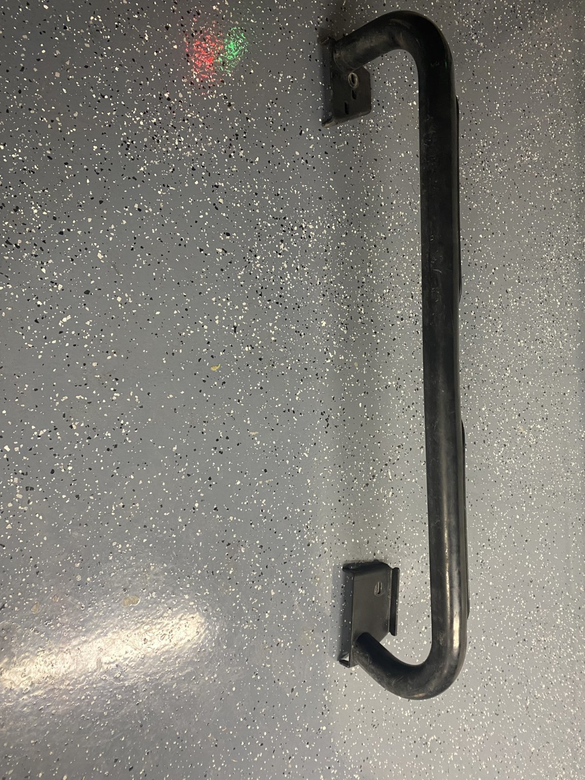

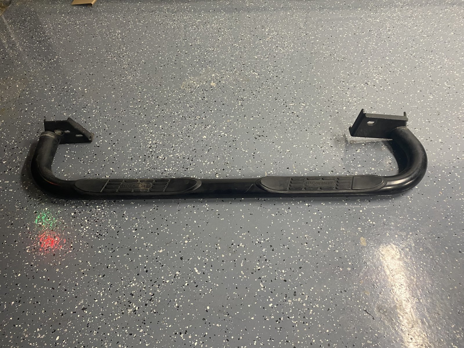

  15. Dec 20, 2023 at 4:13 AM
    sanchemv
    sanchemv Member
    Dec 19, 2023
    #439895
    5
    Max
    2005 Blue Tacoma Access Cab
    @johneman....do you still have your Tacoma because i just bought some frame bolted side steps and they seem to be off a bit unless I am missing something. I have an 2005 Tacoma Access Cab as you have in this picture and know its an old post but just trying to find some help.
