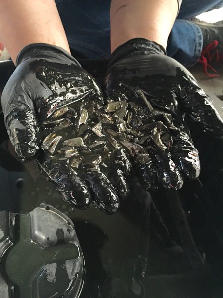

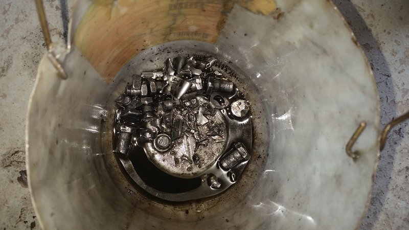

    Replacing my diff for the second time in 30 days ............. Smh image.jpg image.jpg

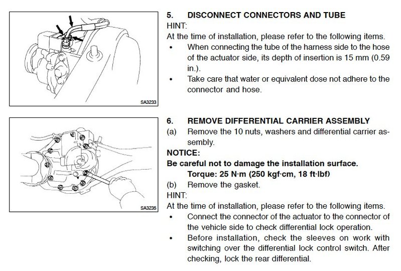

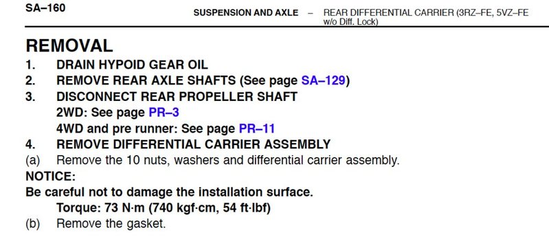

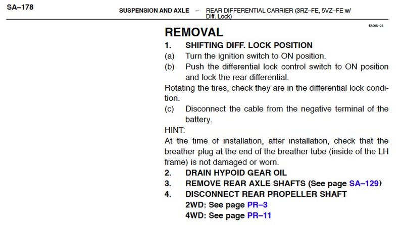

    Seriously different torque specs for the carrier nuts between the with E Locker and Without
  8. Jan 27, 2016 at 1:21 PM
    #268
    MonkeyProof
    MonkeyProof [OP] Power Top
    Oct 7, 2008
    #9774
    12,851
    SoCal- SGV
    All values I mentioned were from the 2005+ Tacoma FSM and not from an older version that you are referencing to.

    Woah easy boy. OLDER?
    It's just the First Gen. Respect
    Either way I was wrong. :D

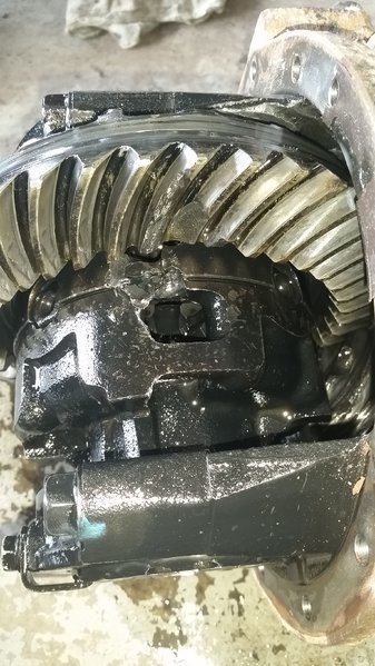

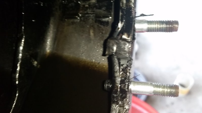

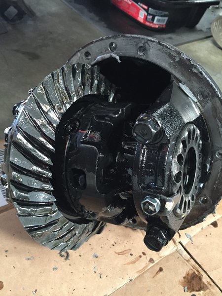

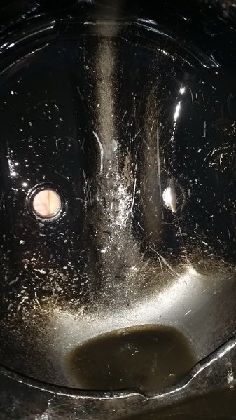

    any of you guys have all the ring gear bolts come out blow up the ring and pinion
  15. Mar 14, 2016 at 9:42 AM
