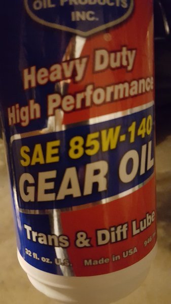

  6. Mar 9, 2017 at 12:40 PM
    #306
    anthony250f
    anthony250f Well-Known Member
    Feb 18, 2012
    #73066
    16,750
    Anthony
    San Diego, CA
    2008 dcsb trd offroad 4wd
  7. Mar 9, 2017 at 1:02 PM
    #307
    deeezy
    deeezy Well-Known Member
    Sep 1, 2013
    #111645
    5,253
    Dana
    Hawaii
    2013 4x4 DC, 6 spd, TRD Sport
    King ext travel coilovers, Icon tubular UCA's Rear-King "Tundra" 2.5's, Allpro Expos, TRD cat-back, Hurst/Core short shift kit, etc...
    That's the one ECGS requires us to use.
    Rakso[QUOTED] likes this.
