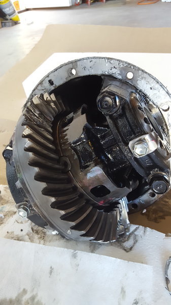

    Does anybody know the part# for that broken stud?

    Nice! I haven't seen damage happen like that on a ring. Your photo looks like you used Garlock as a gasket, what is it? I am waiting on my parts from ECGS also. Trying to decide on what to use for a gasket.

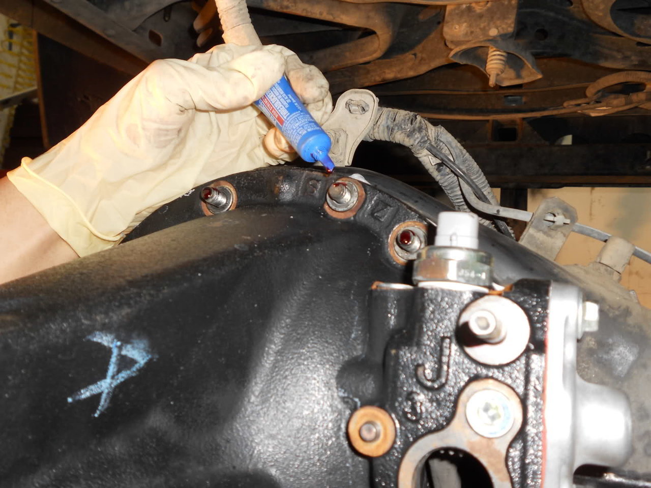

    I really like Lubelocker gaskets, but the one I ordered was for a non e-locker 8" so it didn't work. I ended up just using grey permatex.

    I asked ECGS what they use and they use the Grey Permatex. I used that and mines been fine.

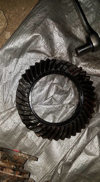

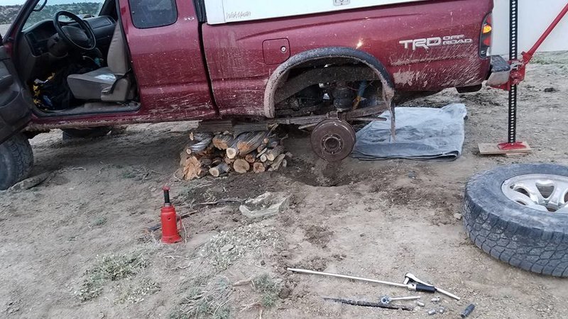

    truck jacked.jpg 3rd member.jpg ring.jpg Thank you soo much for the original post, you saved me big time! I tore out my ring and pinion gear in the middle of the San Rafeal Swell this past weekend and limped the 10 miles back to my campsite (where I had my complete tool set). I used this post to remove my rear gear and get my truck home using 4wd (front wheel drive only). I was able to free wheel home to Salt Lake City. Now I get to replace my ring and pinion and all my bearings. However, without this post I would have been getting towed back to civilization and no ordinary tow truck could have helped, I would have needed an off-road recovery rig of some sort. Again a HUGE thnx! Amazingly I had intermittent internet at my campsite and found this forum post. It took tons of effort and lots of determination, but luckily I have a wife who was more than willing to help drag logs to crib my truck and be my tool gopher (go for). Can't say thnx enough.
    Wulf, MSN88longbed, Base Camp and 6 others like this.
