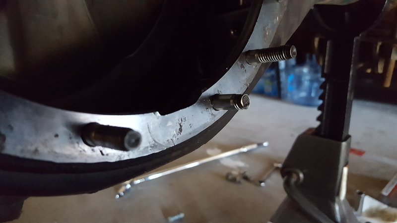

    So I moved the engagement fork as far as it can go towards the right (away from the diff) but the wheels still move in the same direction. Any input on this? yes, the engagement for is ALL the way to the right.

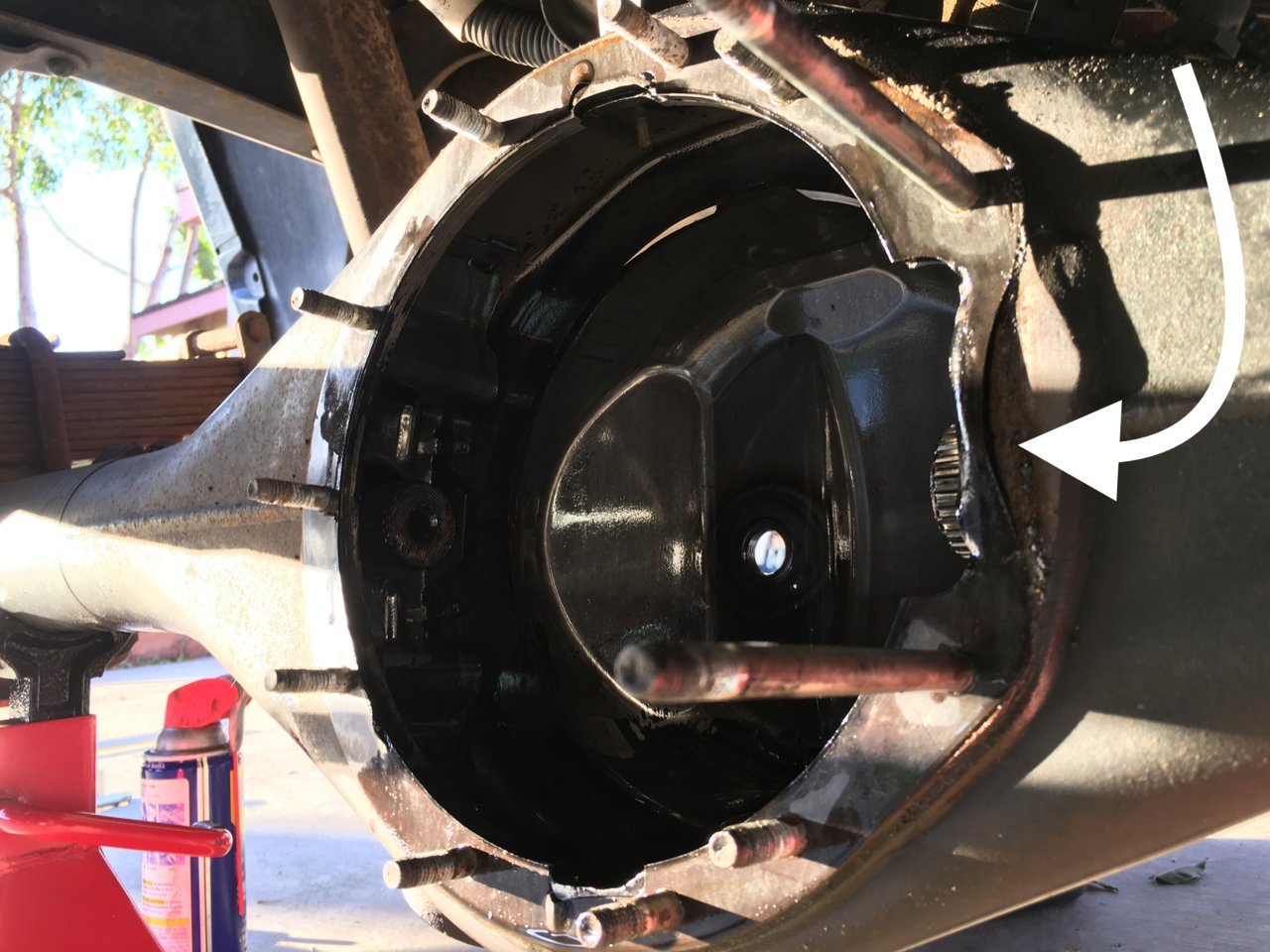

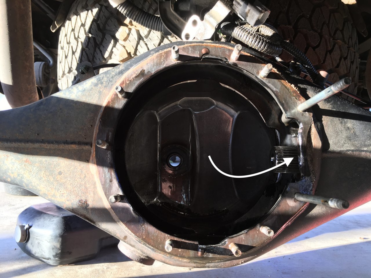

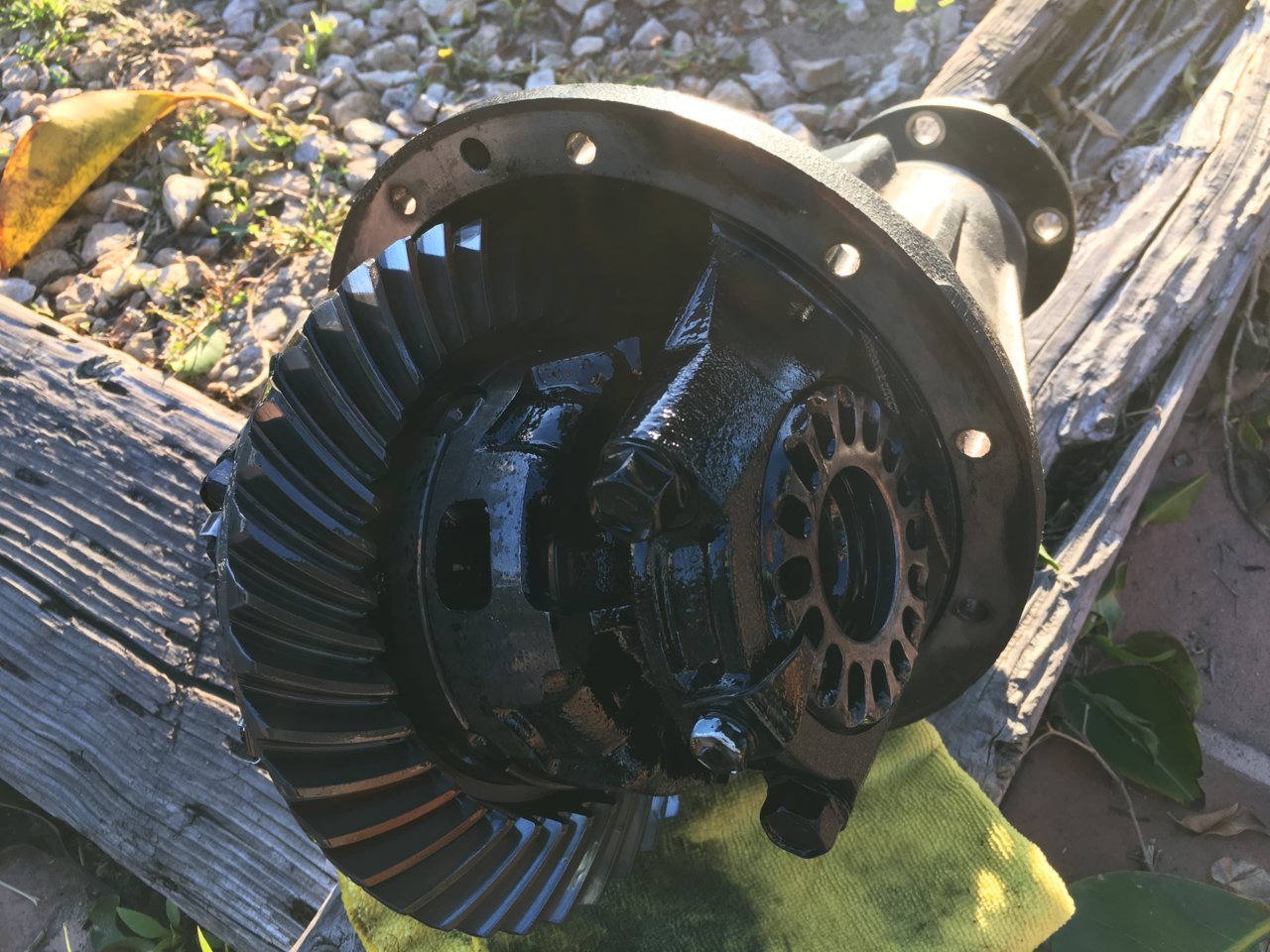

    This was an AMAZING write-up! Thank you so much for taking the time to post this. Among others, I accepted the challenge after gaining confidence from how easy you made this look. I didn't beat your hour completion time, but am still completely satisfied I didn't have to pay some else to do it. All in all - it was about 6 1/2 hours and roughly $36 in parts. My diff was leaking at the E-Locker. I'll post pics for reference.IMG_3845.jpgIMG_3844.jpgIMG_3847.jpg

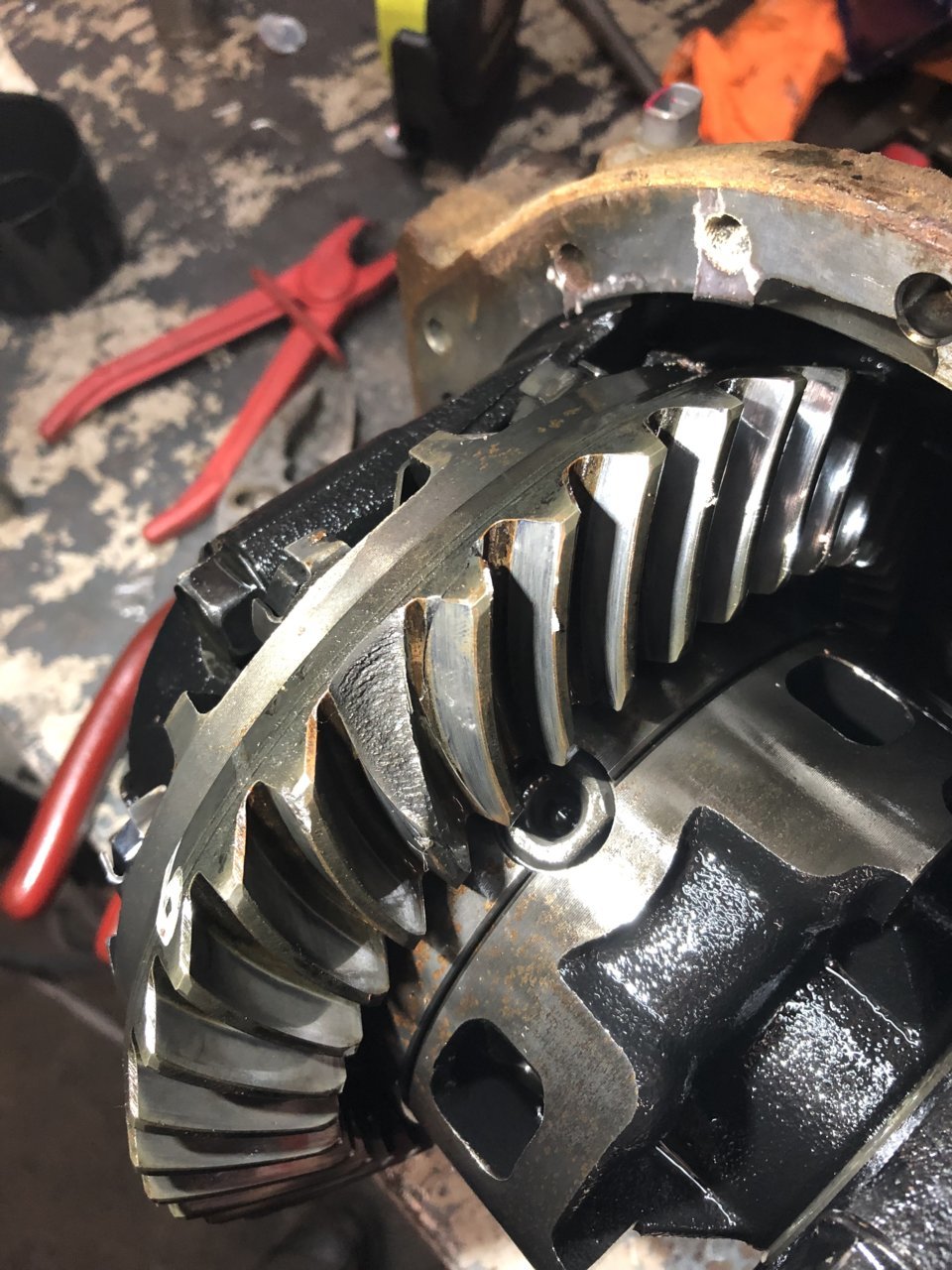

    Very good write up indeed, I just wish I didn’t have to replace my ring and pinion on the Tacoma I just bought564F0D6D-50B3-4915-96F6-714FB43F0289.jpg
