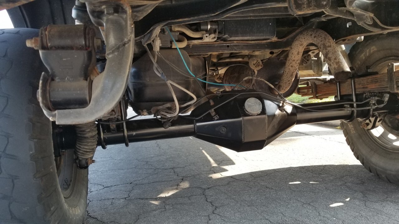

    I would like to learn more about this... Is the Marlin Crawler 8.4/arb like what you did? (and - is that a simple swap?)

    Not sure what Marlin offers. I used a stock Tacoma 8.4 housing - every Tacoma of that era had a 8.4 with the exception of the TRD 'Off-Road' models. I bought an ARB from some company - maybe 4WP. That worked fine for a long time. Last year I saw that the stock rear housing was bent so I replaced it with this:

    Whut is that? And - sorry for the stupid question, but when you did the 8.4 swap, was that a stock 8.4 3rd member and rear housing?
