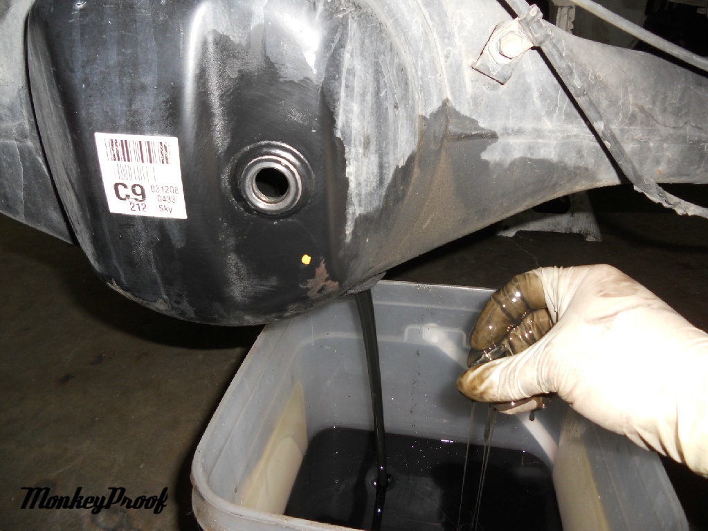

    I dont know what oil you are using but no wonder you are breaking thirds. That oil supposed to be clean :confused:

    that's motorcraft gear oil coming that you see coming out. normally i use Royal Purple, but since i was in between diff's (this is my spare that broke) i was using generic oil in the mean time because the good stuff costs some coin.
    edit: that's my catch all bucket and it as a bit of everything in it since it hasn't been emptied in a while. all considering, i think the condition of the gear oil that drained out was in good condition.

    That oil is crap, it should not look like that. (not before 60k on it) I wouldn't use that oil again and just go with sync.

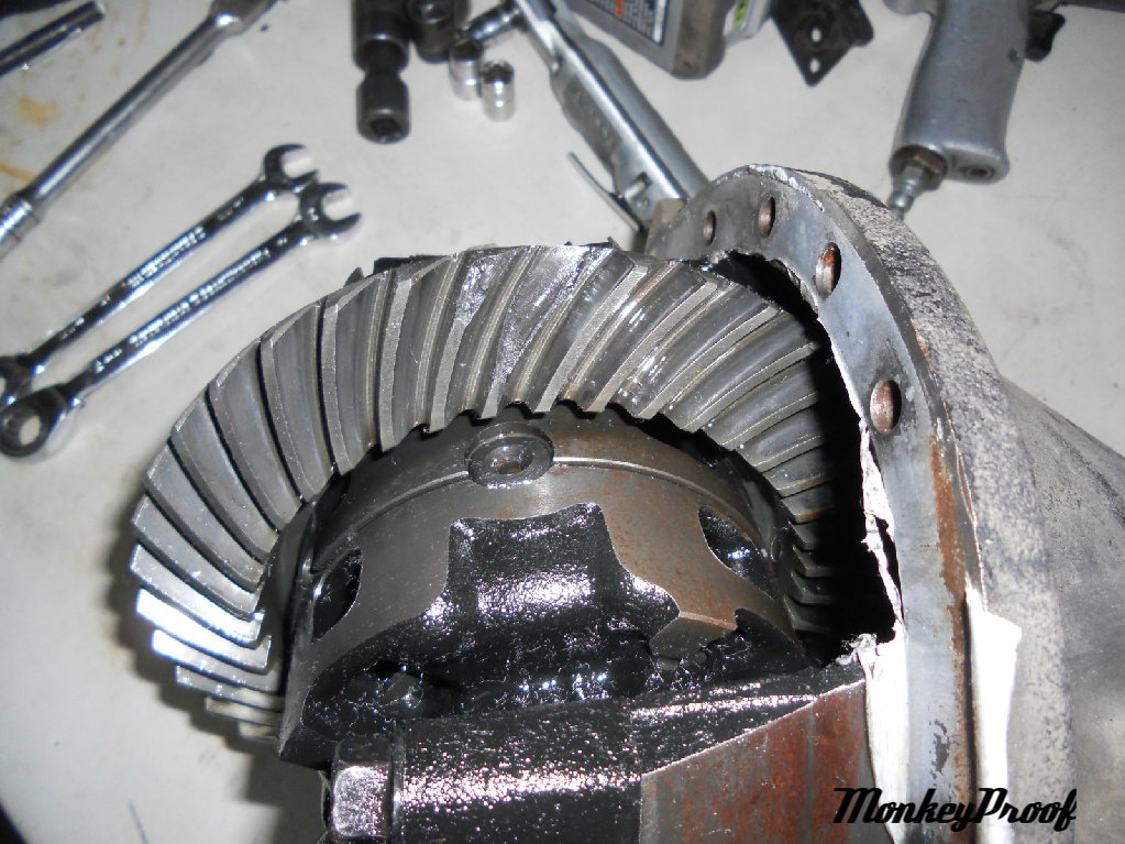

    Also dont know if it is a picture but that diff looks like it has wear marks in wrong places. It looks misaligned and that could have been contributing factor to break up. If you look on where wear marks are pinion was riding on the edge of the ring and thats where tooth had broken. So bad oil plus bad setup may have been a reason why you lost that diff so quickly. Now it could be that after last damage something in carrier is crooked so you are probably better off just getting whole another third.

    This is my original 3rd that came with my truck. I use it as my spare when the other one is broke. But now they are both broken. How you see it is how it came from the factory at Toyota. But I agree, the wear marks are questionable on the ring, the pinion is just fine
