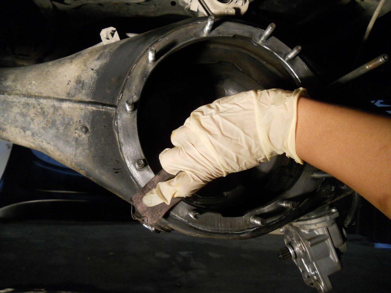

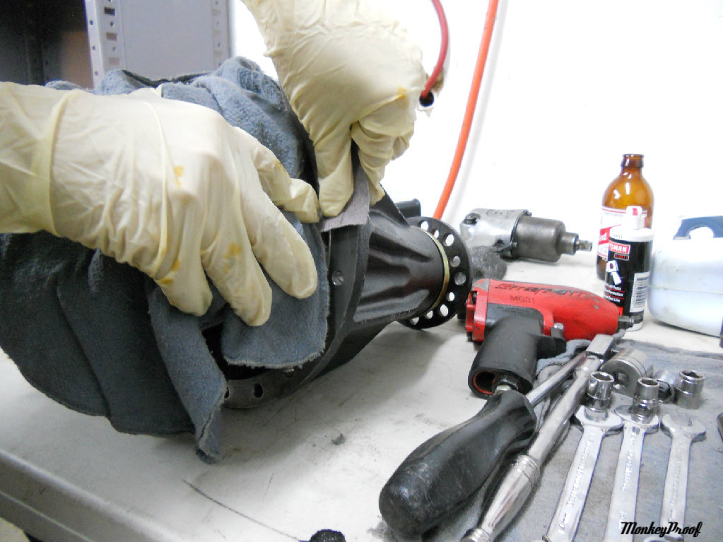

    Remove the remaining leftover gear oil that is still setting at the bottom of the housing. I like to use a can of brake clean or parts wash for this step. If you had a broken ring and pinion make sure to get all of the broken pieces out!
    160cvox_a549fba49fedaf31de8a481666e2fdd123331680.gifIt is essential to have a clean surface area to help ensure that a proper leak free seal is formed. A shiny, smooth surface that is free of any debris tells you that it's clean and ready.
    Using a ScotchBrite Pad, clean both the 3rd. member and the axle housing:

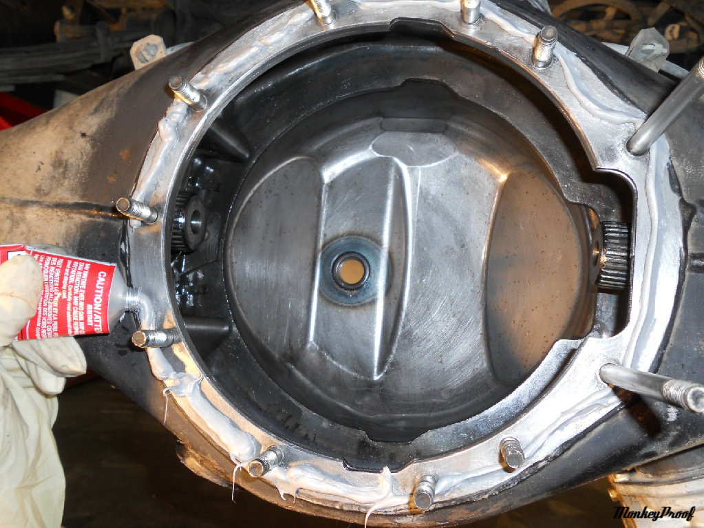

    The next step is to install or form the gasket onto the axle housing. there are two options for this step. Both options yield the same results as a proper gasket. I prefer to use option two.
    Option number one is to use the OEM paper gasket, Toyota part number 42181-60050
    Option number two is to form a gasket using Ultra Grey RTV Silicone Gasket Maker
    Form a gasket around the housing making sure the gasket bead goes on the outside of the studs:

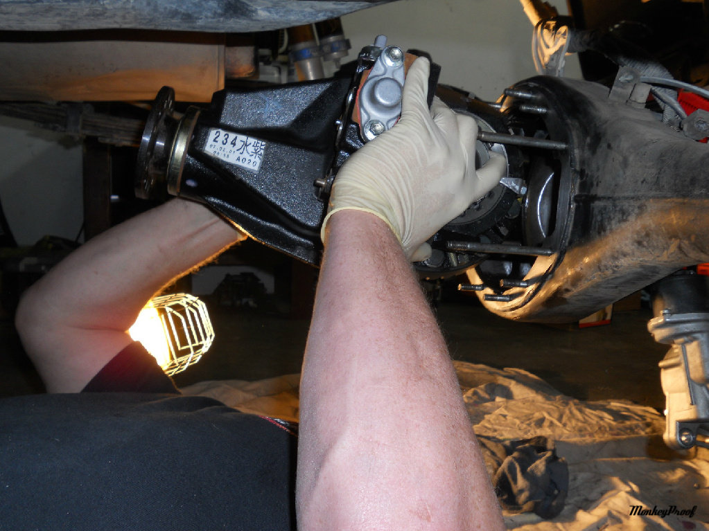

    Next step is to install the 3rd. member onto the axle housing.

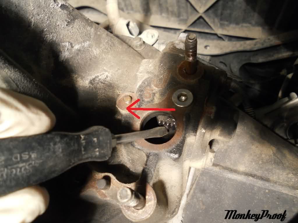

    160cvox_a549fba49fedaf31de8a481666e2fdd123331680.gifThis next step is vital. It is key to installing the 3rd member onto the housing. The 3rd. member will not fit into the housing if you do not ensure that the e-locker shift fork has been moved over towards the center of the 3rd. member. This position is "locking" the 3rd. member.
    Side Note: if you are installing a 3rd. member from ECGS the e-locker shift fork may already have been placed in the proper position prior to shipping it to you. It's still a good idea to double check anyways.
    Using a flat tip screwdriver, move the e-locker engagement fork towards the center of the 3rd member:
    Place the 3rd. member onto the housing studs, be carefull not to place too much wieght on the 2 long studs that stick out while trying to wiggle the 3rd. into place:
