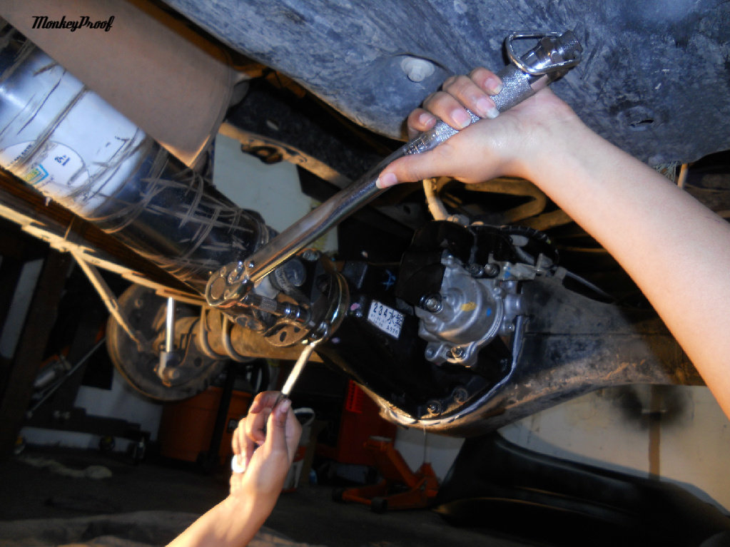

    Using a 12mm socket and torque wrench, tighten each nut in a cross pattern to 18ft. lbs/25Nm:

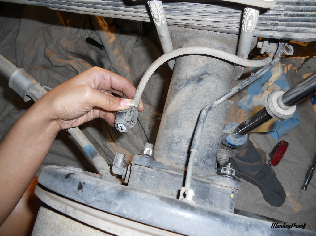

    Connect the ABS sensors on both sides, gently push into place until a "click" is heard:

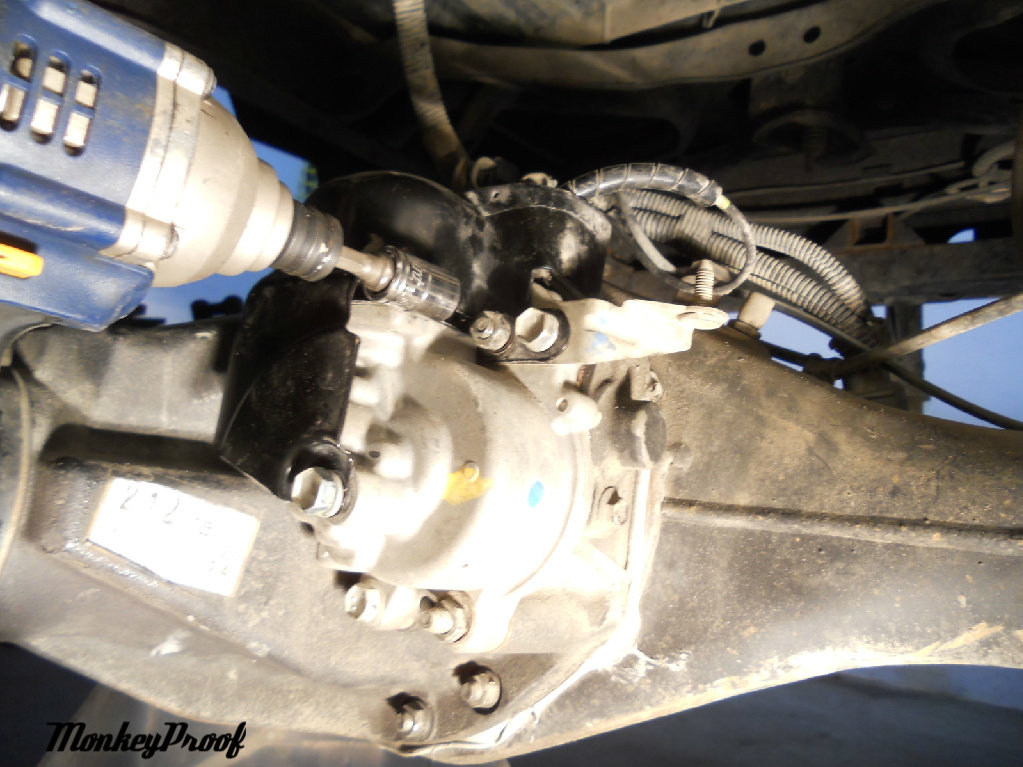

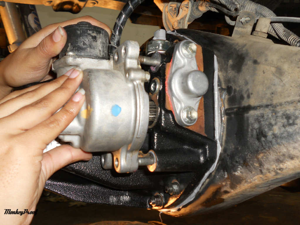

    Now it's time to install the e-locker motor assembly and it's shield. There's nothing to it as it should press right back into place with a firm push. Make sure its all clean and free of any dirt. Dab a tiny bit of grease on the rubber o-ring to ensure that it does not tear as you push the assembly into place.
    Push the e-locker motor assembly into place:
    Install the e-locker electrical connector bracket and shield. Using a 12mm socket, secure the whole assembly in place:

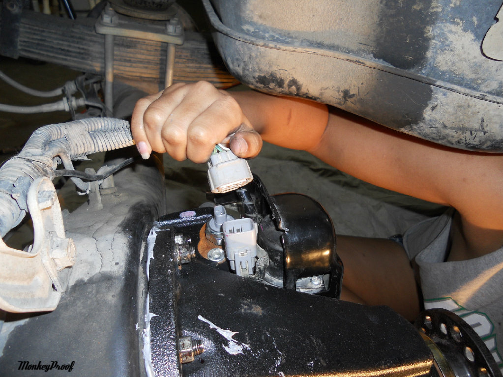

    Connect the two e-locker electrical connectors, gently push until a "click" is heard:

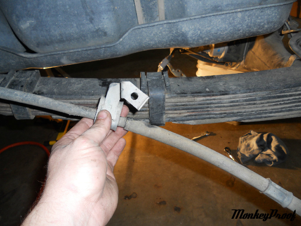

    Install the e-brake cable hanger on both sides:

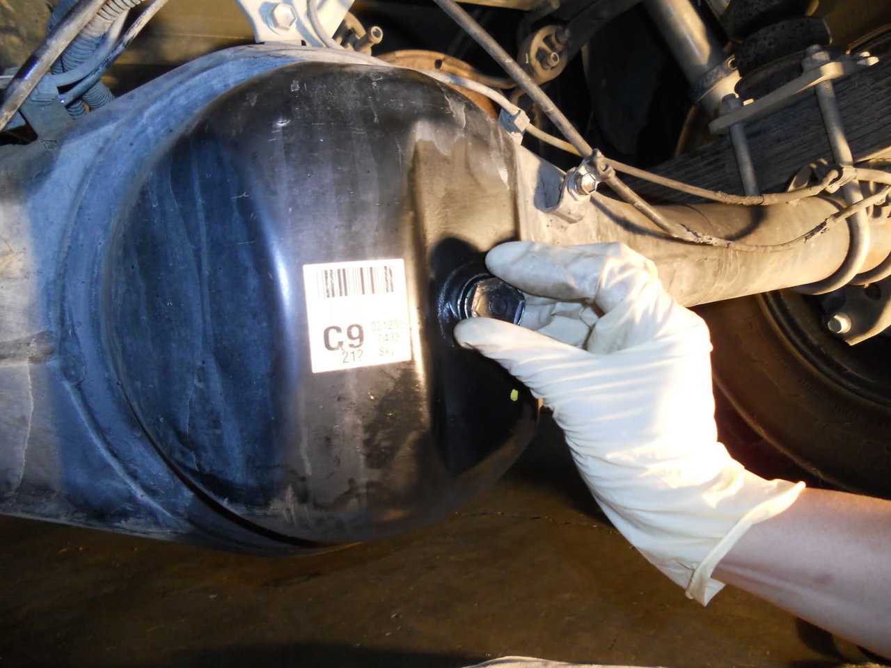

    Last and final step is to add the gear oil. Go ahead and install the drain plug and torque that sucker down to 36ft. lbs/49Nm as suggested by the factory service manual. Chase at East Coast Gear Supply recommends in using Lucus Dyno Oil 85w140 and that is what I'm going to use, but not exactly Lucus..not yet at least. There is a special procedure and break-in period for new gears. When that break-in period is over is when i will use the Lucus brand oil. During my break in period i will be using Ford Motorcraft 85w140 gear oil since i get at a nice discount through my place of employment. At around 500 miles is when i will drain the gear oil and switching over to the recommended Lucus Dyno Oil.
    160cvox_a549fba49fedaf31de8a481666e2fdd123331680.gifPlease click on this link for information for proper gear break-in procedures to help ensure a long life for your new gear set. http://www.4x4now.com/gt0999.htm
    On a level surface, add approx. 3 quarts gear oil add until you see excess oil spill from the fill hole. Install the fill plug using a 24mm socket and torque wrench to 36ft. lbs/49Nm. Wipe away any excess oil residue:
