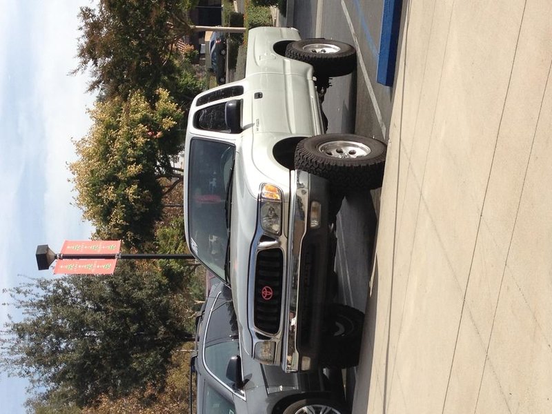

    My goodness! Great write up. Manwithoutaplan recommended this form to me because I'm in the process of switching my 3.73 to a 4.10. My dad had told me how to do thisstep by step, which was pretty close to the way you did it, but yours comes with photos!! Haha And I don't have to bleed my brakes after. Very nice work!! I'm almost confident enough to do it myself. I saw someone post about how much it was going to cost before they found this form. Even with taking off my third n bringing it to yota masters, it's going to cost me like 350 for them to press my gears. Now I know that's something I should leave to someone who has experience with that kind of thing, but it is possible for myself to do it? Just curious

    Nice truck ;)

    Awww Thankyou ^_^ she still has some things I want to do, but she's coming along. I like yours too, hard to make a taco not look good :p
